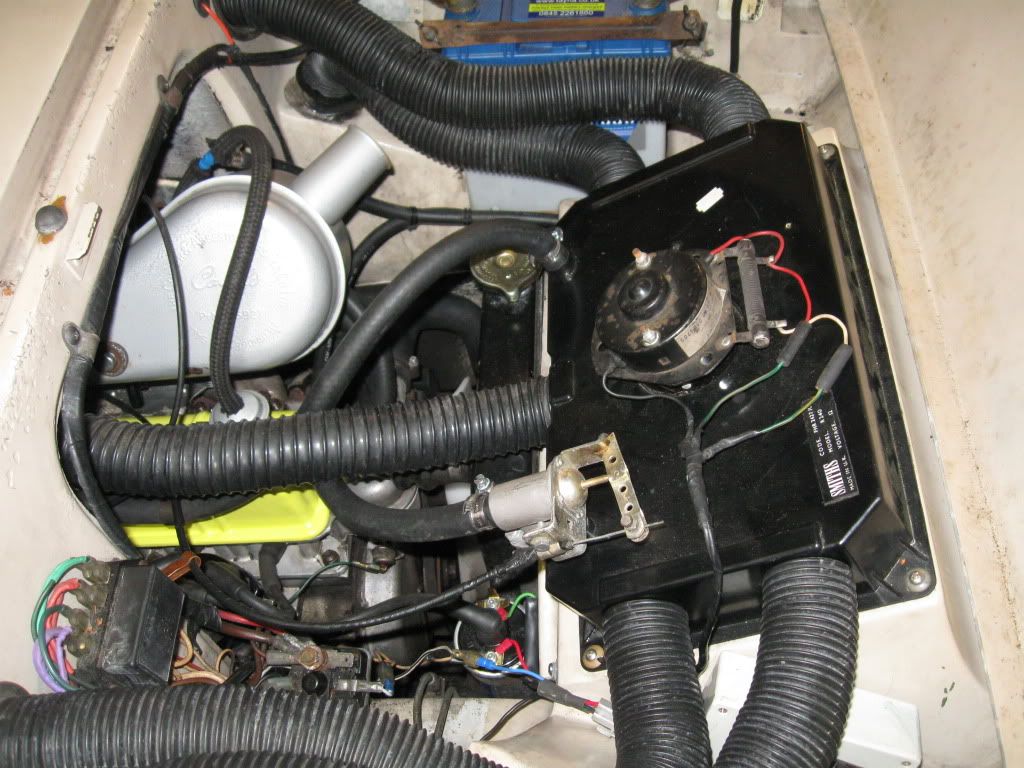

Do you have a pic of the the amplifier?
PostSubject: Re: 1985 Lap Rialto 2 (hopefully a more concise version of it) - this may take me time to update it.   Wed Oct 31, 2012 10:53 pm
15th August 2012

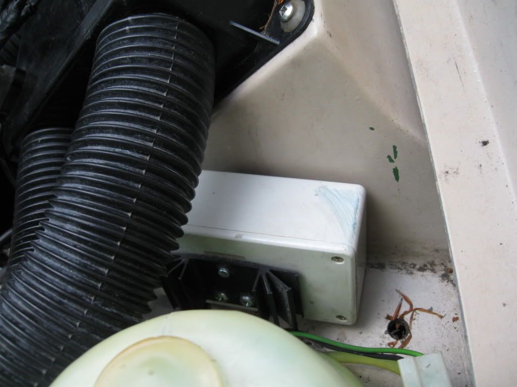

This is where I have installed the Velleman ignition amplifier that I bought from Madblokey. I used industrial velcro to make sure that it does not move.
The kit its self requires assembly and you will also need to get a suitable waterproof box for it:-
This is how the Velleman kit is supplied (the pic is what it looks like after it has been assembled):-
and the link to that kit is on here http://www.maplin.co.uk/ignition-amplifier-kit-3162 . An ABS box, AquaStop, suitable connectors, wire and glue-lined heatshrink (t0 make up a tough outer cable jacket) can be bought separately.

I think that's a really good idea how did you find the right size box enclosure?
str8lolly
Maplins sell the boxes as well.

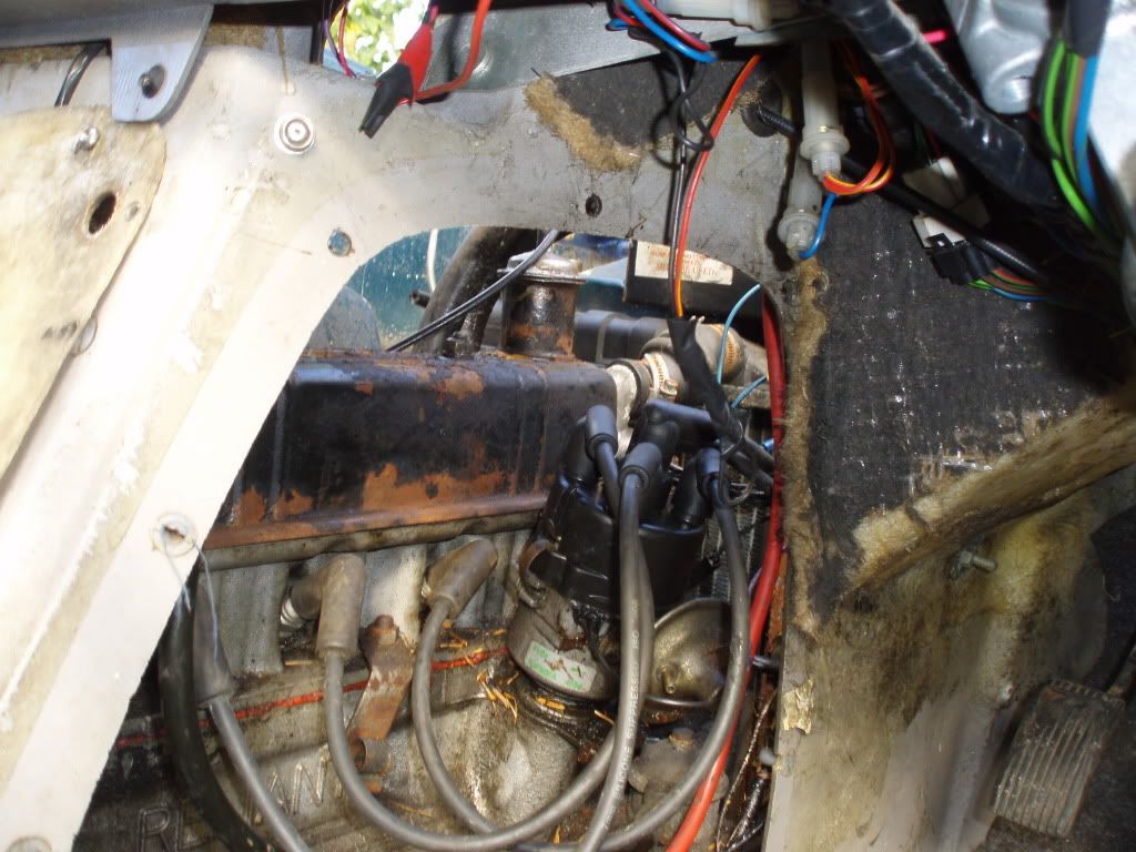

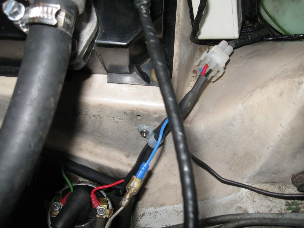

Velleman ignition amplifier's wiring tidied up today
I have now got round to tidying up the ignition amplifier's wiring to make the car safer. I drilled out one of the holes next to the ignition coil (it originally had a mercury tilt switch fitted to it) and fitted a no.8 plastic snap-in nut into it:-
Wiring secured by a plastic P-clip with a no.8 stainless self tapper and made to length. At least there's no danger of the ignition amplifier's wiring loom shorting out on the starter motor's solenoid.
At last ! My Rialto 2's engine bay is now complete (for the first time since the National Rally):-
I also ran it in the garage today. There's still a very small amount of hunting present (barely noticeable) but I am now thinking it's down to the 2 1/2 month old petrol that's still in it.

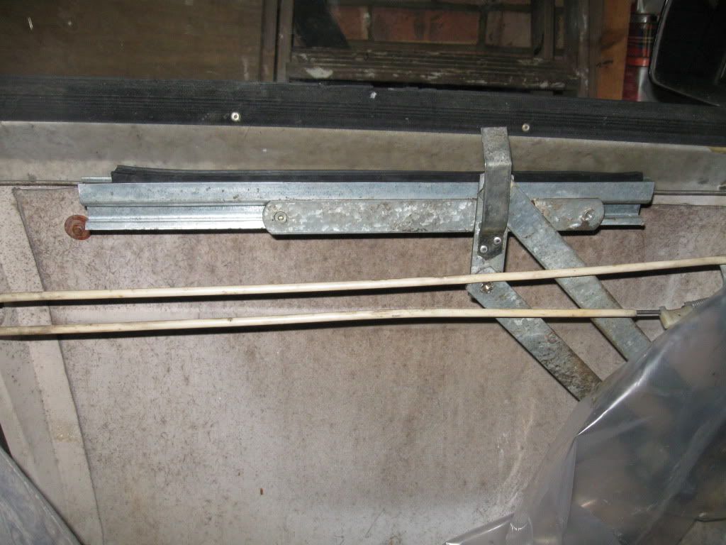

I haven't managed to take it out for a blast yet (I took my 1973 VW 1300 Beetle out for a drive yesterday). Having said that, I did replace the passenger's side window lifter as the passenger's side window did not want to stay in the old window lifter and I did not want lots of broken glass everywhere.
NOS window lifter and new window lifter rubber fitted (from sparesman, there's no more NOS ones left as far as I know):-

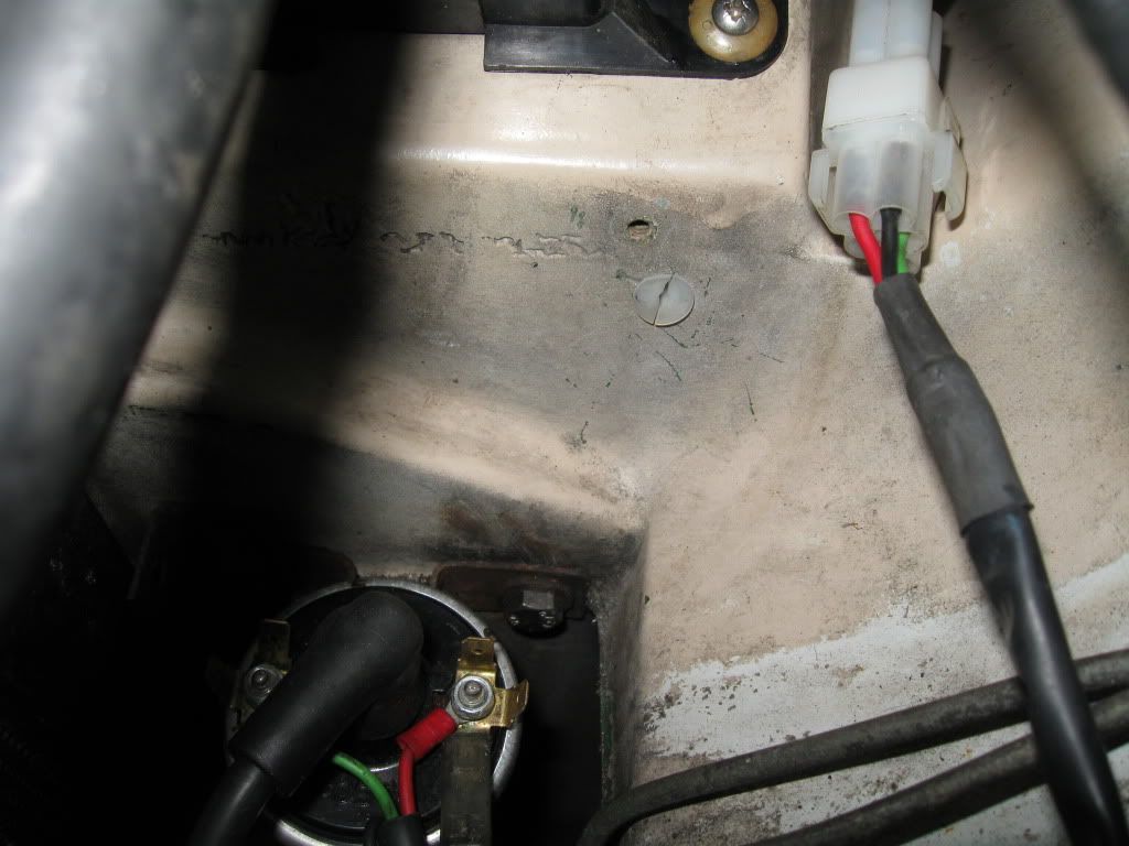

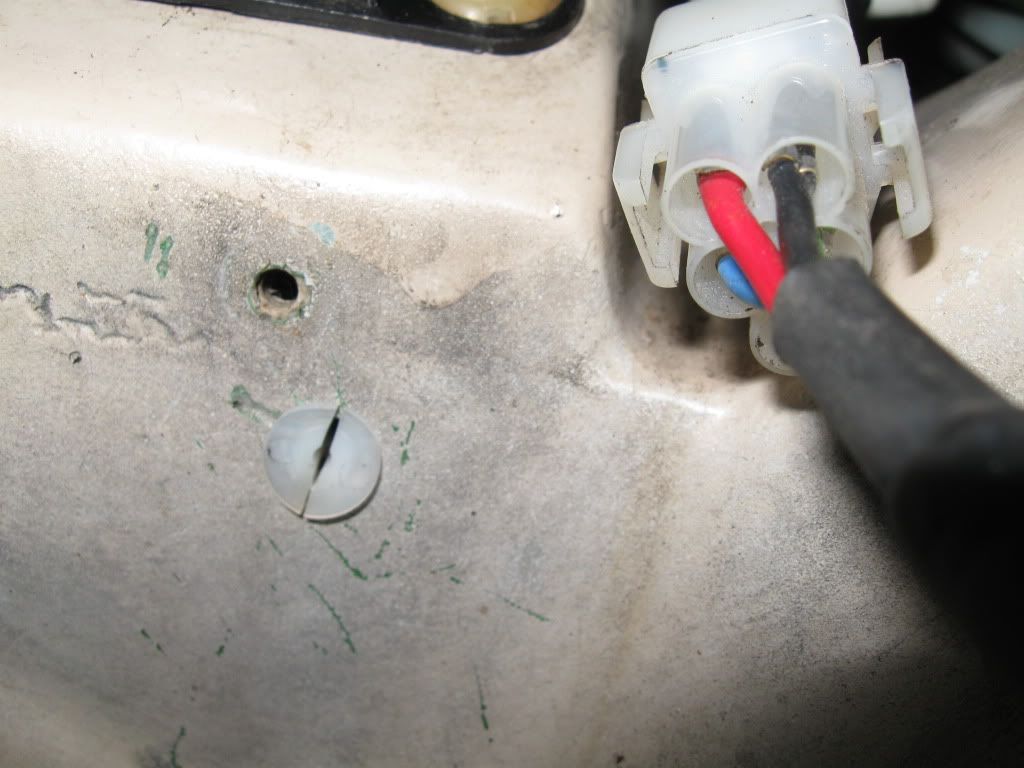

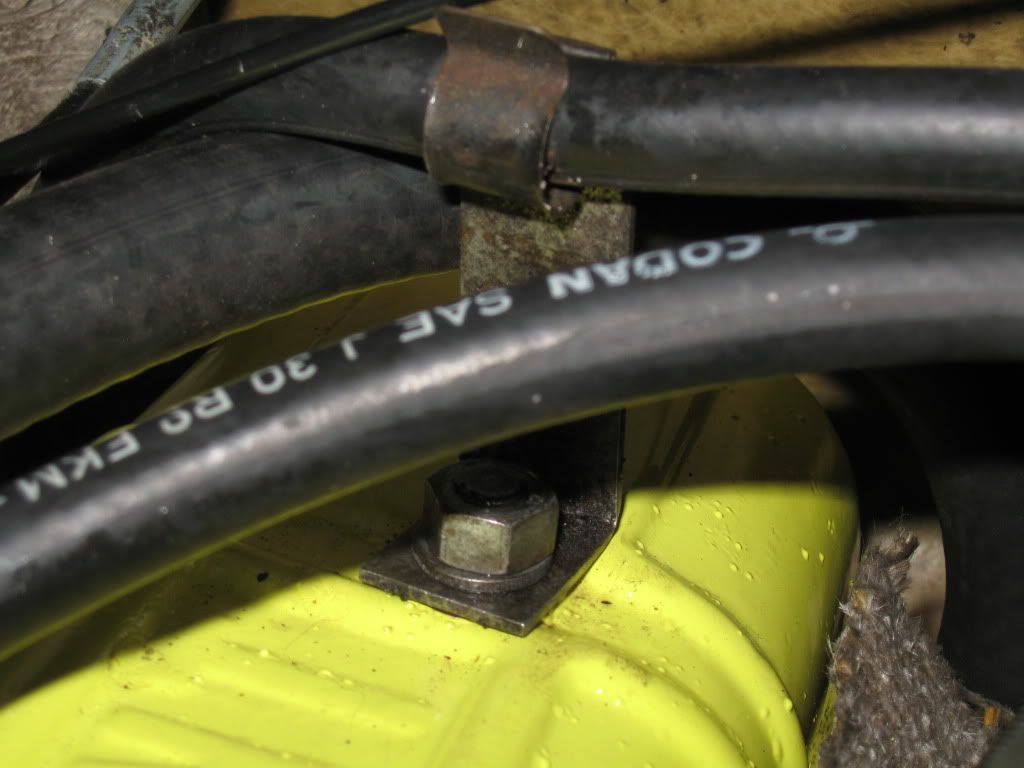

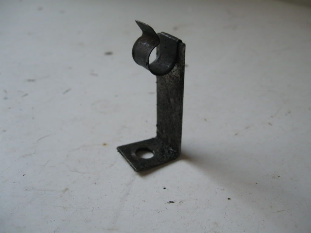

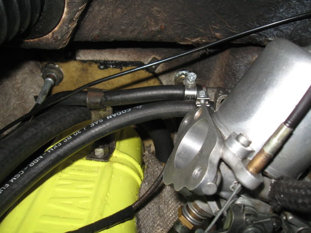

I found a fuel hose support bracket (that I didn't realise until yesterday was supposed to be fitted to the rocker cover) in the garage today and fitted it to my Rialto 2:-
I have also managed to get a 7 pin version of the 5 pin wiper motor connector (from Auto Sparks) and I will be fitting it to the spare Velleman ignition amplifier once I have built it. Thankfully, the 7 pin connector fits the 5 pin connector on the Velleman ignition amplifier's loom that I have already fitted to my Rialto 2.
PostSubject: Re: 1985 Lap Rialto 2 (hopefully a more concise version of it) - this may take me time to update it.   Wed Oct 31, 2012 11:25 pm
21st October 2012
Fifer then let me know that I needed two brackets for my Rialto 2's fuel hose....

Fifer wrote:
Phil , as far as I am aware that bracket is for the overflow hose and the petrol hose is clipped to the side of the cylinder head as per this old photo on the poxy robin just after I first got it and was checking all the faults

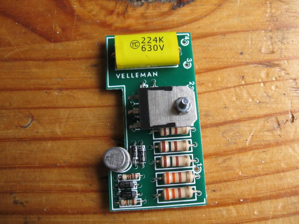

Anyway, whilst I was waiting for the brackets to arrive, I decided to build the spare Velleman ignition amplifier.....

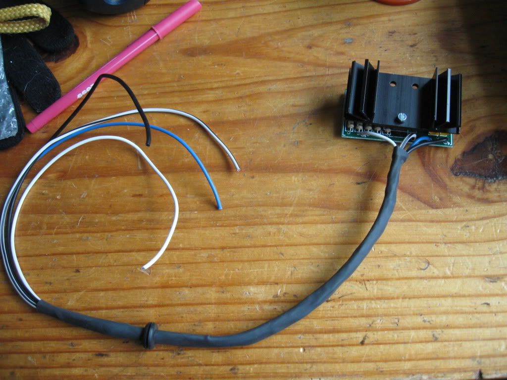

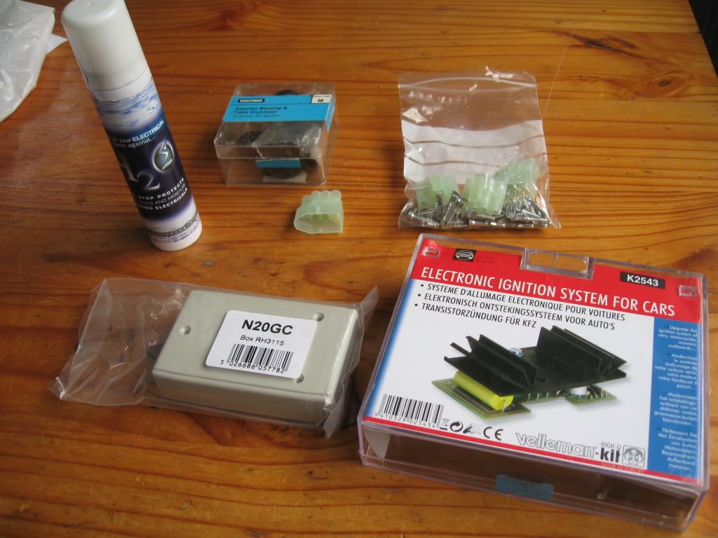

I decided to start building my Rialto 2's spare Velleman ignition amplifier (so that I can do a very quick swap in case either of them fails) after my red VW 1600i Beetle's windscreen shattered. Anyway here are some pics of what I did:-
Velleman kit in it's box, Aquastop (the small tin) for protecting the Velleman PCB against moisture and a 7 pin version of the 5 pin wiper connector (it will fit the 5 pin wiper connector currently fitted to my Rialto 2's Velleman ignition amplifier). I could not use the enclosure as it's too small for the Velleman ignition amplifier's PCB:-
Velleman ignition amplifier's PCB assembled:-

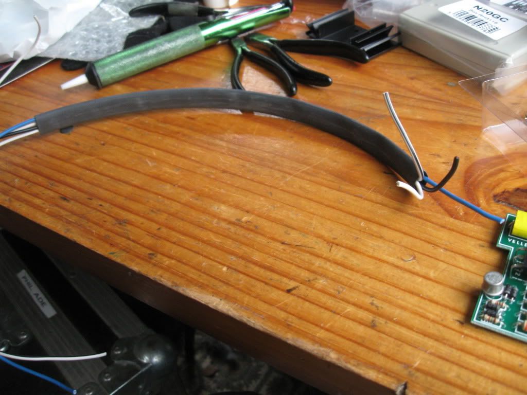

Making up the wiring loom for the ignition amplifier with four wires and glue-lined heatshrink:-
Wiring loom soldered to the ignition amplifier's PCB:-
I hope to get a suitable enclosure from Maplin (stock code N73BQ) in Bromley (the Orpington store does not have any) tomorrow so that I can test the spare ignition amplifier tomorrow.
I then measured up the plastic enclosure on the Velleman ignition amplifier that I bought from Madblokey and realised that it's Maplin N75BQ, so I ordered one from Maplin's eBay shop and decided to have a look at my Rialto 2's existing Velleman ignition amplifier....
