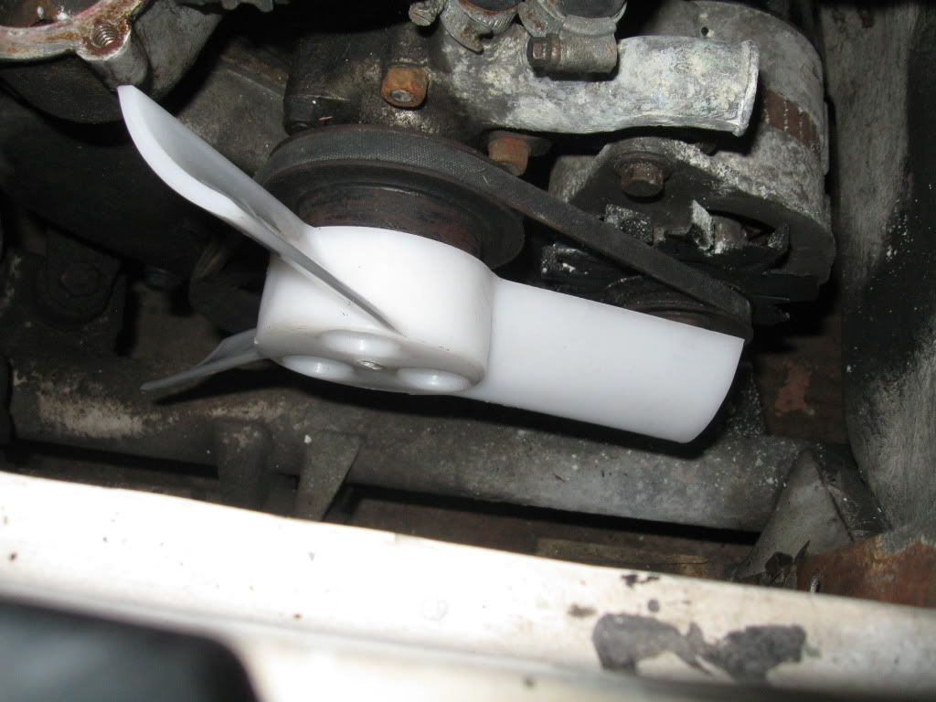

Broken down - overheated ;(

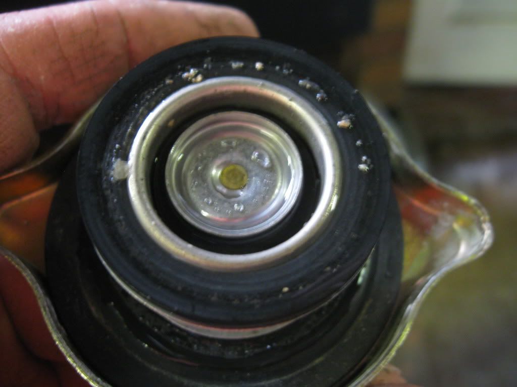

Just to let you all know that my Rialto 2 estate decided to overheat without warning whilst stationary on the M25 It decided to stall and as soon as I heard slight knocking under load, I pulled over to the hard shoulder and stopped the engine
I'm very unhappy to say the least. ;(
RAC just turned up and insisted that I drove the car a short distance, thankfully no knocking. (1 hour later) but they agreed to sending out a recovery truck. I just hope that there was no engine damage. Another 1 to 2 hour wait on the hard shoulder of the m25

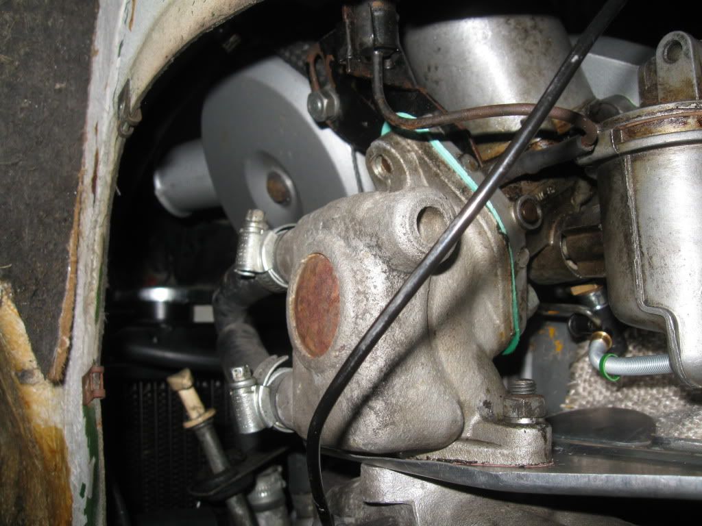

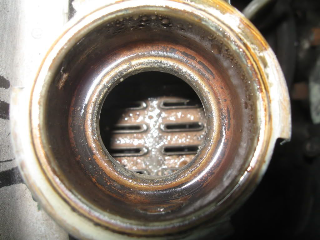

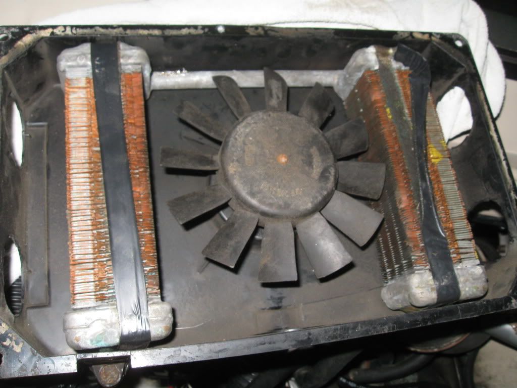

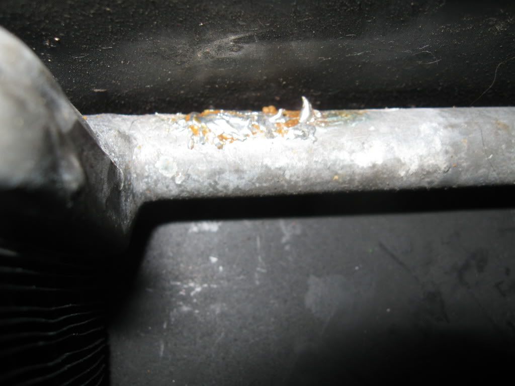

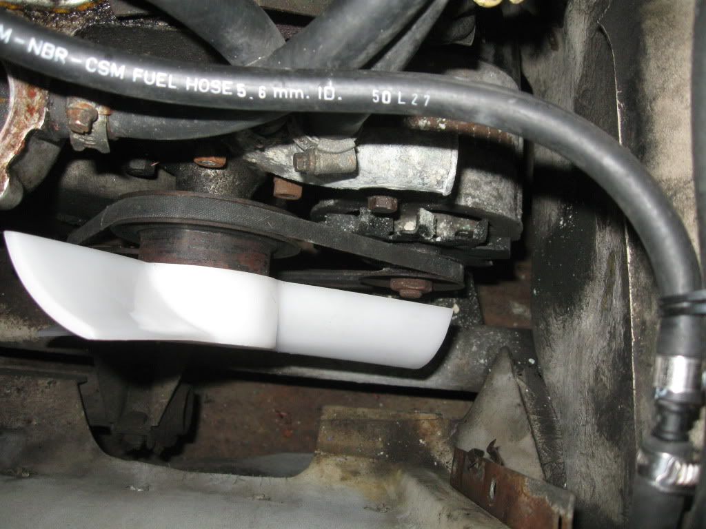

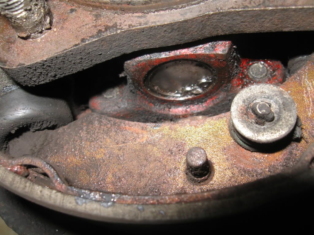

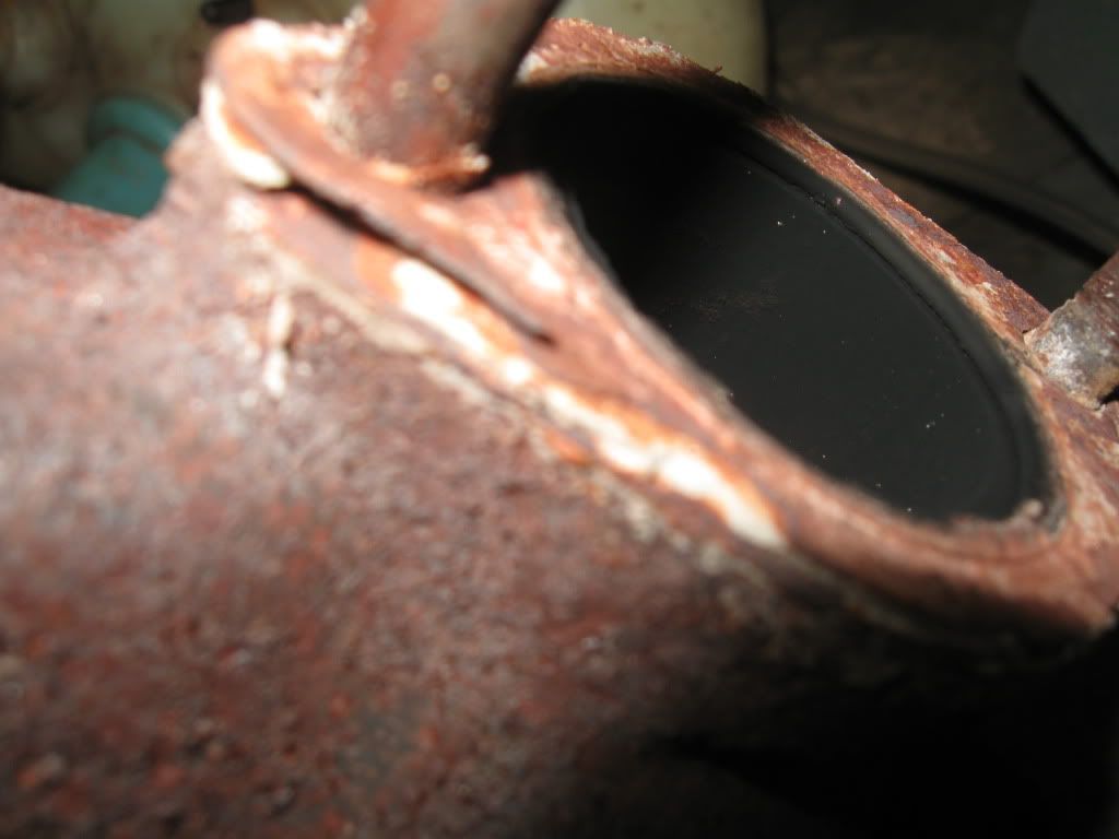

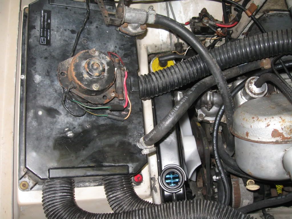

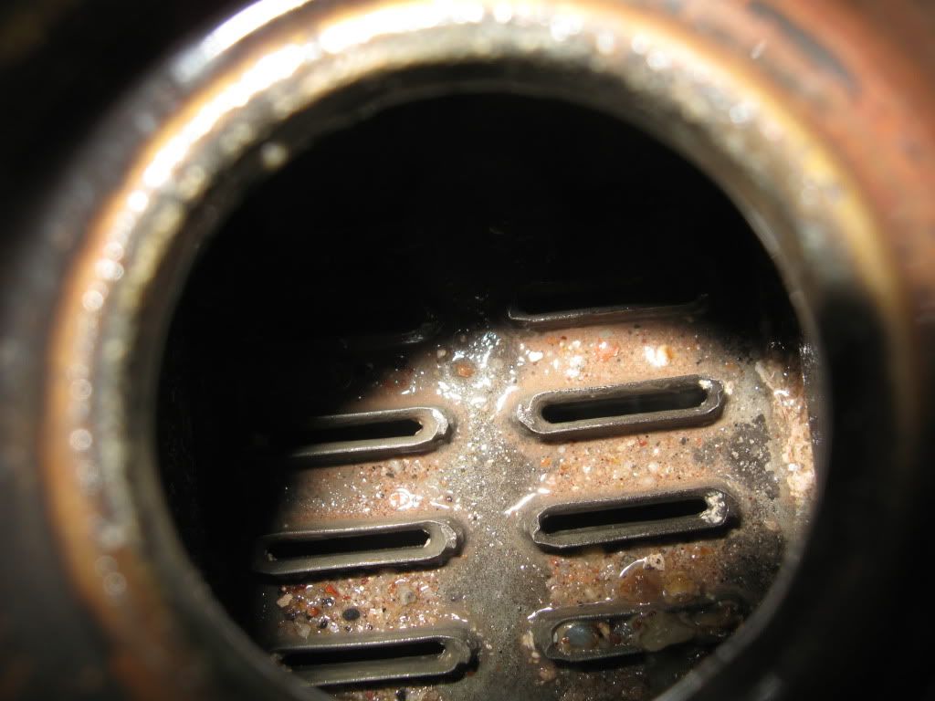

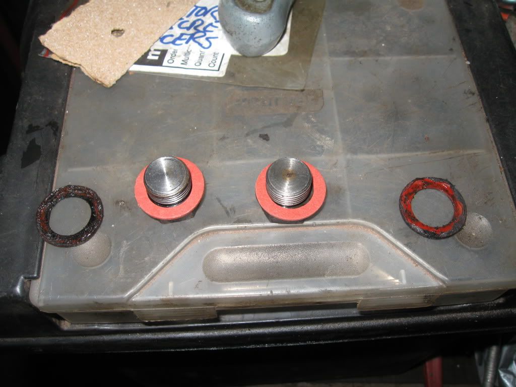

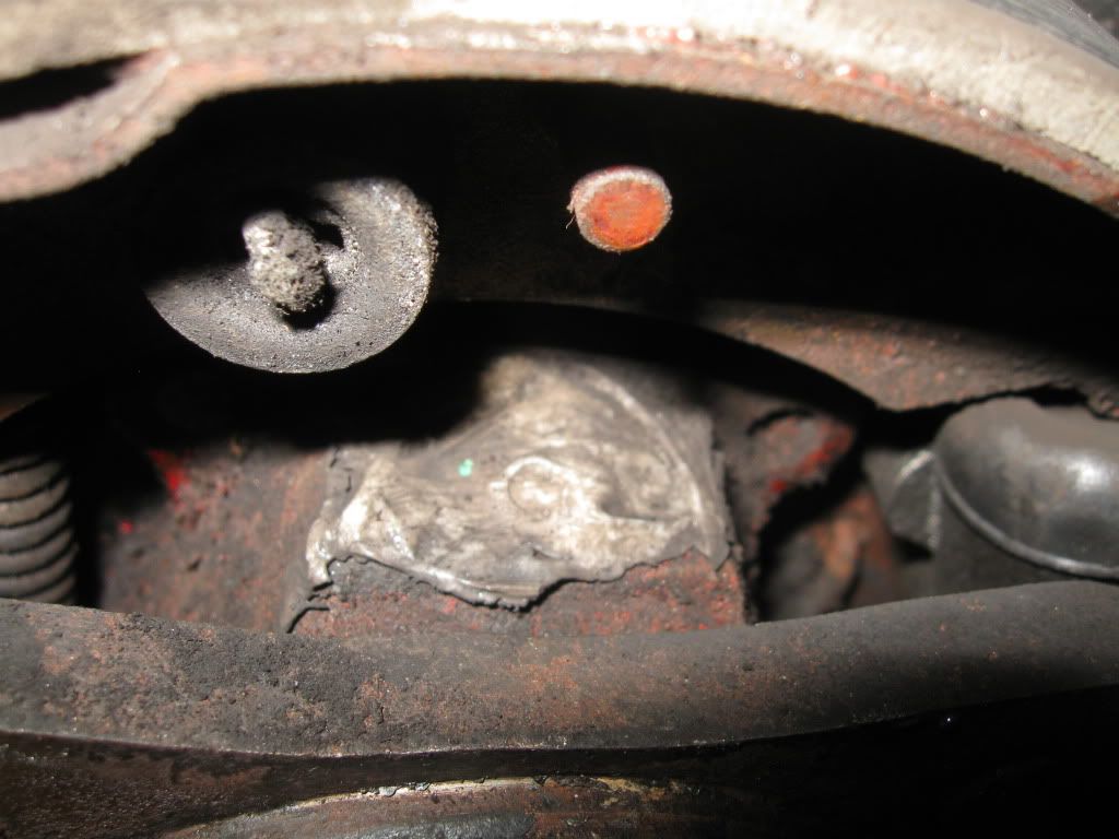

| 16th July 2011A few updates on my Rialto 2 Estate since it broke down...The day my Rialto 2 Estate broke down The first thing I did was to have a look at the general condition of the engine/cooling system its self. Coolant drain plug (this looks like it hasn't been off for a while): When I flushed out the cylinder block (in both directions), a lot of limescale and some rust came out of the coolant drain hole. Radiator cap (with some deposits on it): Inside the old radiator's filler (looks like it was filled up with water from a river or stream at some point) Water pump to radiator outlet (I think this was due to the old radiator's bottom hose being rather old): Thankfully the water pump its self appeared to be clear. Heat exchanger (one of it's internal pipes appears to have been soldered at some point, but it looks like that it's not leaking): | |
Posts : 475 Join date : 2011-08-19 Location : Kent / South East London

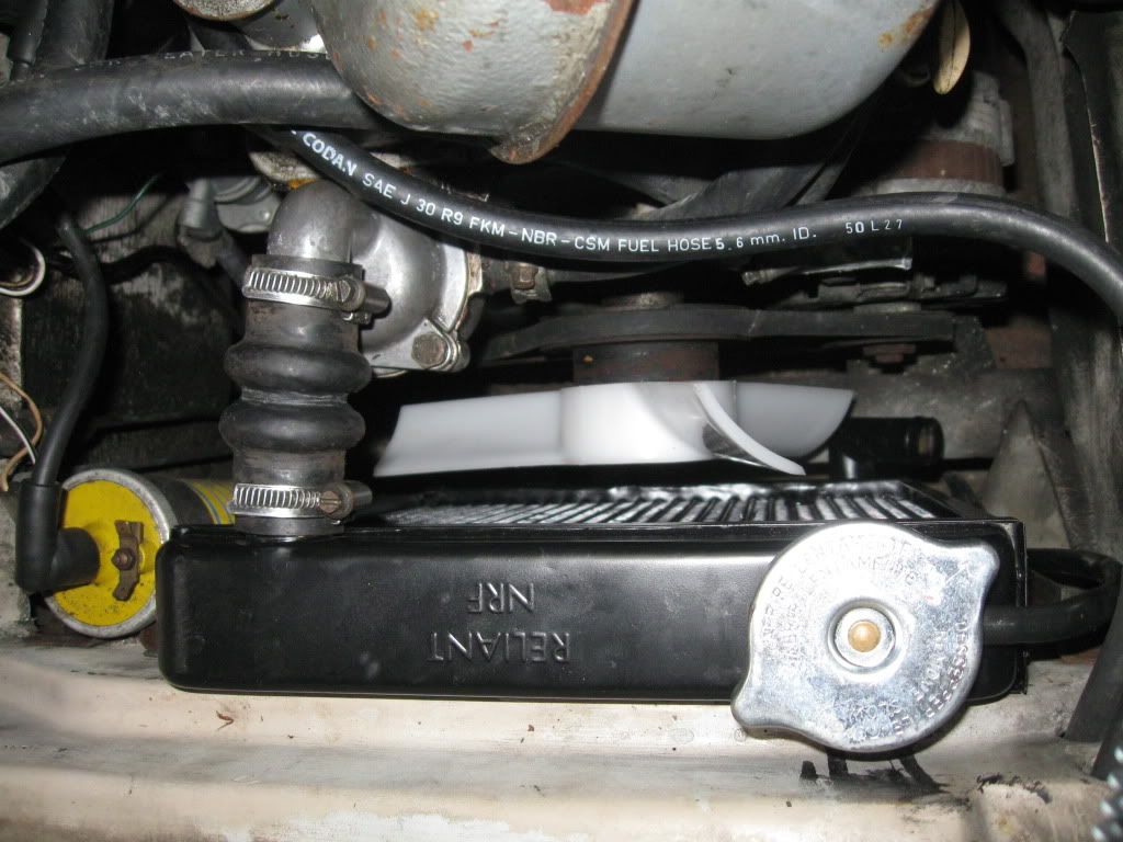

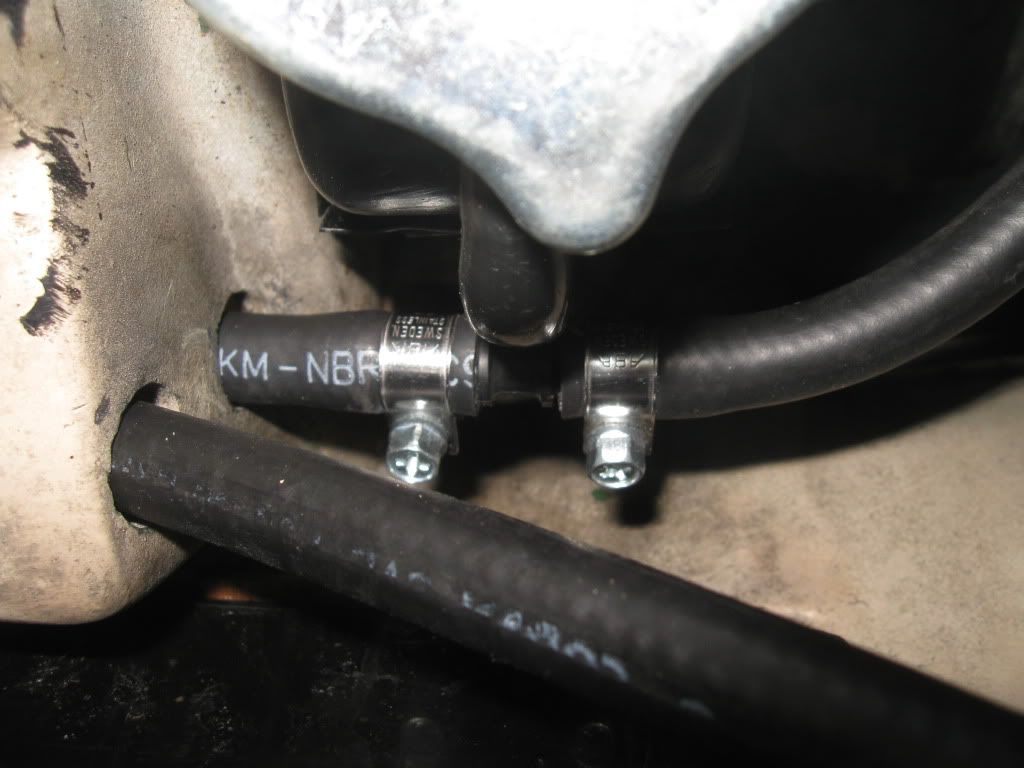

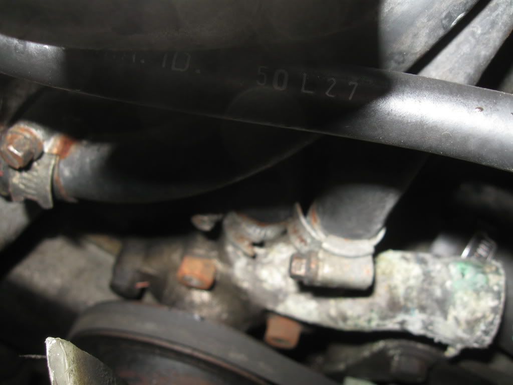

| 16th July 2011Recored radiator and new radiator cap (from chgperformance) fitted: Heat exchanger refitted and cooling system filled with 50% blue glycol (antifreeze) and 50% distilled water. NOS top radiator hose and new bottom radiator hose fitted: The old lower radiator hose was bowed at the top end of it (eg. not sealing properly) and the top radiator hose appeared to be bodged with more of that green gasket goo muck. The radiator hose clips were also replaced with Mikalor stainless 25mm-40mm hose clips. | |

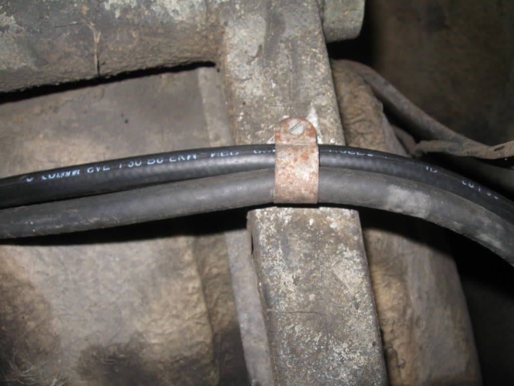

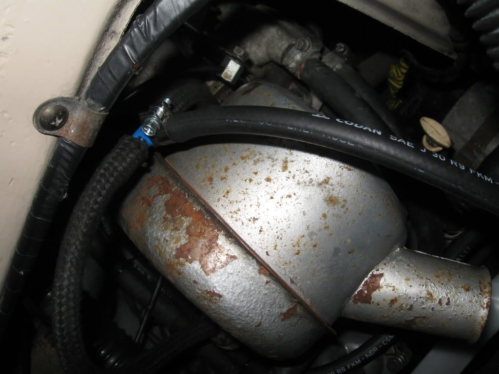

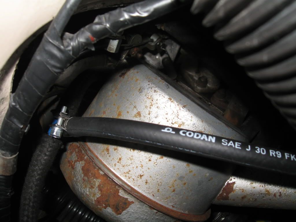

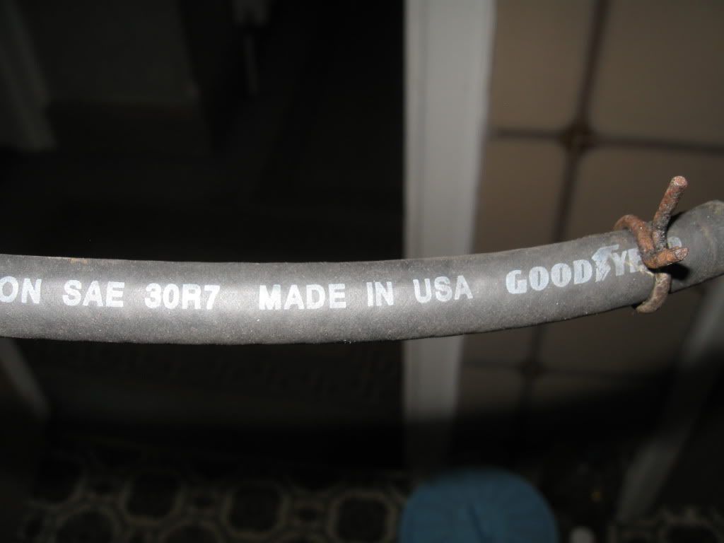

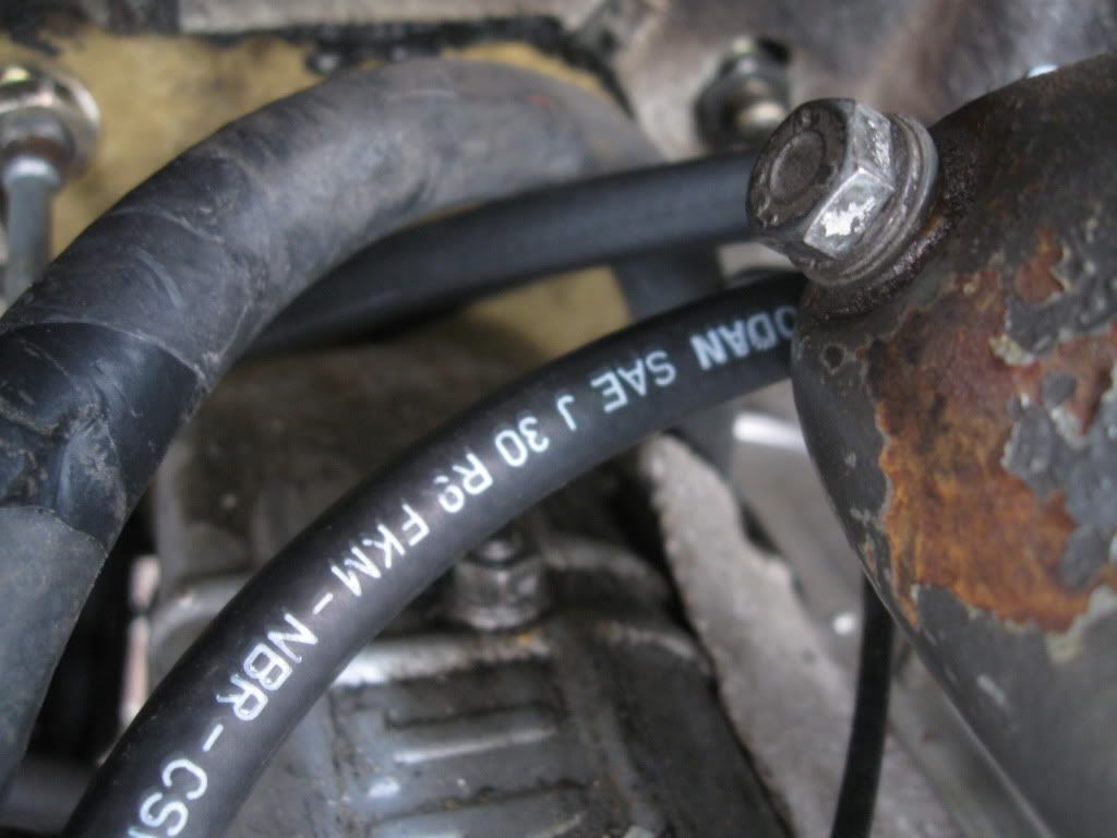

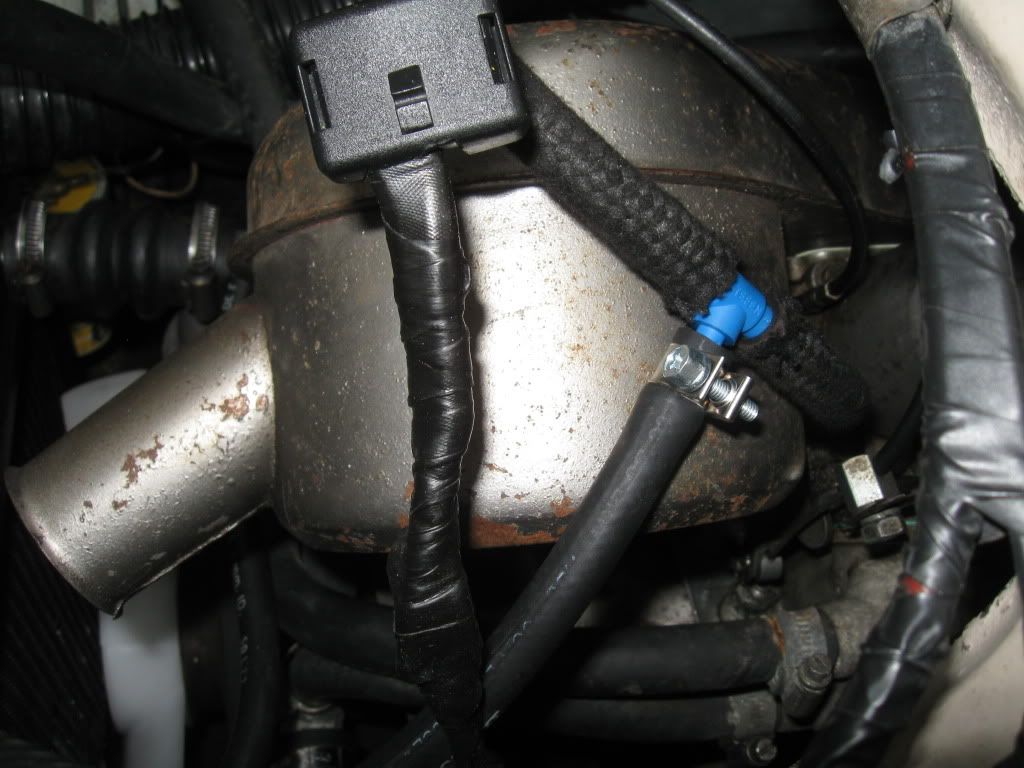

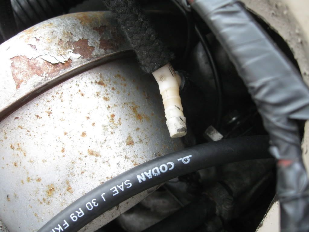

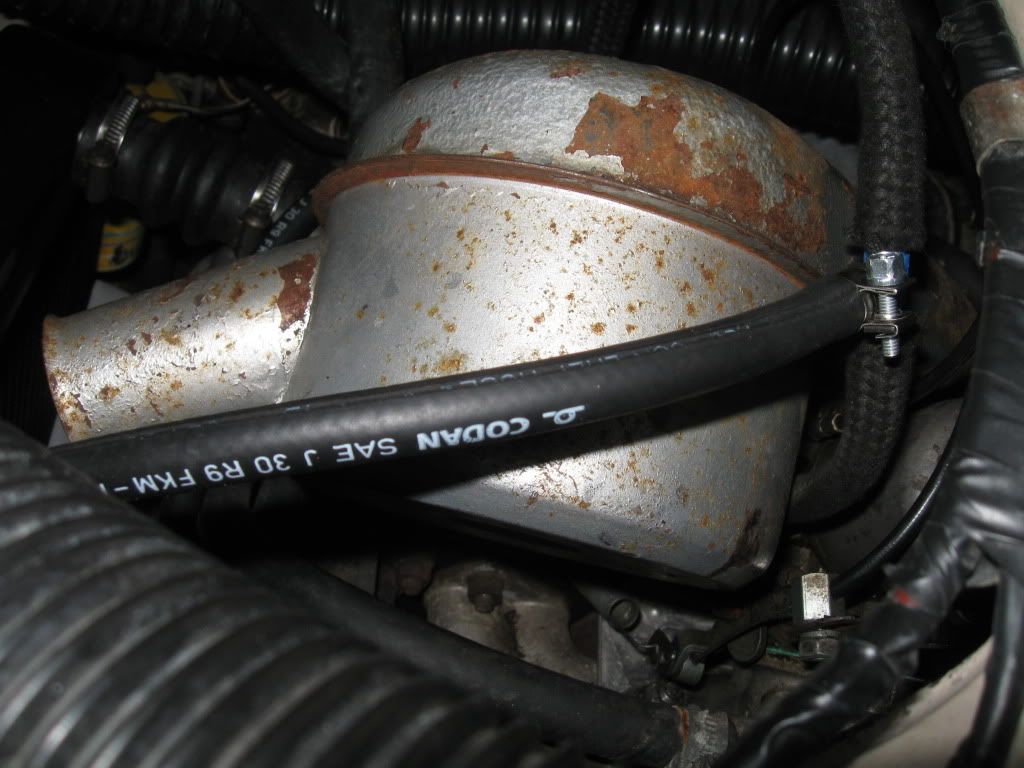

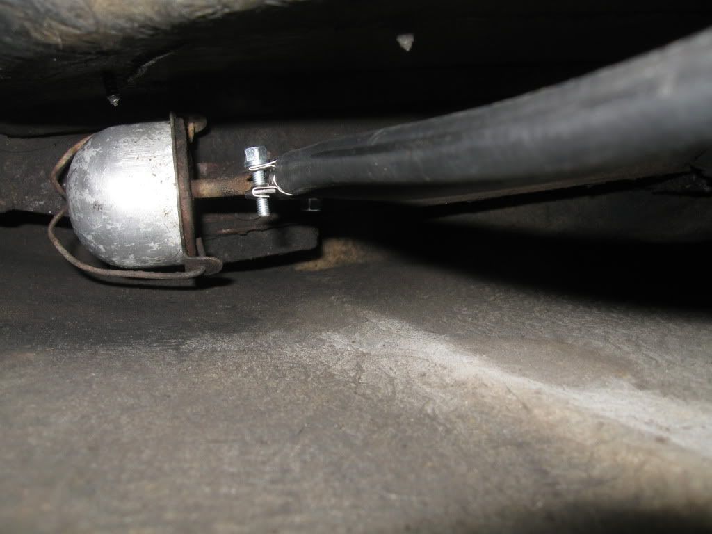

| 23rd July 2011Some more work I did on my Rialto 2 estate during the past couple of days...Replaced overflow hose to T-piece. The "T-piece" was a 5/16" Y piece, where the old SAE J30 R7 1/4" fuel hose was rammed onto it Overflow fuel hoses secured by a hoses clamp and a wood screw. I plan to find a better means of securing those fuel hoses at some point. Old SAE J30 R7 fuel hose (along with it's useless fuel hose clips) fit for the bin. New Codan 5.6mm SAE J30 R9 overflow fuel hoses connected to the correct 8mm to 6mm T-piece. New overflow fuel hoses (different views). Fuel pump fuel hoses replaced. Front radiator grille sticker replaced. Jobs still to do: - Replace all rear fuel hoses (they don't feel great, but they are not perished nor leaking) - Adjust front wheel bearing (I seem to have lost a couple of front wheel bearing split pins I had) | |

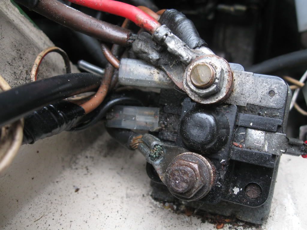

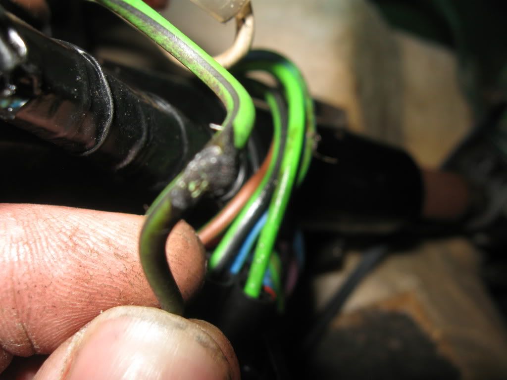

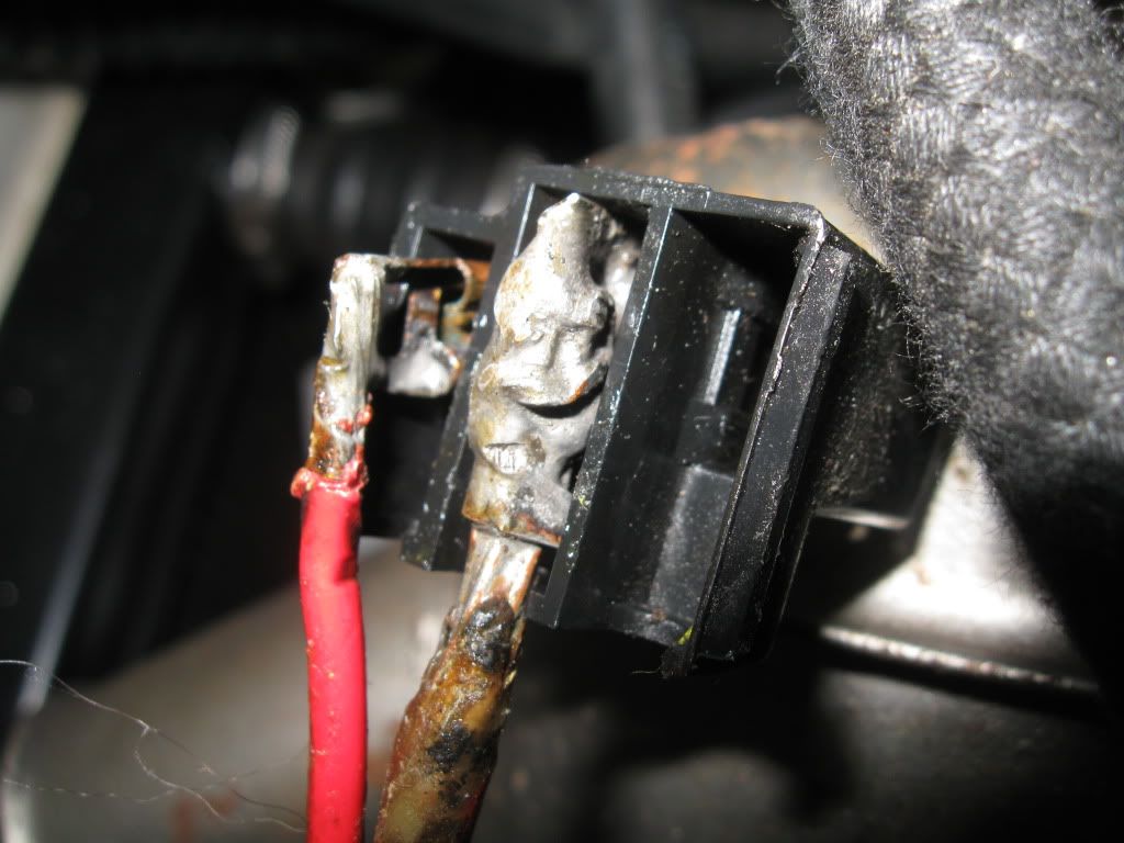

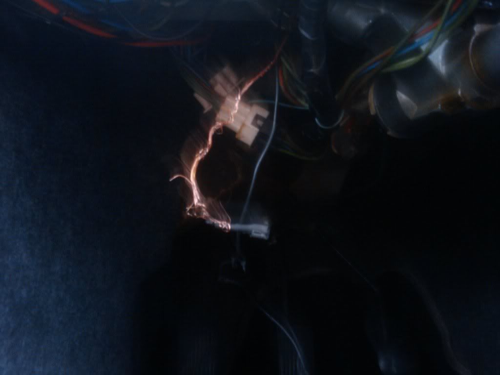

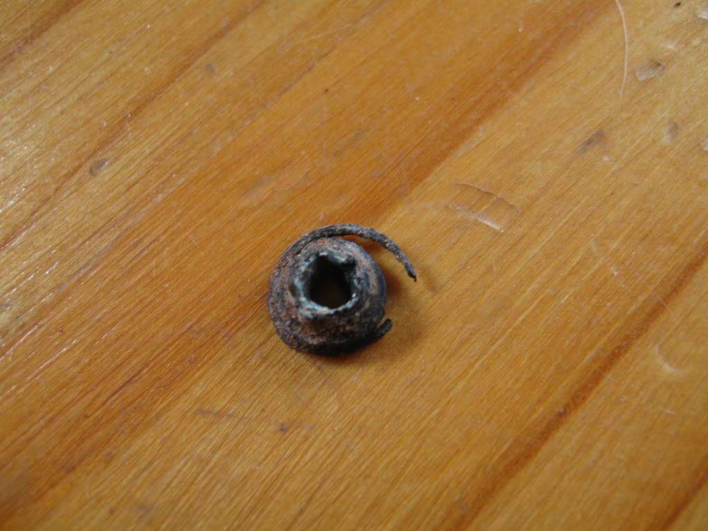

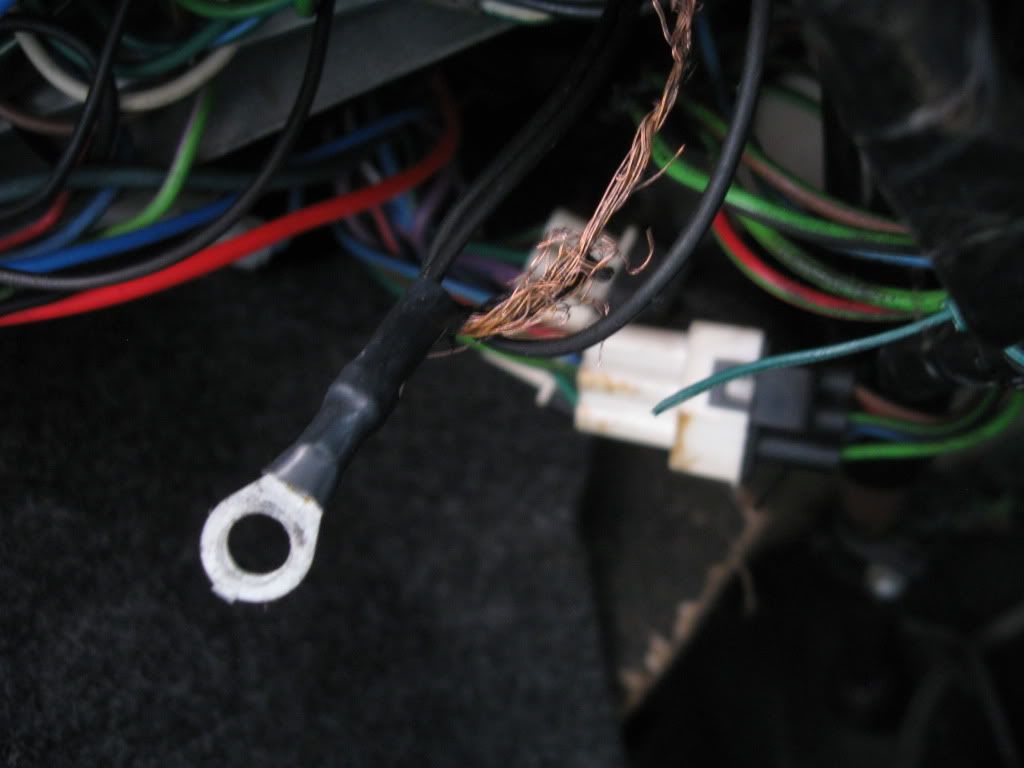

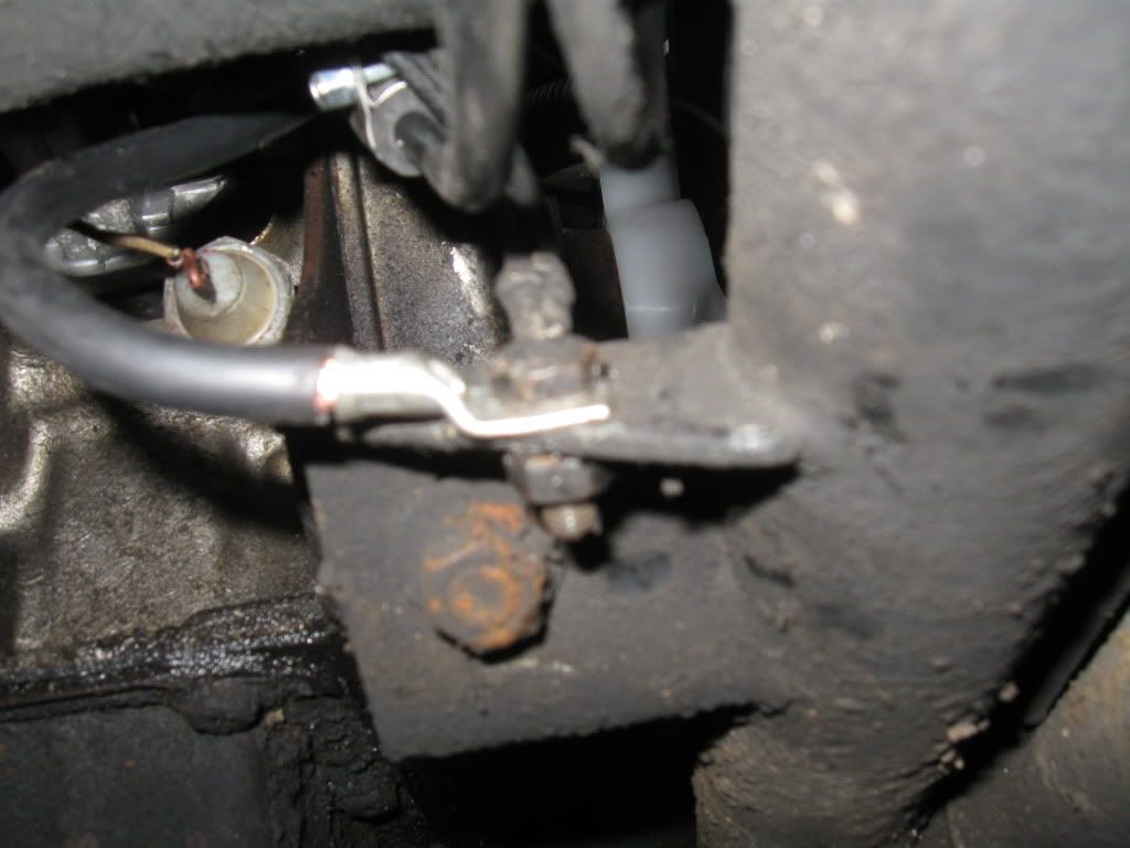

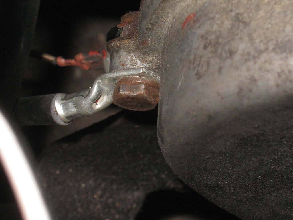

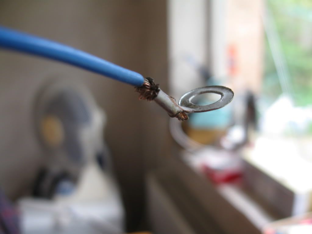

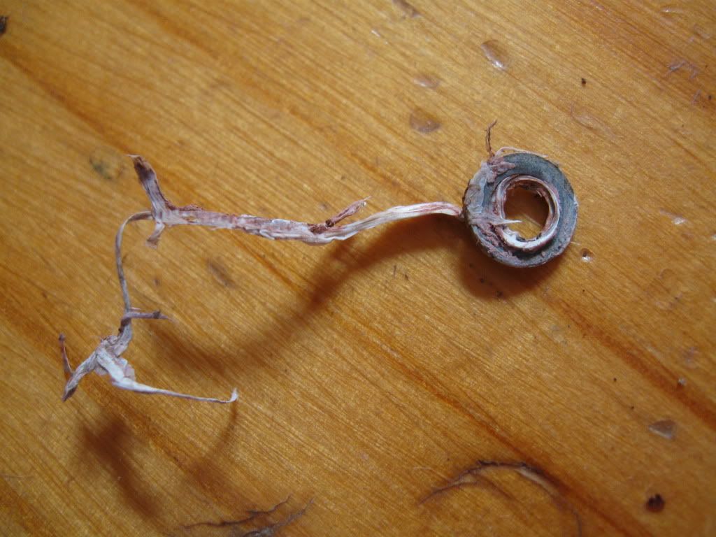

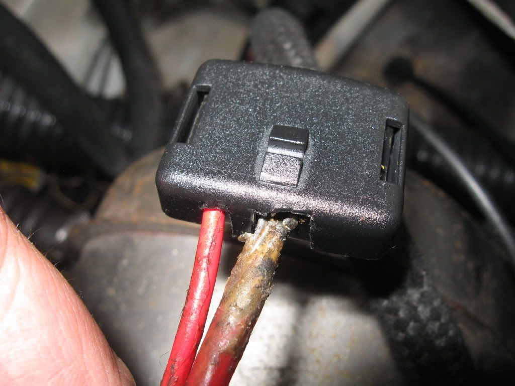

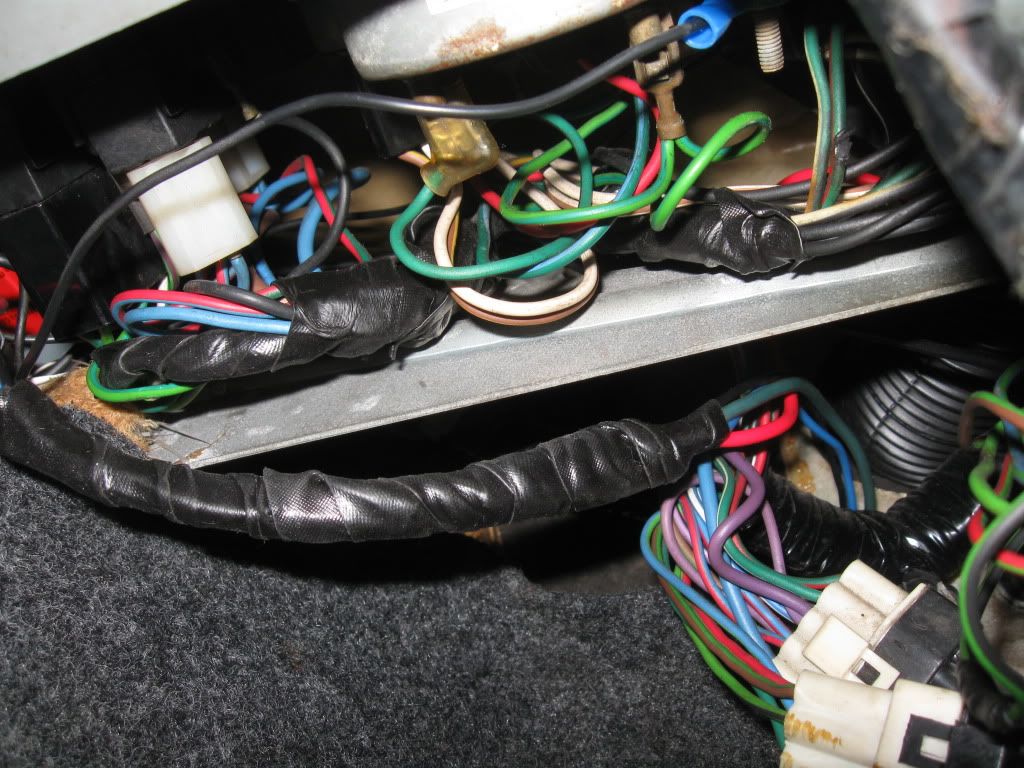

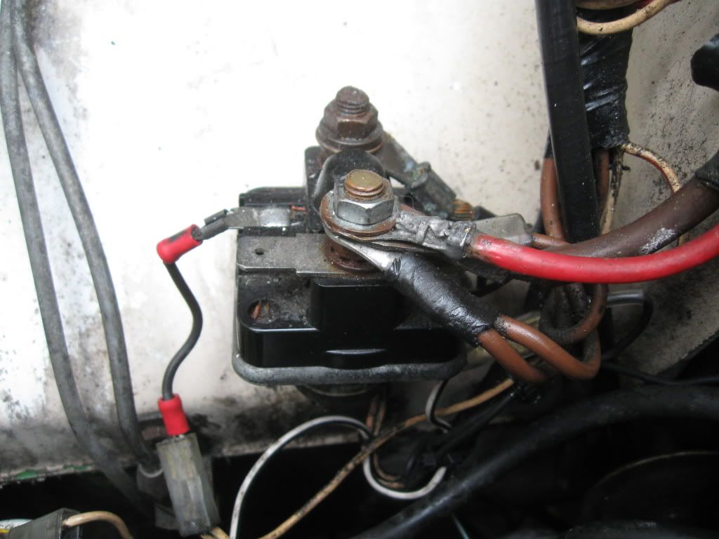

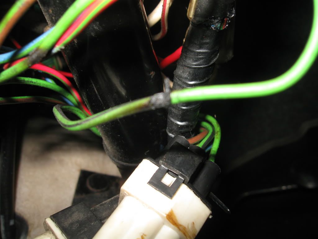

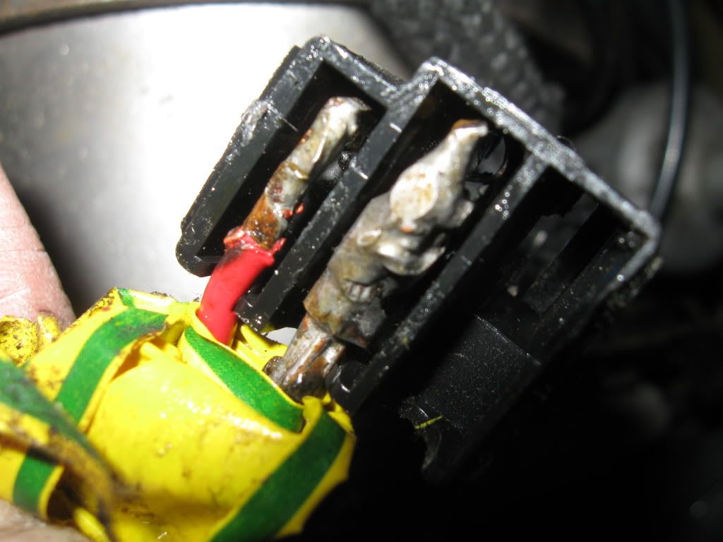

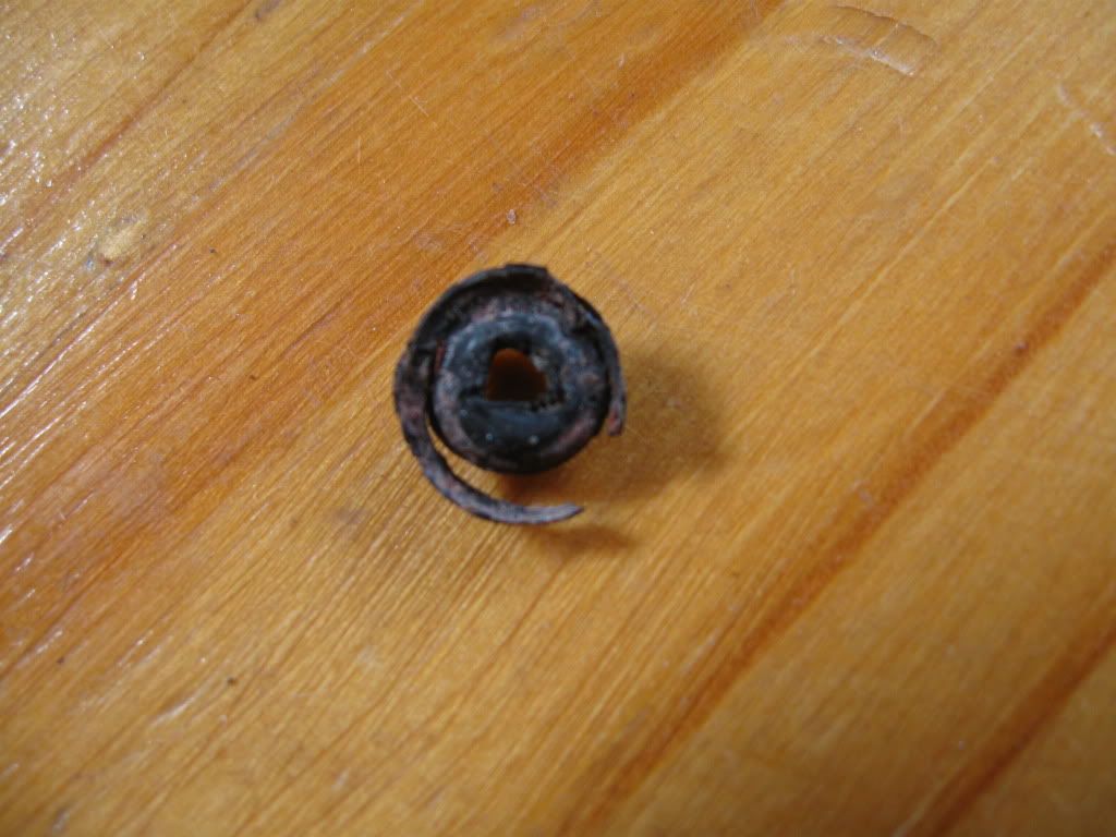

| 4th August 2011Yet another breakdown - burnt out earth wires I'd hope that I wouldn't have to revisit the hard shoulder again My Rialto 2 decided to half cut out and produce a lot of grey smoke from within the car, so I immediately switched off the engine, pulled into the hard shoulder, stopped as fast as possible and got out !! I opened up the engine lid and found nothing untoward around there at all, so I called the RAC. The RAC patrol man turned up to have a look (he agreed before he arrived that it would be too dangerous to fix by the roadside and called for a recovery truck). We both found these burnt out earth wires (that were not connected to anything) near the ignition switch. Car winched onto the recovery truck with the battery disconnected. When the I got back home, the recovery truck driver and I pushed the car off the truck and got it into the driveway. I'll be having a more thorough look at it tomorrow and during the weekend. It looks like that I may have to miss the Lingfield show this weekend. | |
| Subject: Re: 1985 Lap Rialto 2 (hopefully a more concise version of it) - this may take me time to update it. Fri Oct 26, 2012 9:06 am | |

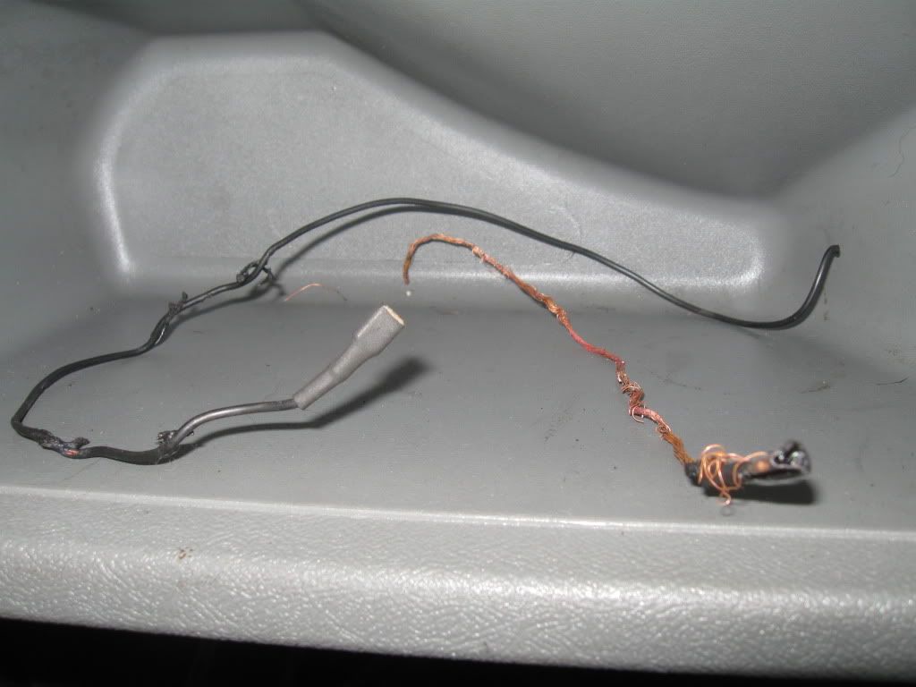

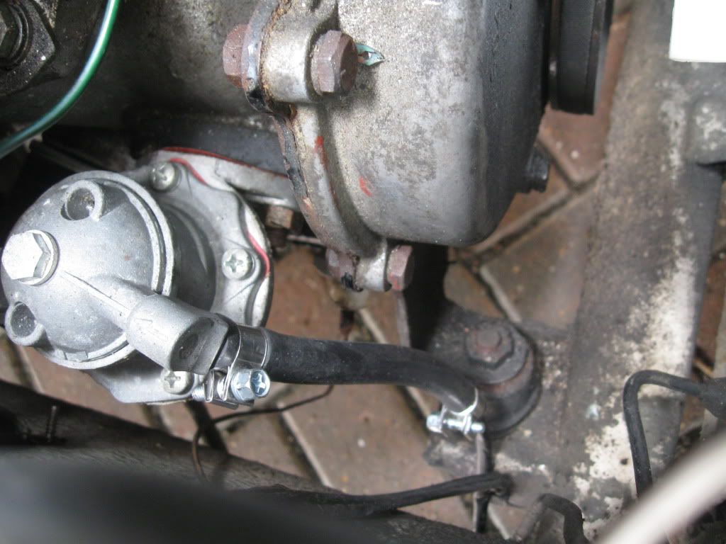

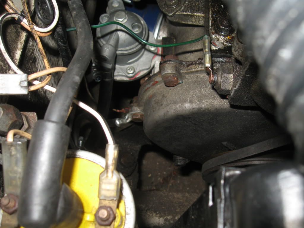

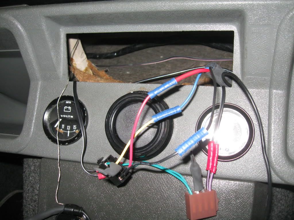

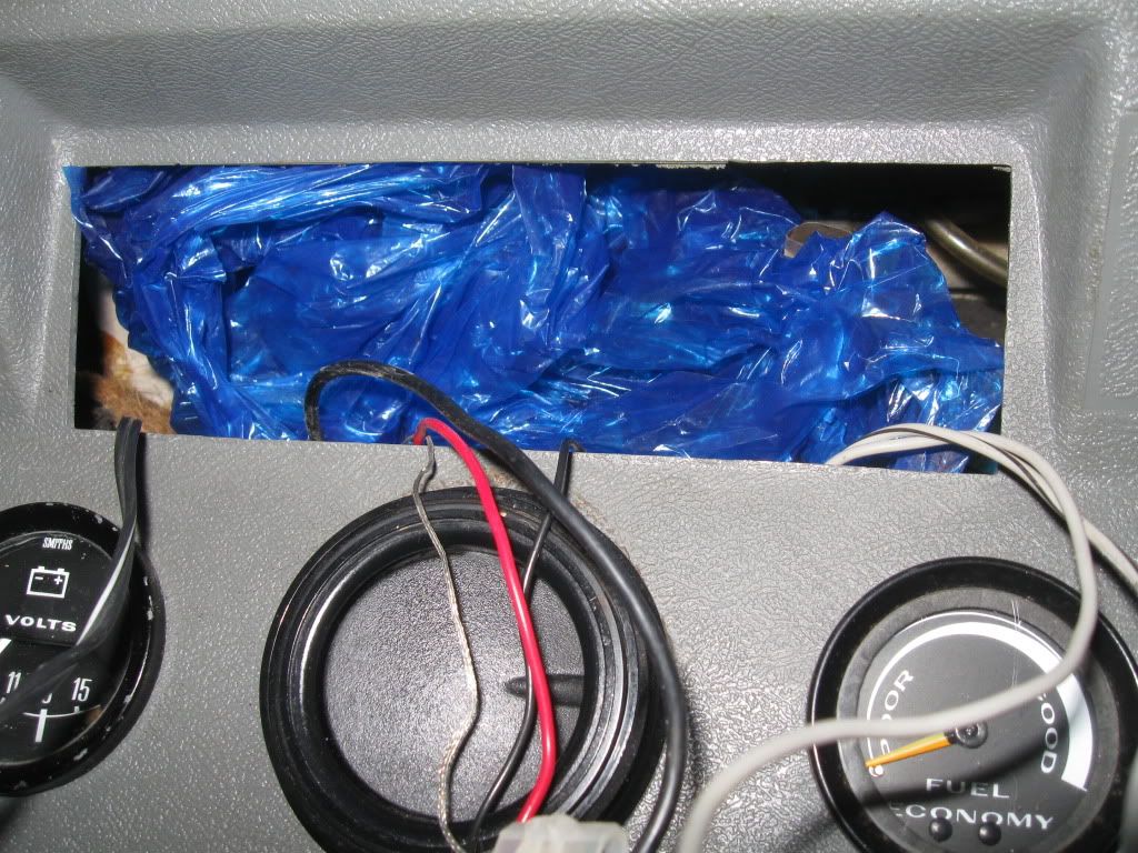

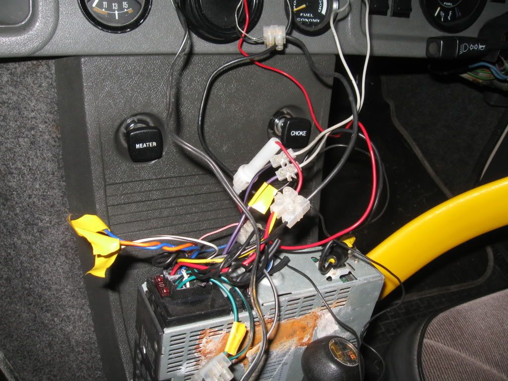

| 5th August 2011I had a fairly quick look at the wiring on my Rialto 2 estate...Hi everyone, I spent about an hour this morning having a look at the wires to see what damage has been done. Engine bay (no damage here):- Burnt out earth wires (the three loose earth wires have now been cut off):- Slightly burnt windscreen wiper wire when (I think) one of the loose earth wires' spade terminal had chaffed against it :- Unused green/purple wire (part of a wiring loom) hanging down and loose. This will have to be covered in heatshrink rather than plastic tape:- More unused loose wires (covered in plastic tape) :- I think one of these crimp connectors may have caused the eletrical burnout:- Another unused earth wire cut off:- Engine earth connected incorrectly It's connected to the chassis instead of the engine (I later connected that earth strap to the chassis and the timing chain cover). I'll be correcting that (as well as other things) tomorrow:- This is how the engine earth is connected on my Rialto SE hatch:- | |
| Subject: Re: 1985 Lap Rialto 2 (hopefully a more concise version of it) - this may take me time to update it. Fri Oct 26, 2012 9:10 am | |

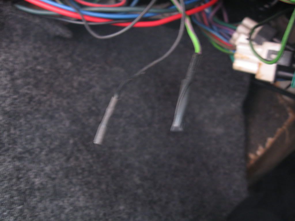

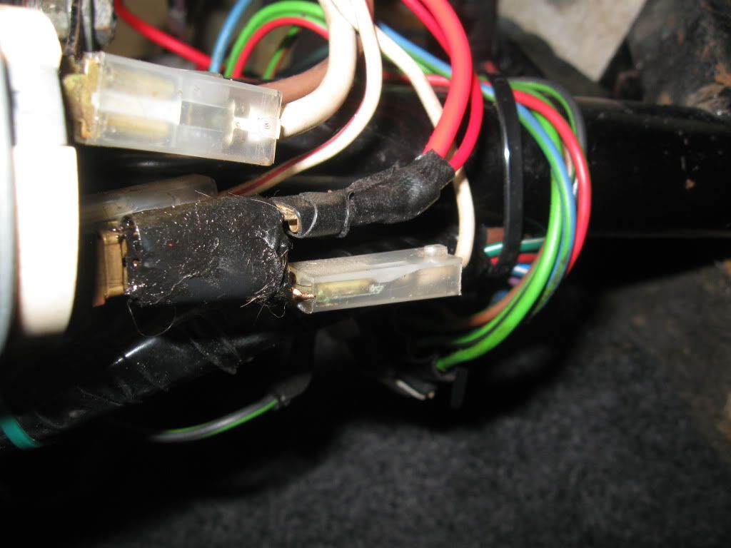

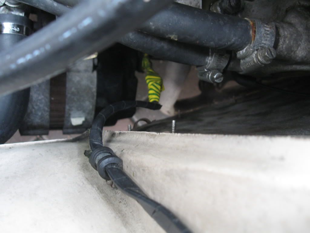

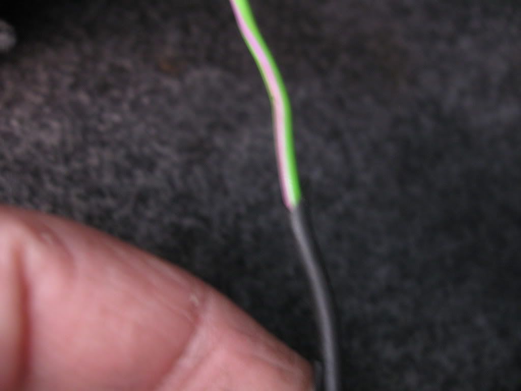

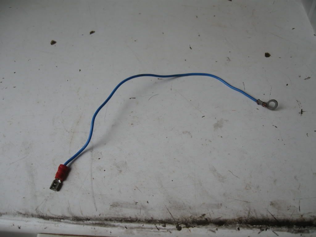

| 6th August 2011Some work I did to the wiring today...Badly crimped indicator earth wire removed:- That incorrect wire colour was replaced with the (correct colour) intact earth wire that I cut off yesterday morning. I then decided to use self-amalgamating tape to provide extra protection for the wiring looms to ensure that they don't chaff against the sharp dashboard support bracket next to the steering column. I have also insulated the slightly burnt out (approx 2mm in length) windscreen wiper wire with self-amalgamating tape. Dangling wires tie-wrapped out of the way. Bare brass spade terminal (on the ignition switch) insulated with self-amalgamating tape. I then checked the engine and gearbox earths (as wheaters had suggested earlier - I cannot remember which thread). The engine earth looks in good condition and secure, but the same could not be said for the gearbox's earth. The gearbox earth cable is secure, but it has also started to fray. After I had checked those two main earths, I decided to re-connect the negative battery terminal, start up the car and check all of it's electrics (whilst keeping an eye on the car's wiring looms). Thankfully, all of the electrics worked and there was no signs of overheating nor smoke either. After having a look at the pics of the back of the gearbox, it may also be time to replace the rear gearbox oil seal as well. | |
| Subject: Re: 1985 Lap Rialto 2 (hopefully a more concise version of it) - this may take me time to update it. Sat Oct 27, 2012 7:46 am | |

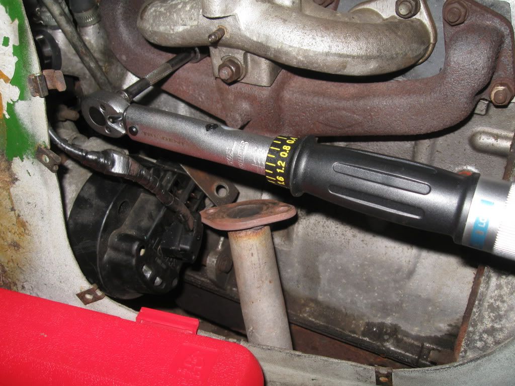

| 11th August 2011A bit more work I did on my Rialto today - engine earth and alternator wiringHi everyone, I've managed to do a bit more work today and here are some pics... New 225mm insulated earth strap (from Vehicle Wiring Problems) fitted to the timing chain cover and chassis:- Alternator wiring made safe (and it's plug is now securely attached to the alternator). Here is what was badly bodged with electrical tape The spade terminals were loose within the plug's housing. The plug's rear cover and spring clip were also missing :- The spade terminals' locking tabs have now been bent outwards with a flat-blade jeweler's screwdriver so that they will lock into the plug's housing. New plug cover. Notice the modification that I had to make to it (with a pair of side-cutters) so that it will accommodate the wires on the Reliant 3 wheeler's alternator plug housing. The alternator plug housing on a Reliant 3 wheeler appears to be backwards compared to the standard Lucas 3 pin alternator plug:- Alternator wires protected with self-amalgamating tape:- Alternator reconnected:- | |

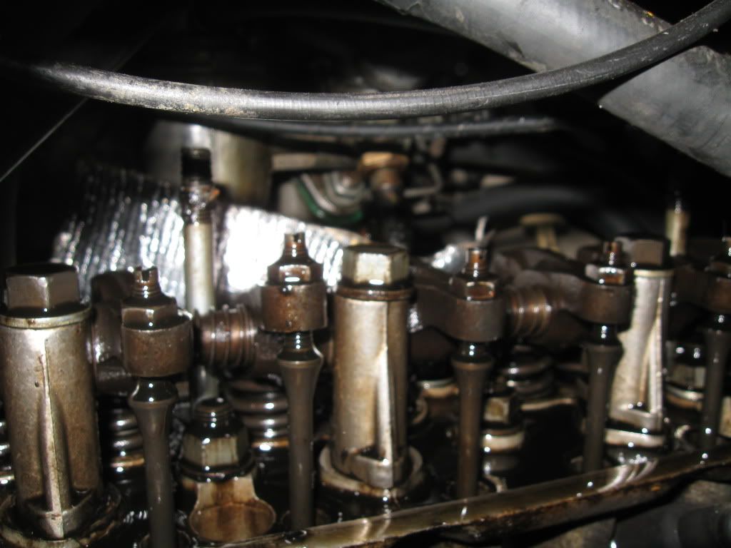

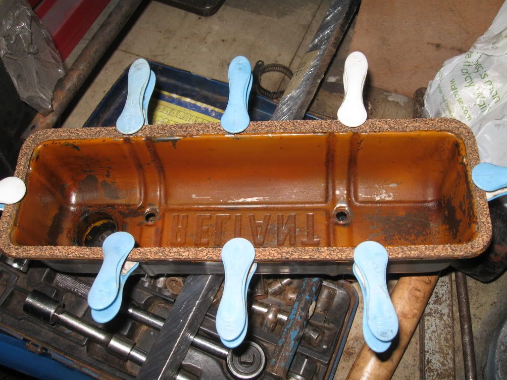

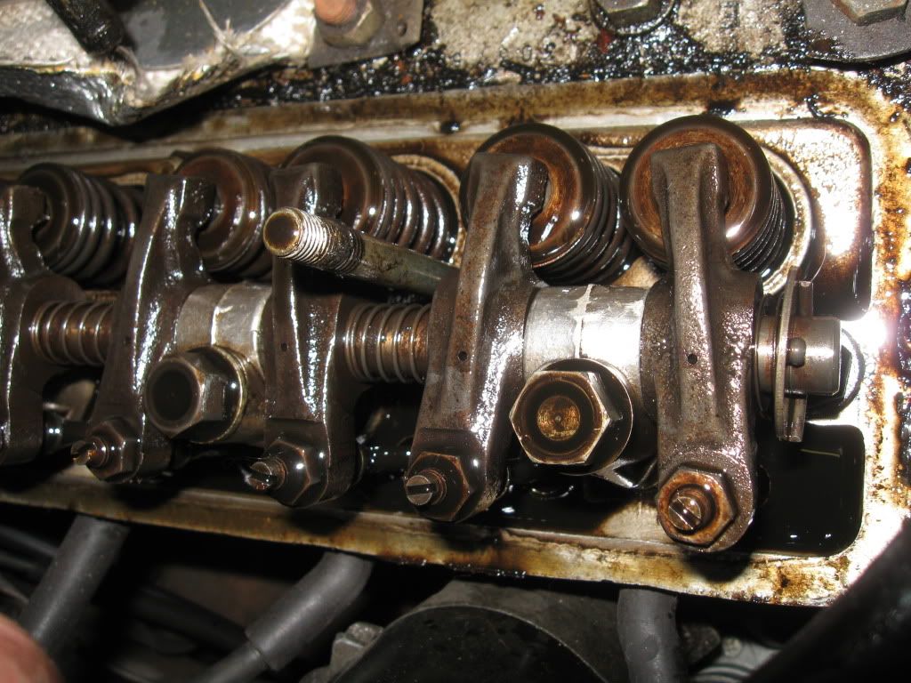

| 29th August 2011

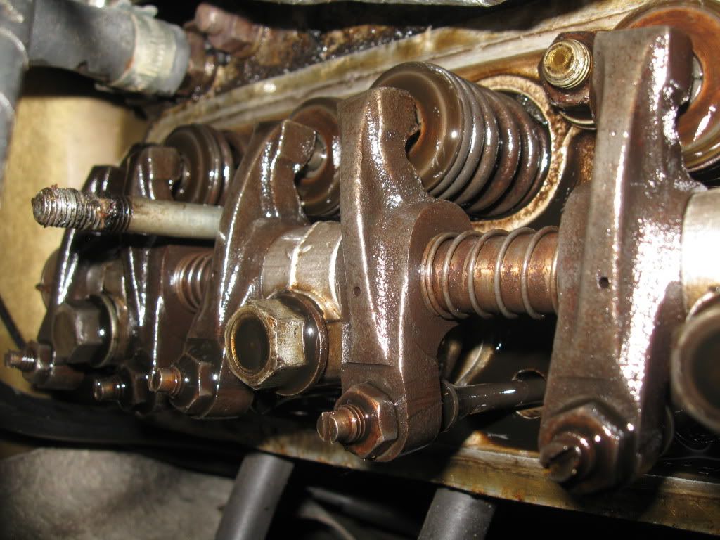

A small amount of work I did to my Rialto 2 yestday and todayHi everyone, Only a minor update on my Rialto, where I did the following:- - Set tappets correctly (they were almost right anyway) - Replaced rocker cover gasket (the old one was well past it) - Changed gearbox oil - Greased propshaft Anyway, here are a few pics of what I found..... Dashpot oil leak from the carburetter's main jet ? I plan to replace the main jet at some point this week. Rocker cover removed. Nice to see that the oil's still clear and nothing has been damaged. Rocker cover with the very old gasket on it. The old gasket was practically flush with the rocker cover its self and it was clearly leaking a small amount of oil past it. Rocker cover (I may repaint it at some point and remove the nasty looking silver paint from it). Rocker cover cleaned up a bit. New rocker cover gasket in place. The new rocker cover gasket looks far better than the old one. I then decided to change the gearbox oil, where it's old fibre washers appear to have been used a few times. The gearbox's filler plug was also quite loose and took nearly no effort to remove it with my small 3/8" torque wrench. The rather nasty watery looking gearbox oil (with a few lumps in it) that came out of the gearbox. | |

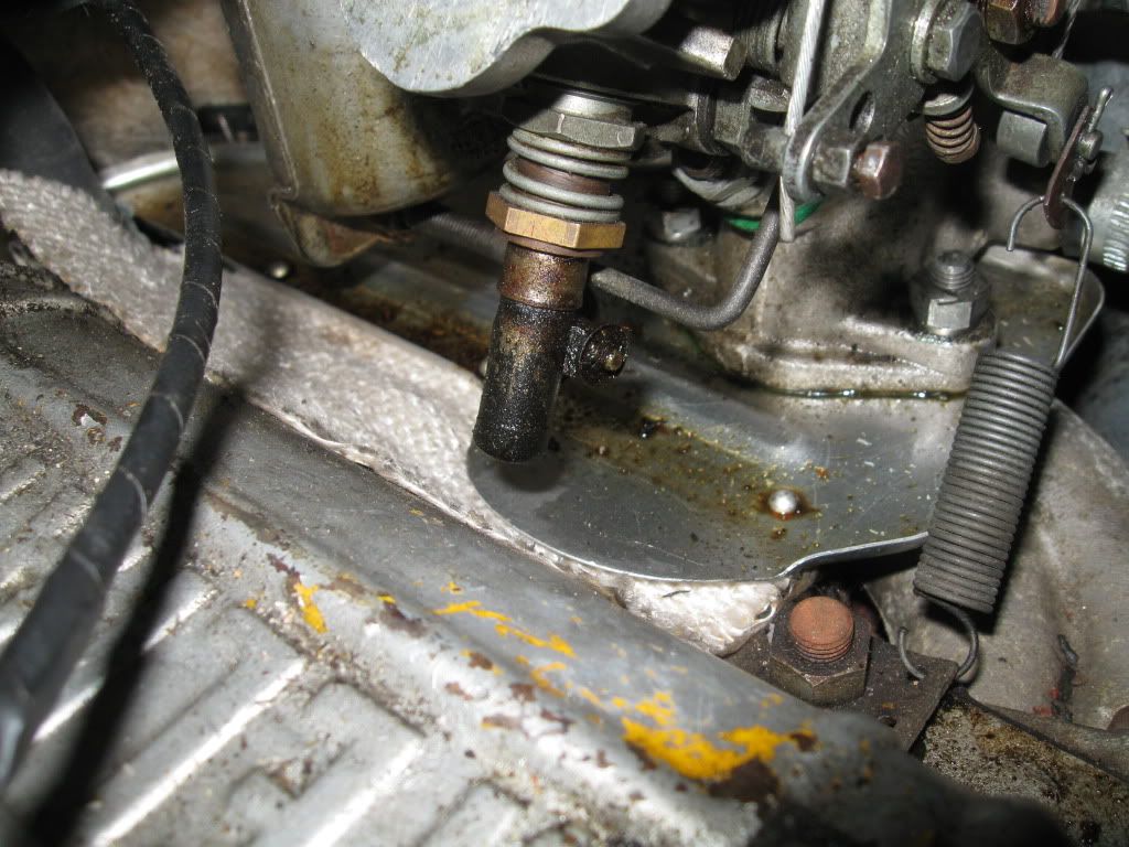

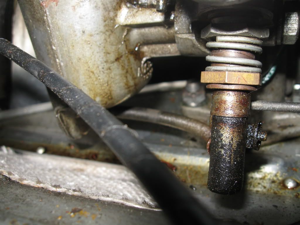

| 4th September 2011

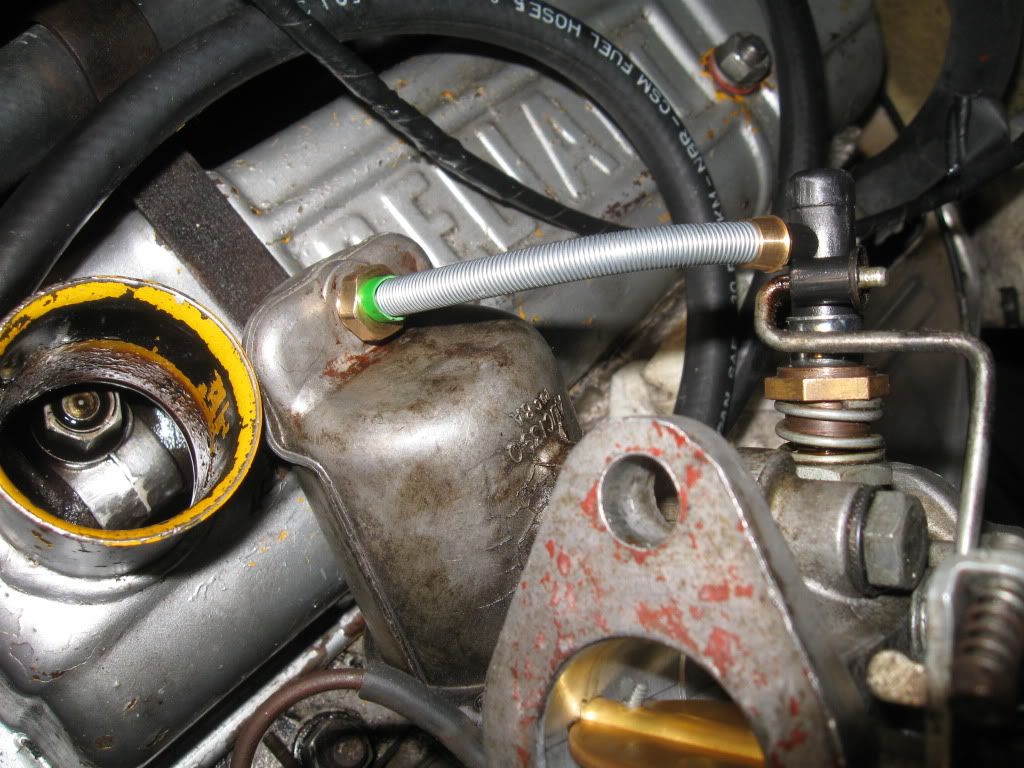

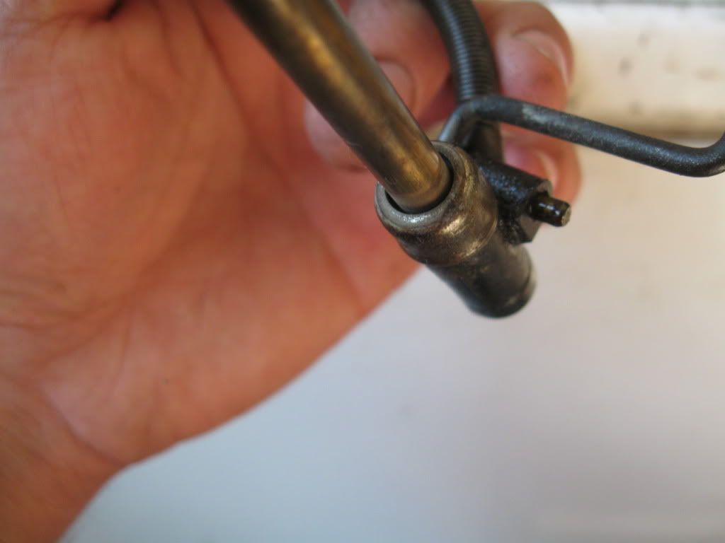

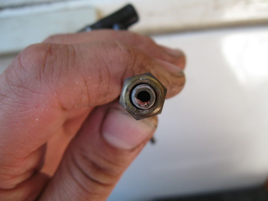

Main jet assembly replaced (yesterday)Hi everyone, I tried to stop my Rialto 2's stalling uneven idle speed problems by replacing it's carburetter's main jet. When I had a further look at it yesterday there was a minor leak from it's carburetter bowl to main jet union and on it's variable jet part of the assembly its self. I decided to replace the main jet and here's what I found: The old main jet was well past it to say the least. Main jet assembly to carburetter union's washer bodged with PTFE tape ?? Lots of perished bits of old O ring and sealant muck at the bottom of the carburetter's bowl: The old O ring was well past it to say the least. It's a good thing that I prevented a fireball: Old main jet assembly (the pipe from the carburetter's float bowl was blocked with some of that gasket muck by the looks of it): Carburetter bowl's main jet union thread cleaned out: New main jet fitted: It still didn't solve my Rialto 2's stalling/uneven idle speed problems, so I guess the next thing to replace are the perished rubber vaccuum hoses and vacuum pipes (already ordered). Hopefully, after they have been replaced, that will sort that problem once and for all. | |

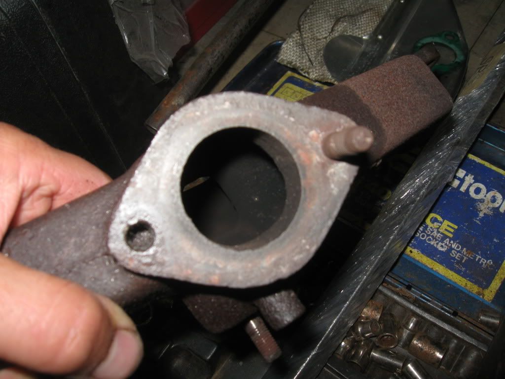

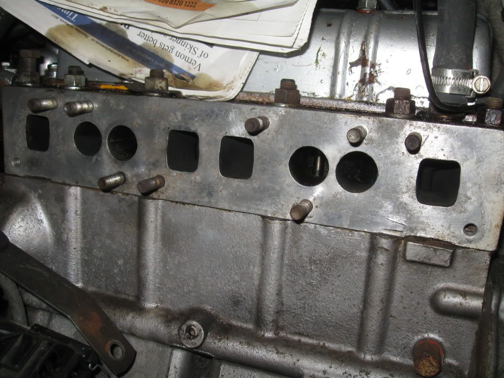

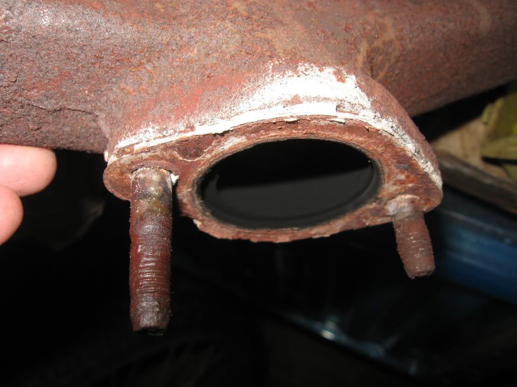

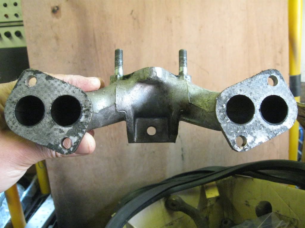

| 17th September 2011

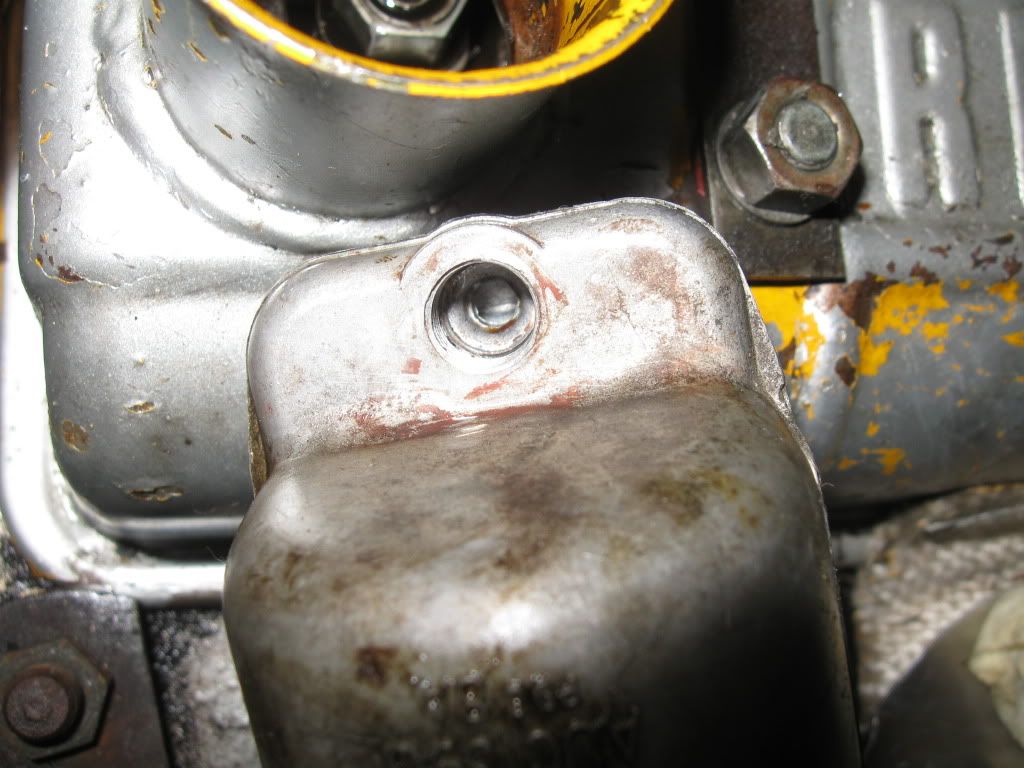

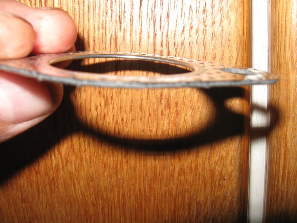

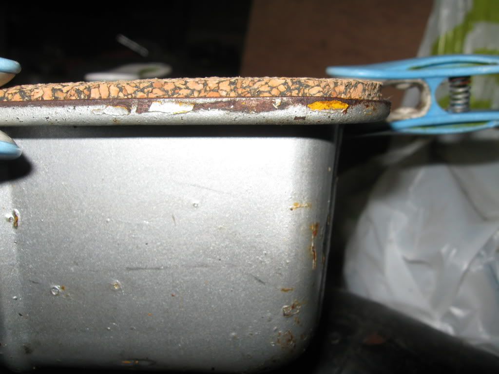

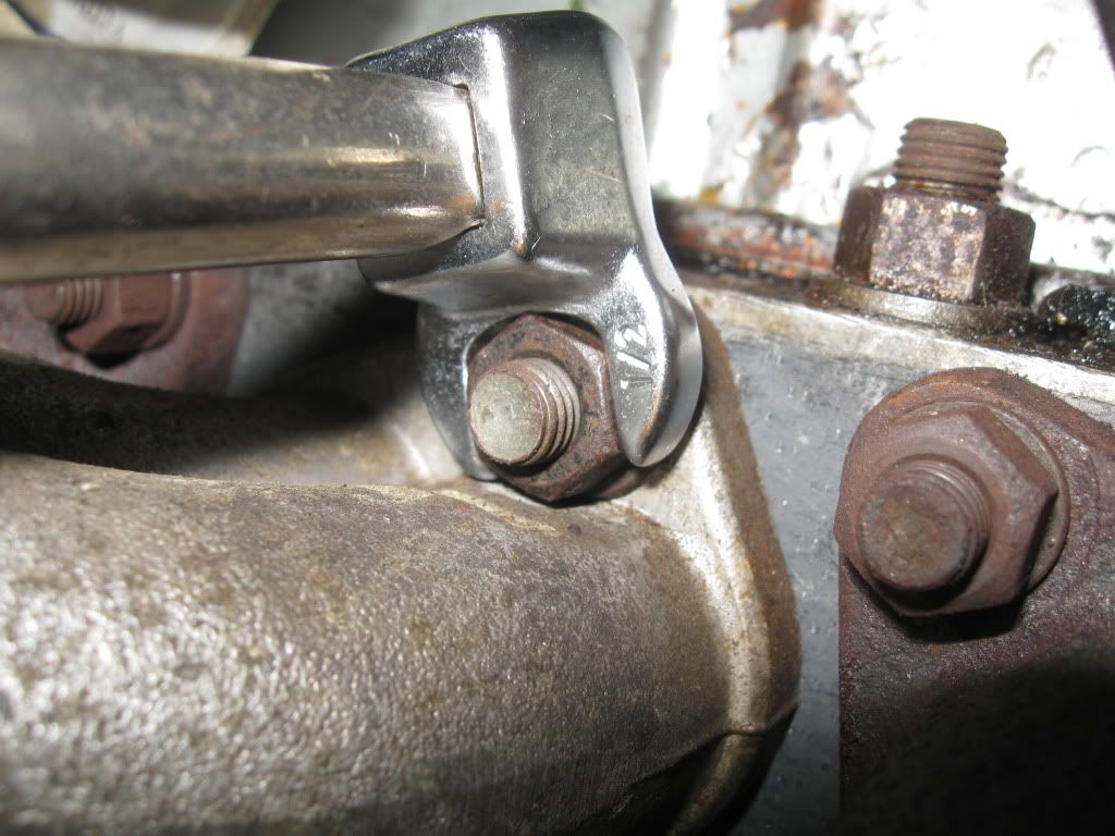

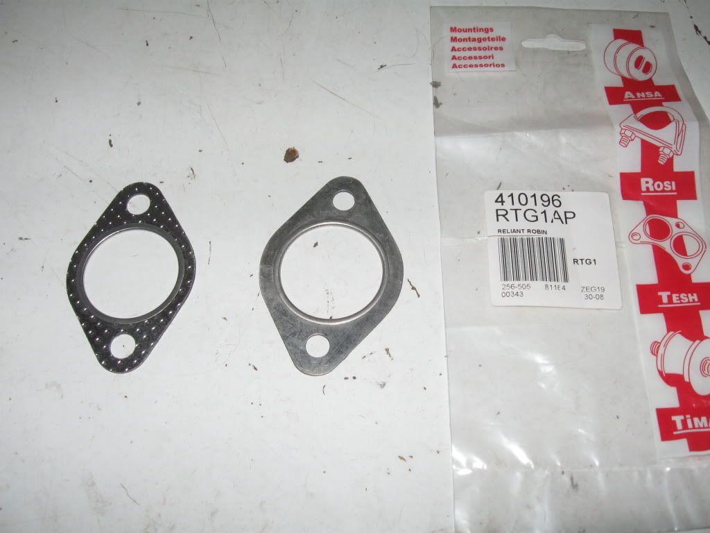

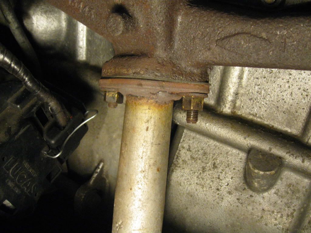

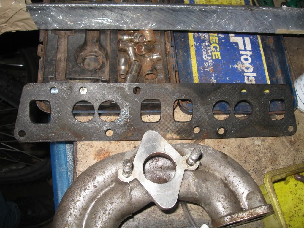

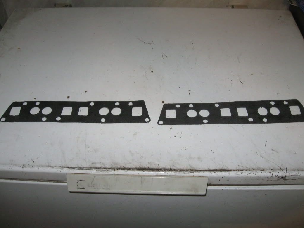

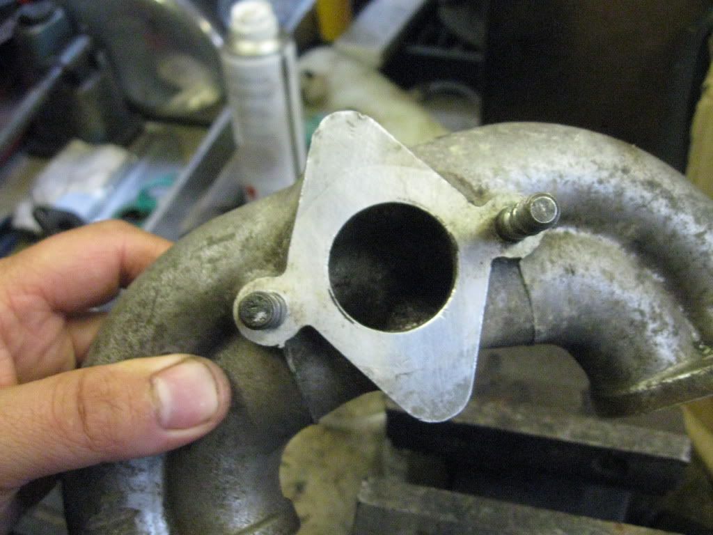

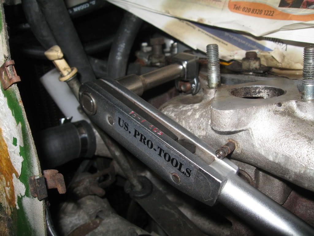

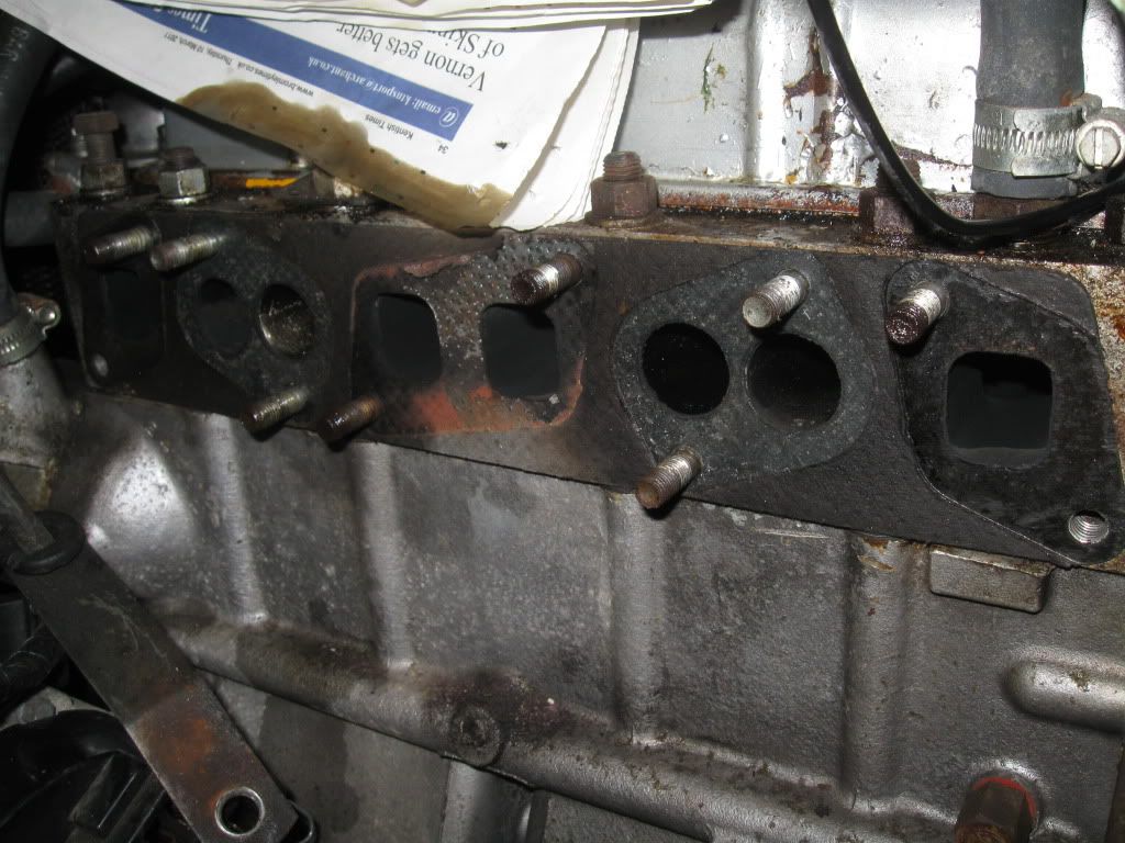

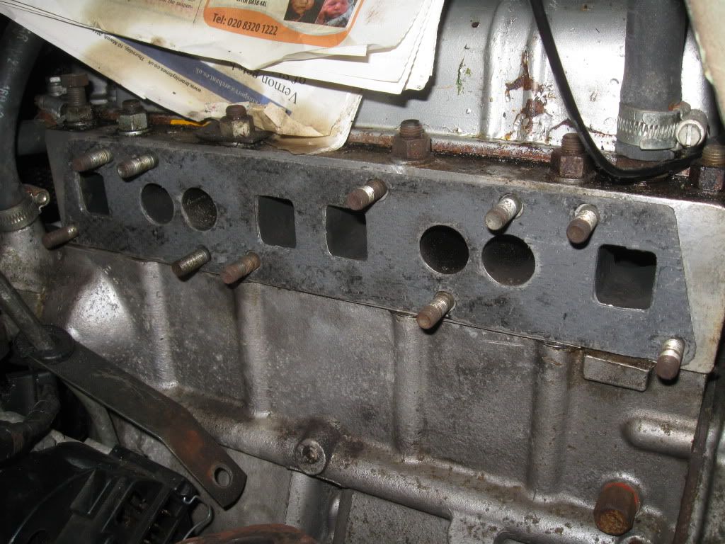

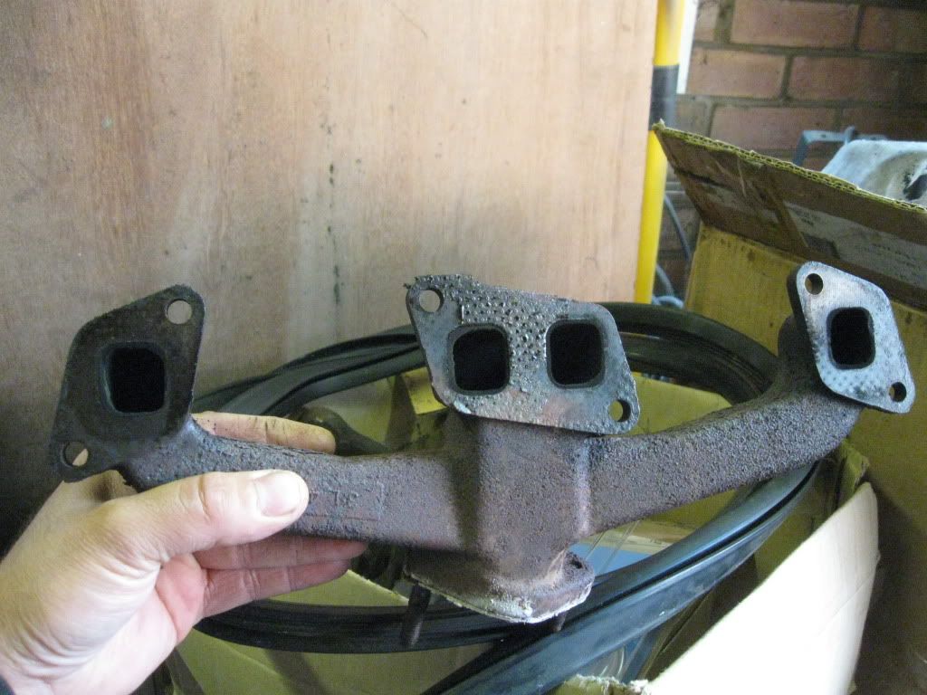

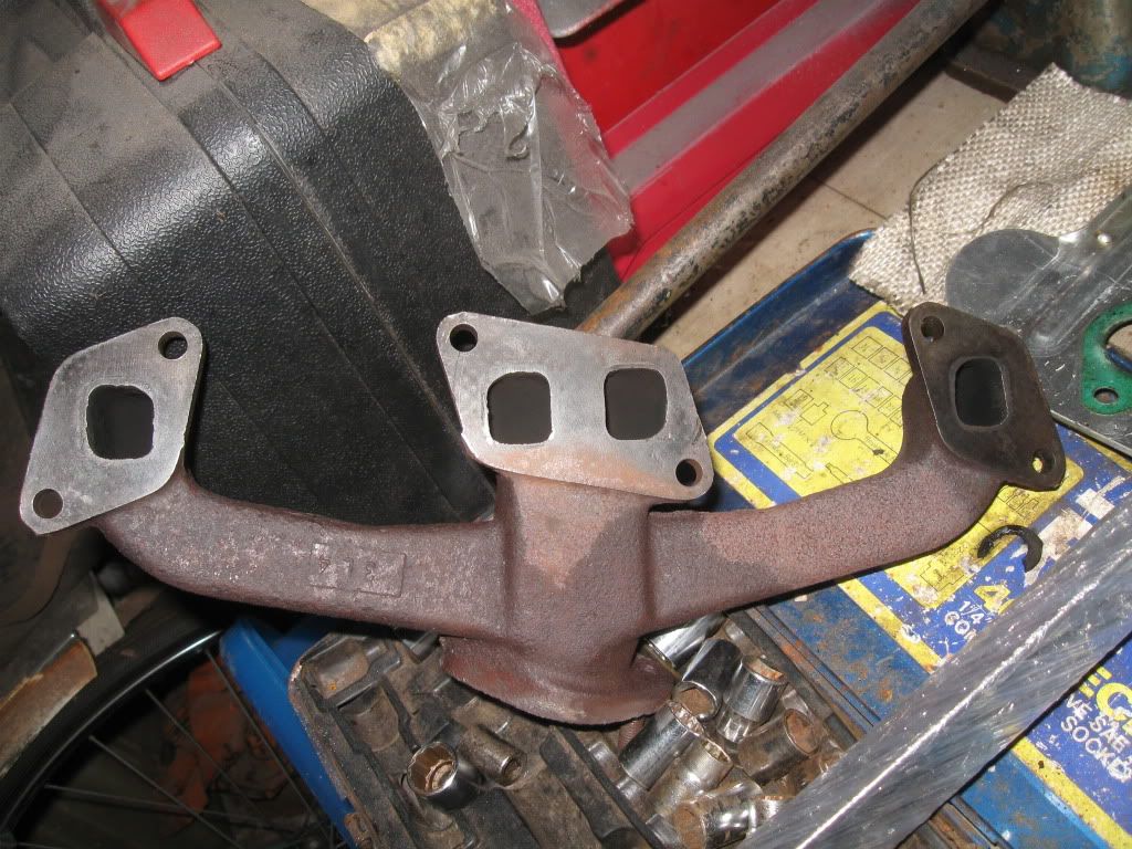

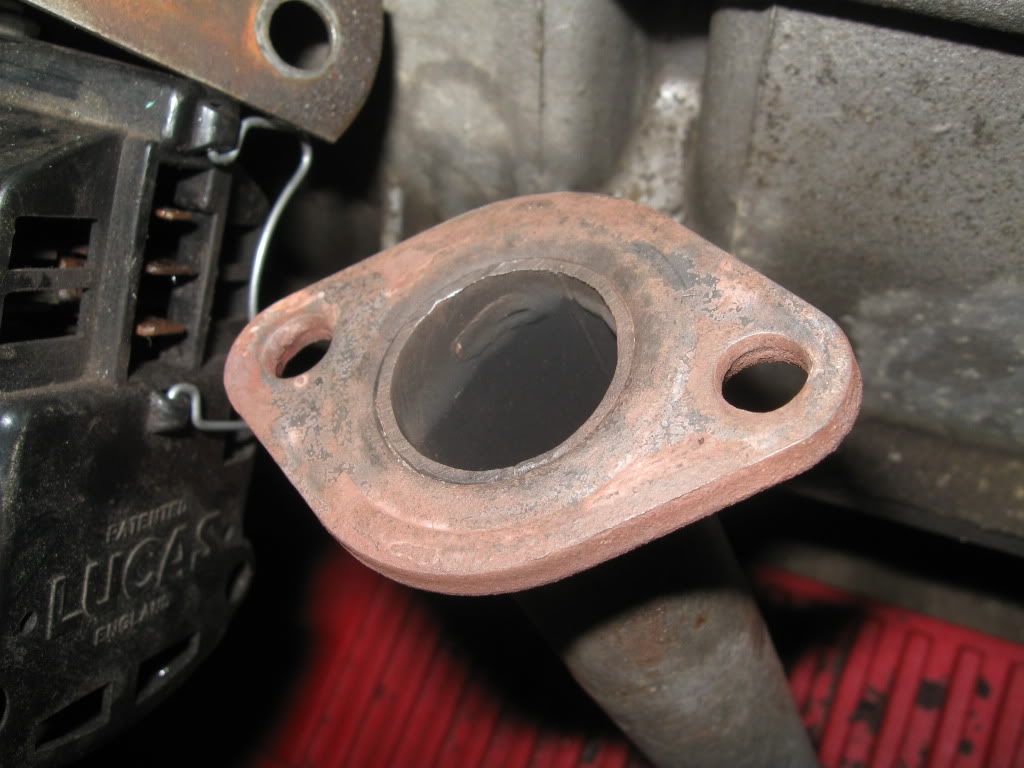

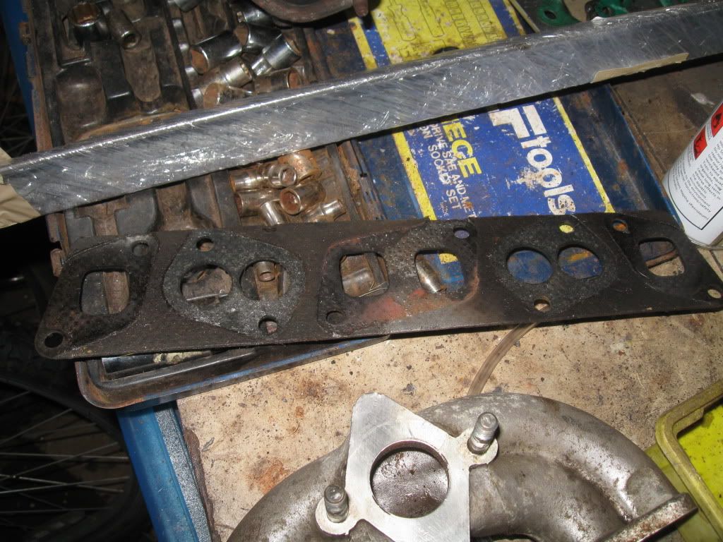

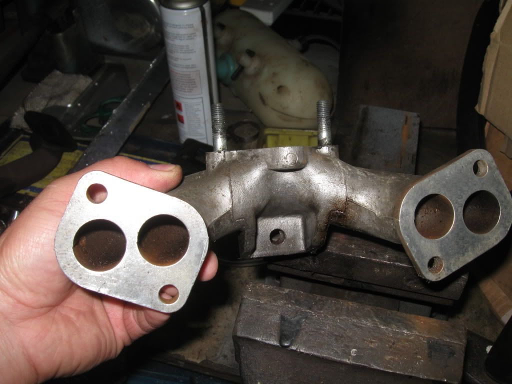

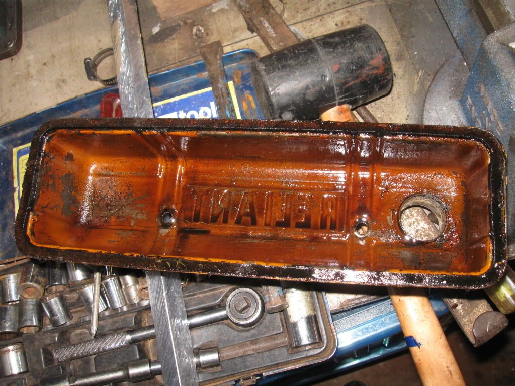

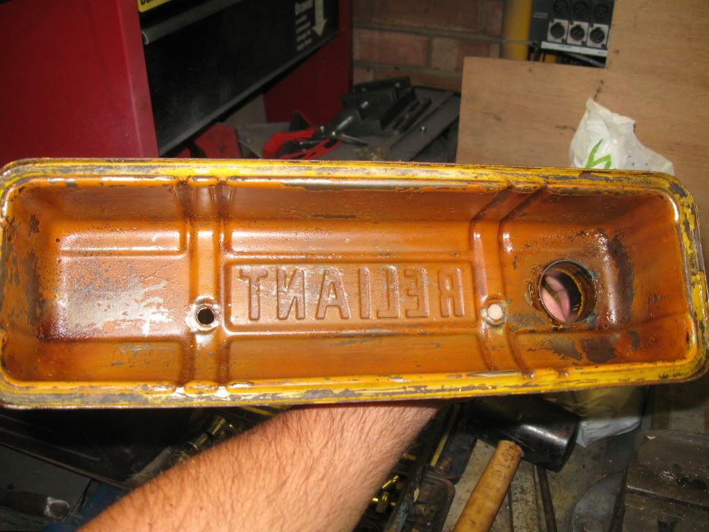

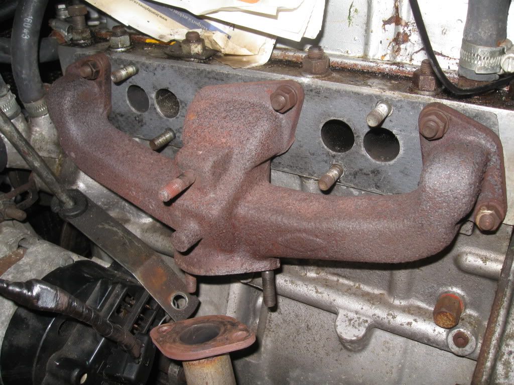

Inlet, exhaust manifolds, etc. removal and slight cleanup.Hi everyone, I've managed to do a bit more work to my Rialto 2 estate today and here's a few pics of what I found. Inlet manifold removed with bits of the old inlet/exhaust manifold gasket stuck to it:- Exhaust manifold with bits of the old inlet/exhaust manifold gasket stuck to it:- Exhaust downpipe gasket falling to bits:- Old inlet/exhaust manifold gasket before removal (two of the studs came out of the cylinder head):- Inlet manifold after the gasket was scraped off and cleaned up with wire wool:- Exhaust manifold after the gasket was removed and cleaned up slightly with wire wool:- Remains of the old inlet/exhaust manifold gasket. The old exhaust downpipe gasket disintegrated as soon as I tried to remove it:- Cylinder head after the gasket was scraped off and cleaned up with wire wool:- Exhaust down pipe after a quick cleanup with wire wool:- When I removed the inlet and exhaust manifolds, I found that the nuts were far too loose and I managed to undo them with a spanner. According to the Haynes manual, they should be tightened to between 12 lbft to 15 lbft and requires a crow's foot spanner to tighten them properly. Unfortunately, the set of crow's foot spanners I have currently got are not open ended and I won't be able to tighten the inlet manifold nuts properly. Fortunately, I found a 1/2" AF open ended crow's foot spanner (at nearly £30 !), which should be able do the job. I also found out that one of the exhaust manifold to down pipe studs was far too long (it's 1 3/4" in length) and made removal of the exhaust difficult (it took me about 1/2 hour to remove it from the exhaust manifold). Fortunately, I managed to find a shorter 36mm (approx 1 1/2") long 5/16" AF stud on eBay and hopefully that will make the exhaust easier to refit once I have refitted the exhaust and inlet manifolds. | |

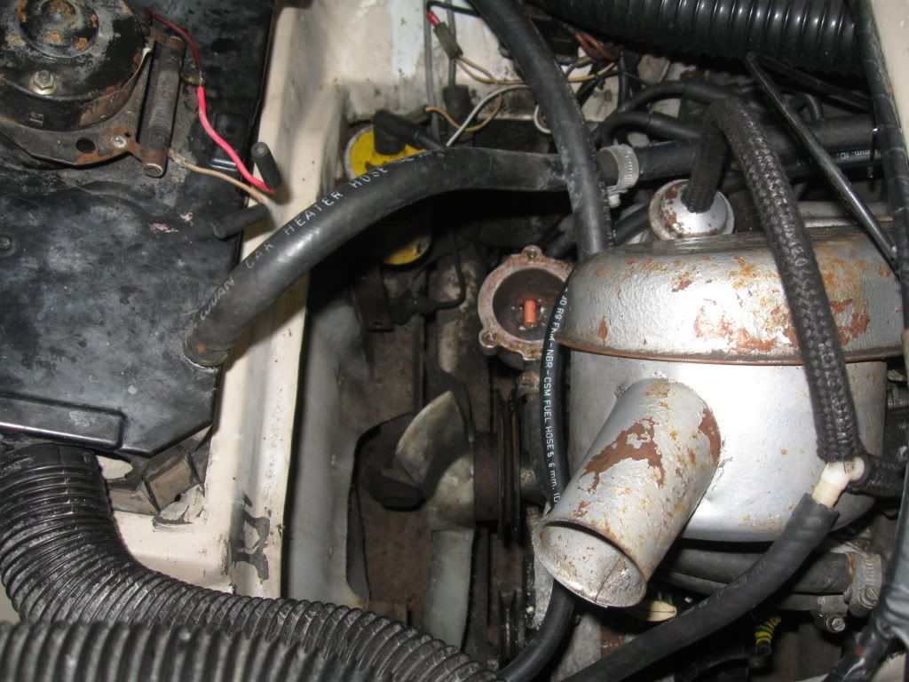

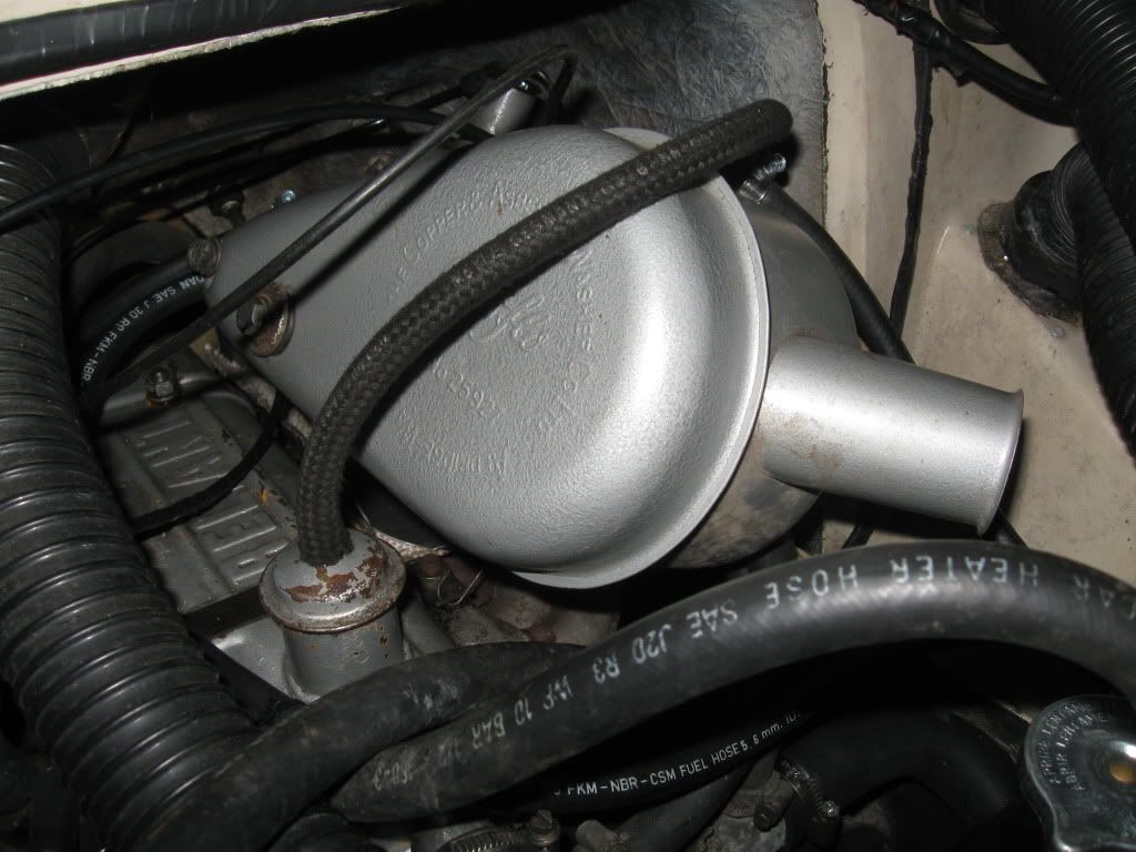

A bit more progress...Hi everyone, I've made a bit more progress on my Rialto 2 today (well it's actually try and put it back together as quickly as possible), which was to put the exhaust system back together. Sadly, I had no time to do any porting on the inlet nor exhaust manifolds. Anyway, here are some pics:- Inlet/exhaust manifold gaskets that Madblokey dropped off for me today Thank you for that, Si I just don't know where the gaskets from Dan are (I think they must be lost in the post). Gasket fitted to cylinder head:- Exhaust manifold refitted to the cylinder head (nuts tightened correctly to 15 lbft):- Inlet manifold being refitted (nuts tightened to 15 lbft):- Using my 1/2" crow's foot spanner to tighten the top two inlet manifold nuts to 15lbft:- Exhaust down pipe gasket I got from ebay (Partsworld one on the left, decent quality one on the right):- The fairly rubbish Partsworld gasket. I soon saw why Dan advised me not to bother fitting the Partsworld gaskets:- Exhaust downpipe refitted:- | |

Finally got my Rialto 2 back together today...I've now got my Rialto 2 up and running. I initially had cold start problems until I discovered (thank you Dan for the advice via Facebook) that the fast idle speed screw's gap was too wide. Anyway, here are a few pics:- NOS air filter (from Dan) fitted:- Tatty car mats replaced with NOS Reliant car mats (from Dan):- Tatty bungee cord removed and NOS wheel strap fitted (from Dan):- The only thing left to do on it now (apart from changing the Halfords 20W50 Classic Oil to Morris 20W50) is to replace the rear windows, which may happen next weekend (or when I can get someone to catch the glass windows just in case). | |

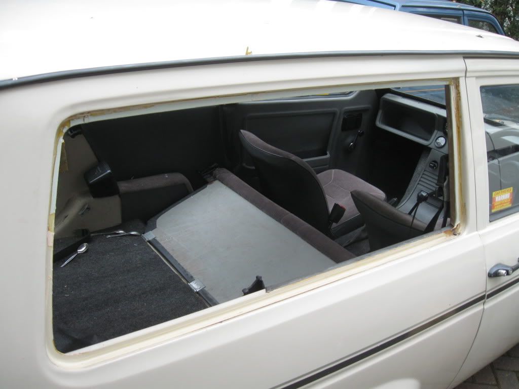

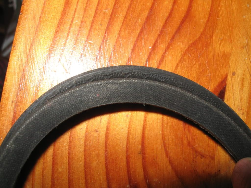

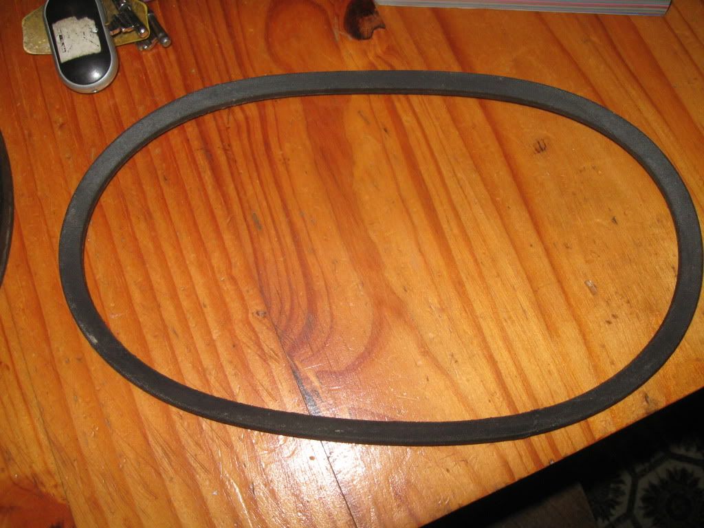

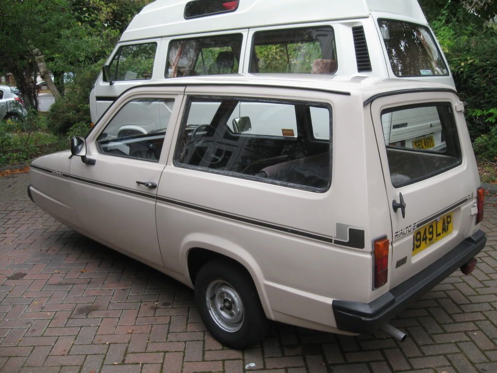

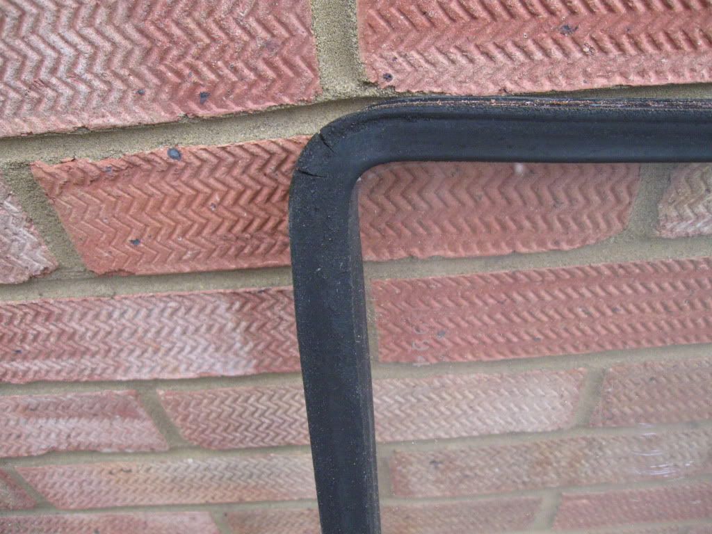

| 8th October 2011

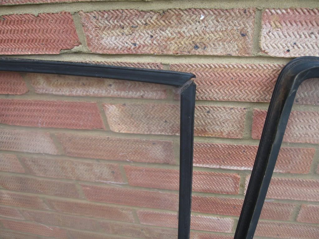

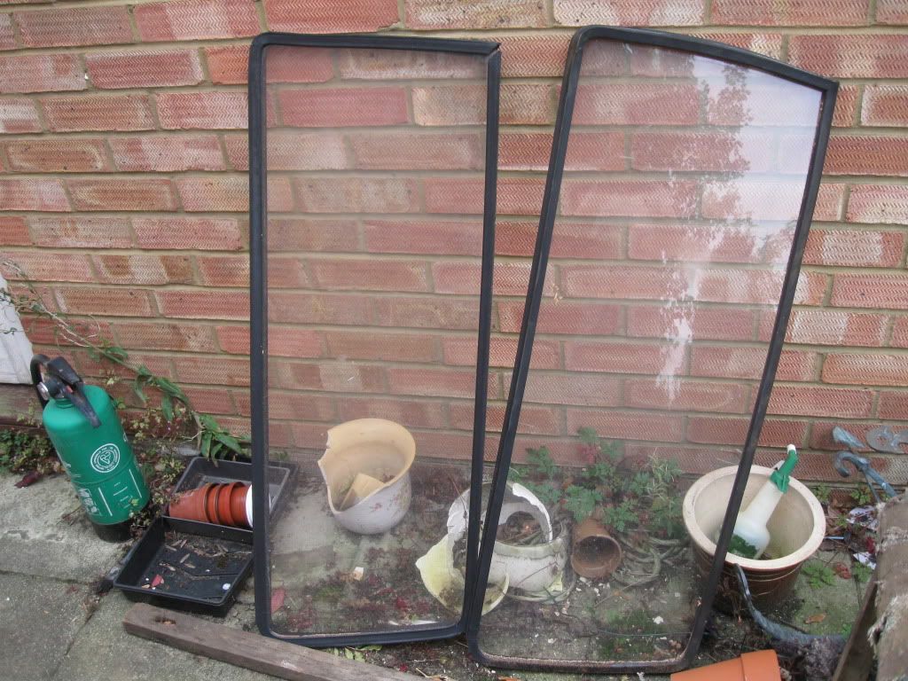

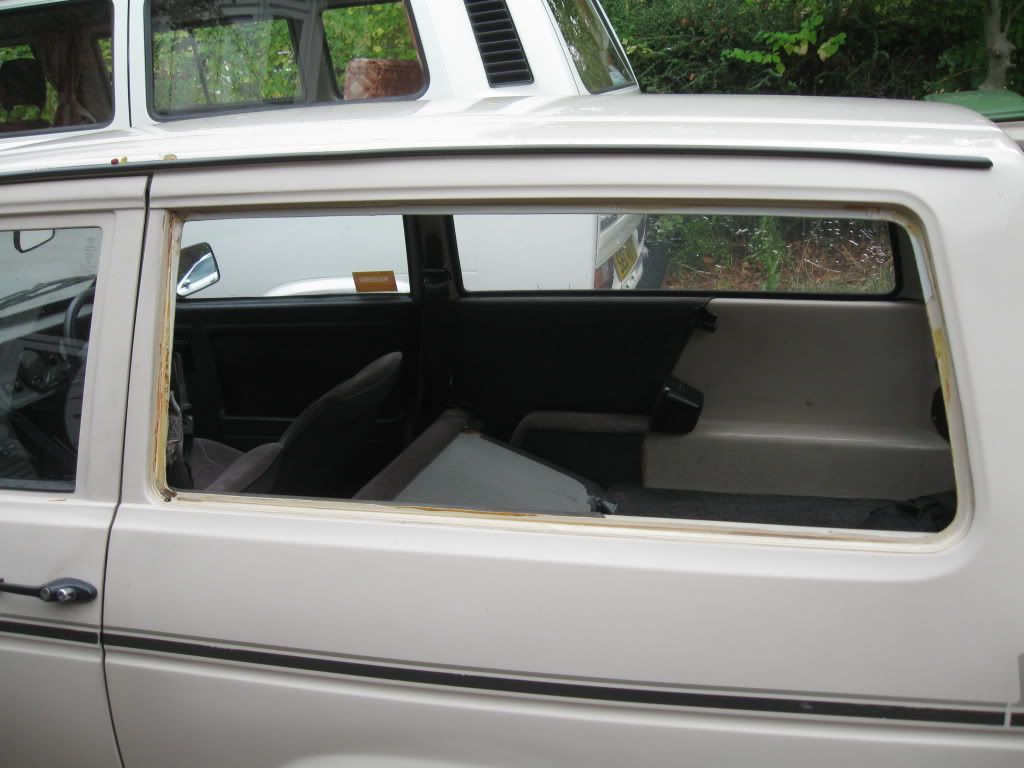

No more perspex windows Hi everyone, I have managed (with my dad's help) to change the rear perspex windows today, which were long overdue. The window rubbers that were on the car were starting to get old as well. Passenger's rear window removed:- Driver's rear window removed:- Perspex windows that were fitted to the car:- The driver's side old rear window rubber looks useable. However, the passenger's side old rear window rubber was knackered:- Rear glass windows fitted, NOS rear window rubbers used (no longer available) and windows cleaned up :- The next few jobs to do are the following:- - Replace the gearbox rear oil seal. - Replace all eight propshaft nuts and bolts for brand new nylock nuts and bolts (from Sparesman). The front end of the propshaft's nuts and bolts decided to undo themselves on Wednesday night. - Renew both doors' plastic membranes with plastic industrial sheet. | |
