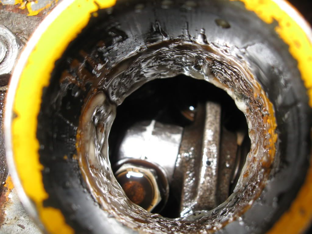

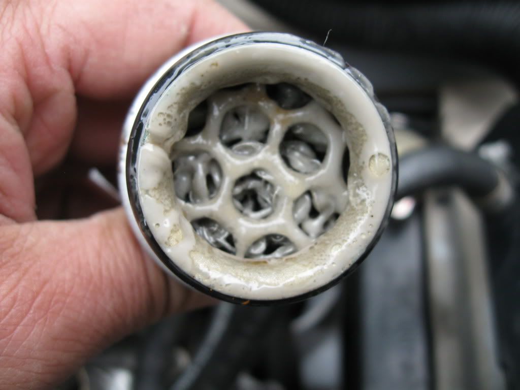

Whilst I was running the engine in the driveway, I noticed fresh oil had re-appeared on the carburetter's drip tray. I think that I will have to replace the carburetter's base and heater block gaskets as I may have re-used them too often.
I forgot to post pics of the condensation coming from the oil breather. The engine oil is clear as you can see from the pics, so I hope that it won't be head gasket replacement time (it's not as bad as my Rialto SE was before I replaced it's head gasket):-

Its frothy man! Iced coffee? Or a blown headgasket? You choose?

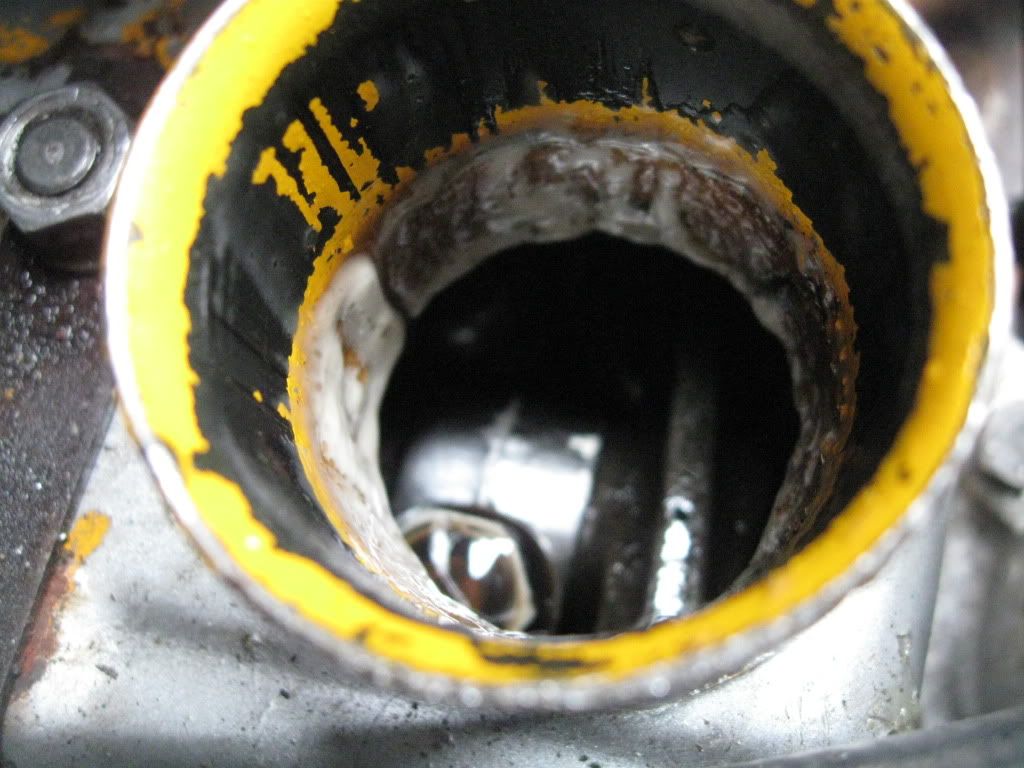

I could try that even though I have cleaned it out before (it was grey-ish froth and a lot less of it when the engine ran hot).
Thinking about it, it could have explained a lot of things. I think the head gasket problem may have been hidden when the engine used to run hot (eg. hardly any condensation) and I think it's now become more obvious as the engine now runs a lot cooler. It could also explain the high pressure within the cooling system.
I'll order a yellow top head gasket set from Gaskets for Classics just in case. Not looking forward to replacing it (it was a pain to do on my Rialto SE last year), but if it needs to be replaced then it will be replaced.
Daniel Rodd wrote:
easy way to tell if h/g,take the rocker cover off,if its got mayo spread out all over the inside of the rocker cover,its gone,if its just around the filler,it could just be damp.
It seems to be just around the filler neck and oil filler cap. The rest of the engine oil appears to be clear.
I'll poke my inspection camera inside the rocker cover when it's stopped raining to see wether there is any of that nasty sludge inside the rocker cover its self.

Blown head gasket Sad
I just quickly put my finger inside the rocker cover (I could not get my inspection camera inside the rocker cover) and found a very thick film of nasty white sludge all over the front end of the rocker cover. I asked Nicky (my fiancée) wether that sludge smells of petrol (as I suffer from hayfever and can't smell things very well) and she said that it did smell of petrol.

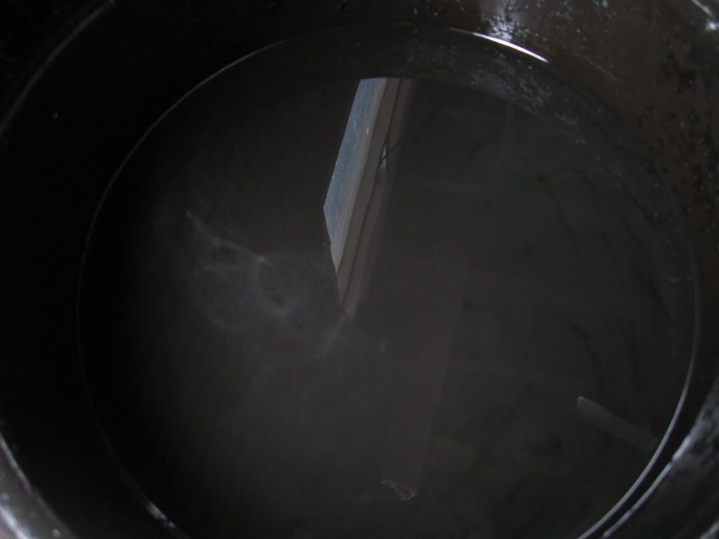

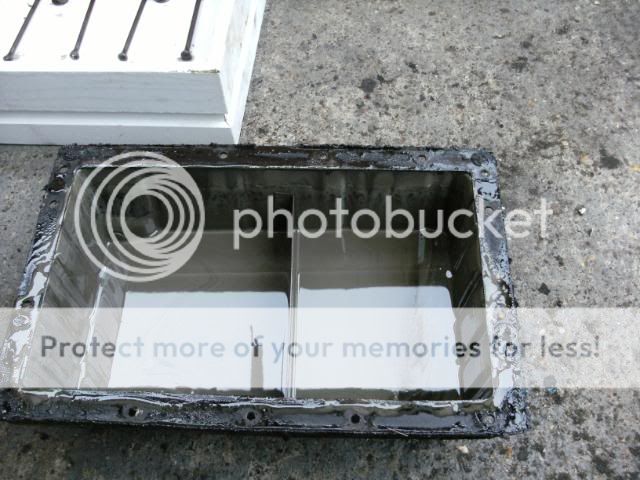

Here's Blown Head Gasket for you!
And here's how to get rid of it!
Soon gets rid of the Mayo!

Lots of black smoke too.
Why not just pour into an old oil/antifreeze can and then use some loo paper or kitchen role to clean up the residue. Ruin the sump like that.
