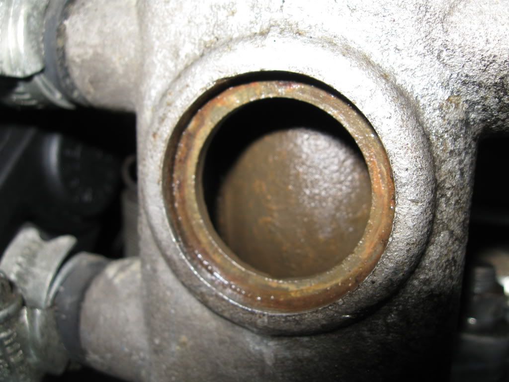

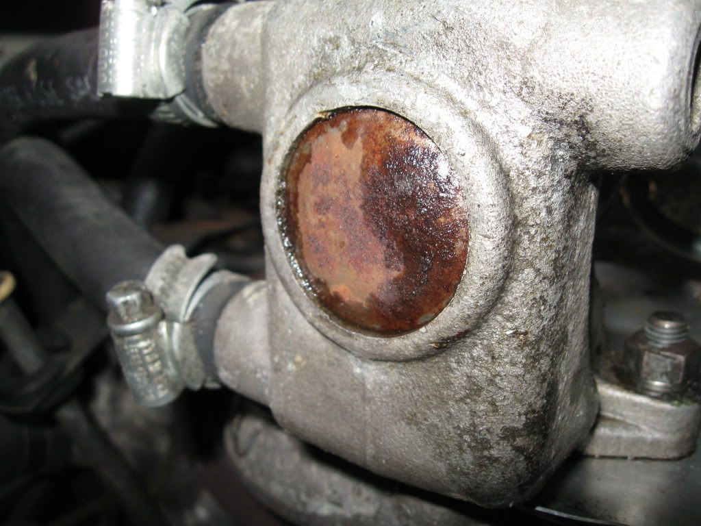

I have just found another possible reason for the hot starting/occasional coolant loss problem - a leaking carburetter heater block core plug.
Thankfully, I seem to have spotted this in time otherwise it may have ended up costing me an engine.
Does anyone know what size that core plug is so that I can replace it ? Thank you everyone in advance.
How? The leak could get worse but you'd probably notice before losing serious amounts of water.

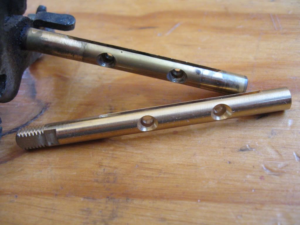

Work I did to my Rialto 2 today...

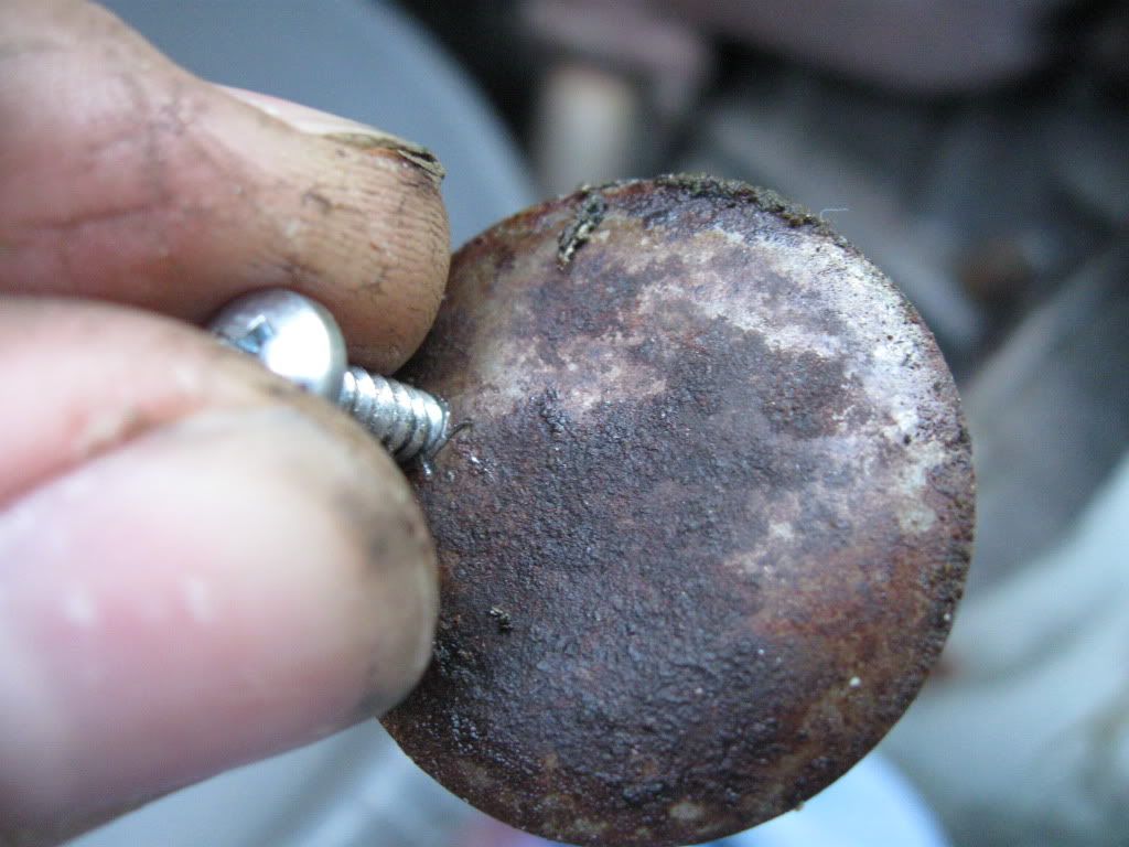

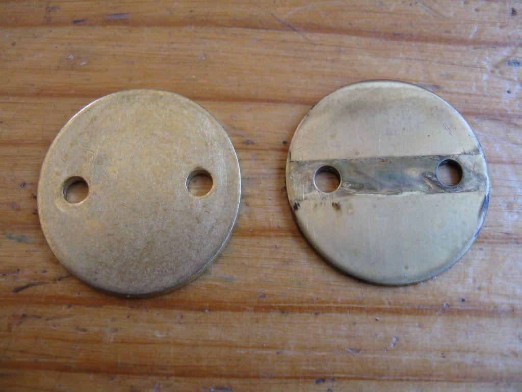

Replacing the carburetter throttle spindle and throttle butterfly. Old throttle spindle and throttle butterfly, which has at least 1mm side to side play within them:-

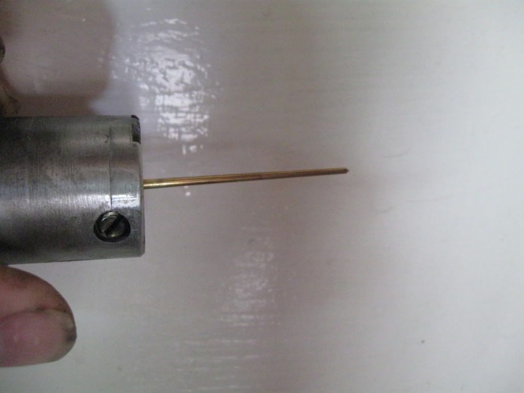

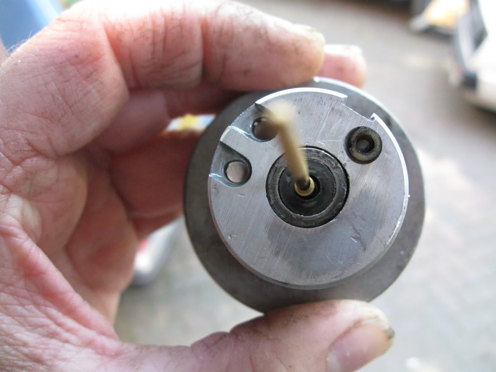

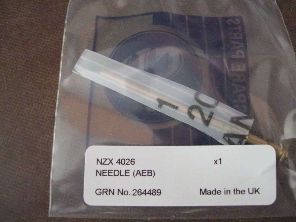

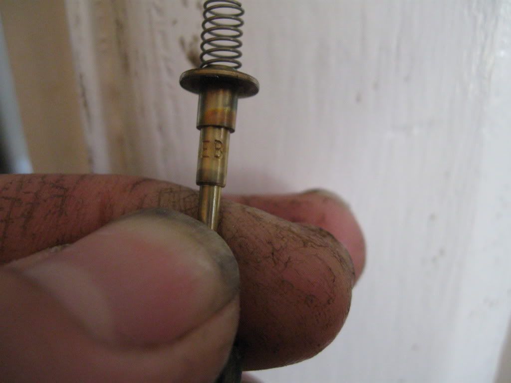

Carburetter damper piston and main jet needle removed:-
The old needle was the correct AEB needle, but it was also worn:-
Main jet needle from Burlen Fuel Systems:-
New and old main jet needles side by side. The old worn out main jet needle is on the left in the pics:-

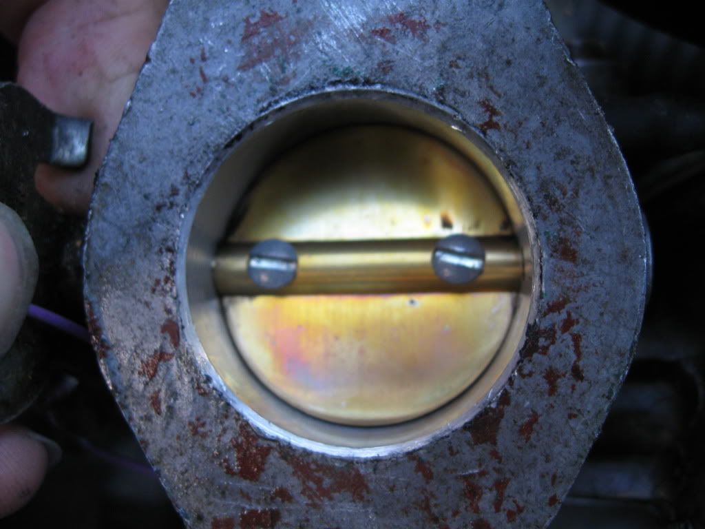

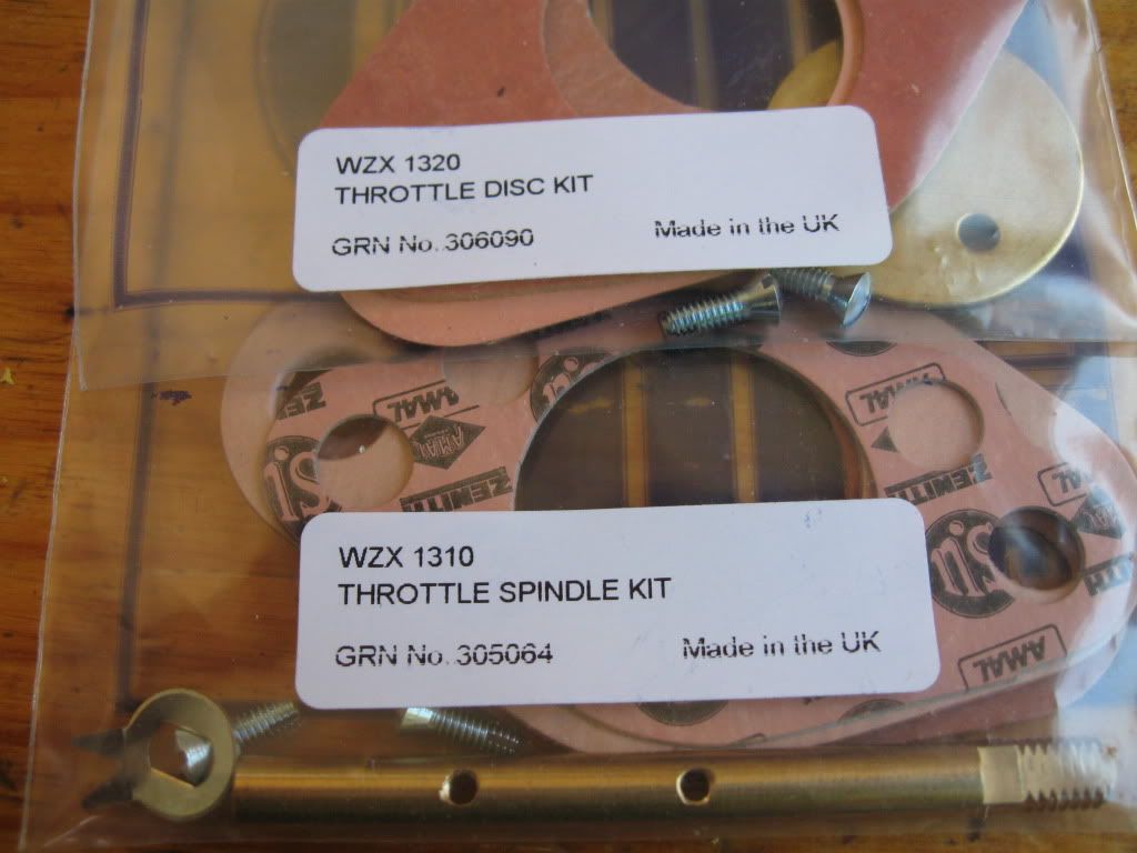

New throttle spindle and butterfly from Burlen Fuel Systems:-
Old and new throttle spindle and butterflies side by side:-
New throttle spindle and butterfly fitted to the carburetter:-

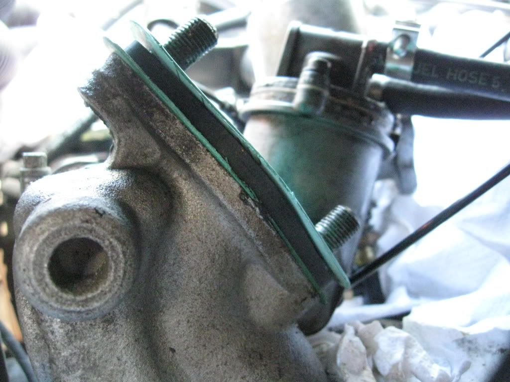

I also tried to fit Reliant's heater block insulator kit then realised that I could not refit the carburetter with it's nuts and lock washers as the studs were too short and I could not undo them.
I decided to refit the carburetter without the insulator kit using it's old carburetter base gasket as it did not appear to be damaged:-

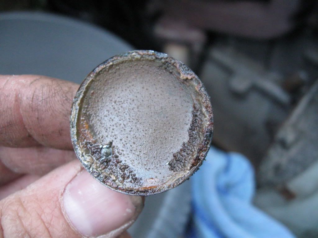

Old carburetter heater block core plug removed. There was practically no coolant within the heater block:-
Old core plug removed:-
New core plug fitted:-

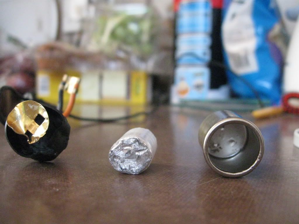

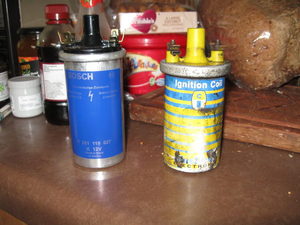

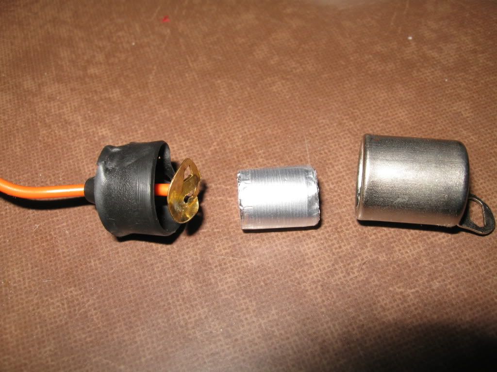

Finally, I replaced the condenser (I remembered that it was a QH XCON85 condenser, not an Intermotor one as previously thought). The old QH condenser had started to fall to bits inside (I felt something loose inside the capacitor's can as soon as I moved the orange lead). I decided to replaced it with a Lucas condenser instead.
I then started the car and it's hot starting problems have almost disappeared. I plan to drive it later on to see if my Rialto 2 will run properly and it if does, then I'll be taking it to the National Rally.

that sounds like a result,its easy to mistake hot starting problems as being fuel evaporation,could easily be the condensor,let us know what happens

I'll prise off the rubber cable grommet from the old QH condenser to see what actually happened.
PostSubject: Re: 1985 Lap Rialto 2 (hopefully a more concise version of it) - this may take me time to update it.   Sun Oct 28, 2012 7:59 pm
26th May 2012
I have just taken the old QH condenser apart and it seems not to be held together by anything !!
It consists of a copper contact, where a polyester roll rests onto it (rattling loosely inside the capacitor can) and the other end of the polyester roll rests against the base of the capacitor's can. I was surprised that it worked at all, let alone lasted 9,000 miles !
I plan to try and get some old russian (military spec) PIO capacitors (as JPB suggested some time ago, I can't remember which thread) and fit one of those inside the condenser's old capacitor can.

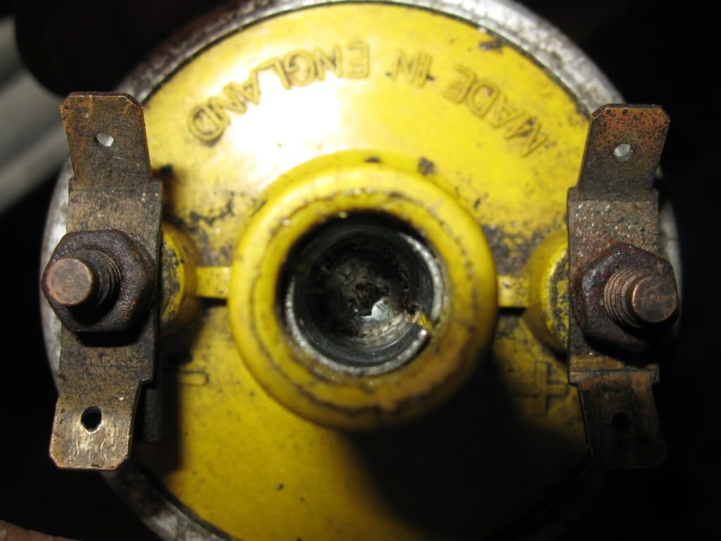

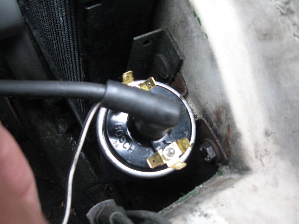

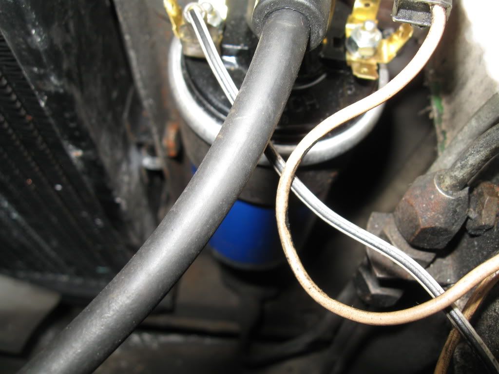

Another update (I knew it may have been too good to be true !):-

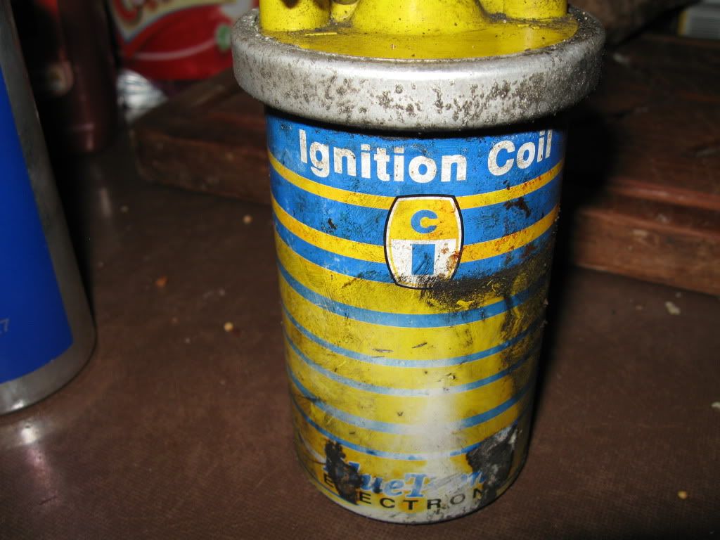

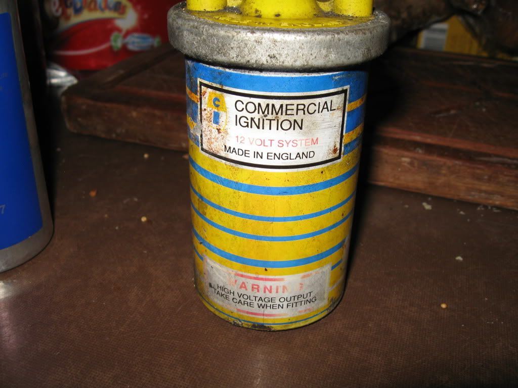

I had quickly started up my Rialto 2 this morning (to see if I had set the choke properly), but it decided not to run properly.
It would idle fine but would misfire like hell as soon as I try to rev it up.
I bought a Bosch (part number 0 221 119 027) blue 12V coil earlier today (thank you Fifer for posting the info from this thread http://www.zen13.com/index.php?threa...-2#post-419826) and a new Intermotor condenser. I'll be fitting those and bypassing the resistive wire later tonight/early tomorrow morning to see if my car will run properly again.
If I cannot get it to run properly tomorrow then I may end up taking my Rialto SE or my red VW 1600i Beetle to the National. To be honest, I would rather drive one of my Rialtos to the national.

Another update...
Hi everyone, I managed to swap out the ignition coil and ran in a new wire for the +12V coil feed today (I will change the condenser tomorrow morning as I ran out of light).
Old ignition coil:-
Old and new ignition coil side by side:-
New Bosch blue ignition coil installed in the car (this morning):-
I then ran a new white wire (just over an hour ago) for the +12V ignition coil feed. Whilst I was running the new wire towards the ignition switch, I then found out that the original ignition coil feed was fed from the accessories part of the ignition switch !! I quickly corrected this and wired the new ignition coil/starter motor solenoid wire to the ignition part of the ignition switch.
After I had installed the new wire, I tried starting the car just to see if the coil works. The coil its self works, but the car still misfires like hell when it's revved up, so it looks like that I will be replacing the condenser first thing tomorrow morning.
If I cannot get my Rialto 2 fixed in time, then I may take my Rialto SE to the National instead.

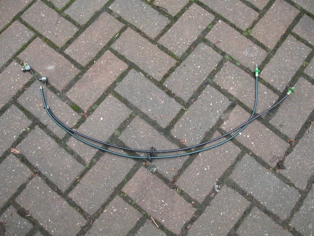

Hi everyone, a slight update on my Rialto 2. I decided to replace the carburetter for a rebuilt one I had bought from wheaters last year and fitted a Velleman ignition amplifier that I bought from Simon at the National Rally (I also had to deal with the passenger's window that decided to pop off it's window lifter).
Anyway, I'll let the pics do the talking....
NOS throttle cable and old throttle cable side by side (I decided to fit the NOS one as it fits properly):-
Rebuilt carburetter (that I bought from wheaters last year) along with a new choke cable trunion from Minispares) fitted:-
I also decided to refit my Rialto 2's original choke cable inner (solid cable) to the newer outer choke cable that is fitted to the car.
I then decided to fit a Velleman ignition amplifier kit (I bought one that Simon - Madblokey had built in a project box at the National Rally) as I am getting fed up with condensers being consumed like sweeties !!! The last one lasted about 300 miles and the previous one had only last about 10 miles !! I tried to install the Velleman kit as far away from heat as possible (secured by industrial strength velcro) within the engine bay (next to the washer bottle and heater) as I could not find any room behind the dashboard:-
I just hope that the Velleman kit's wiring won't chaffe against the solenoid. I think it should be ok as it has got heatshrink (acting as a tough outer jacket) over the wires.
I then managed to get my Rialto 2 to run properly again after setting up the rebuilt carburetter (I set it's mixture screw to about 23 turns out). I used Azzy's trick of tuning carburetters (eg. putting my hand over the airbox to ensure that it takes a while before the car tries to stall and setting the mixture screw to where the engine will run best) and it seems to work quite well.
