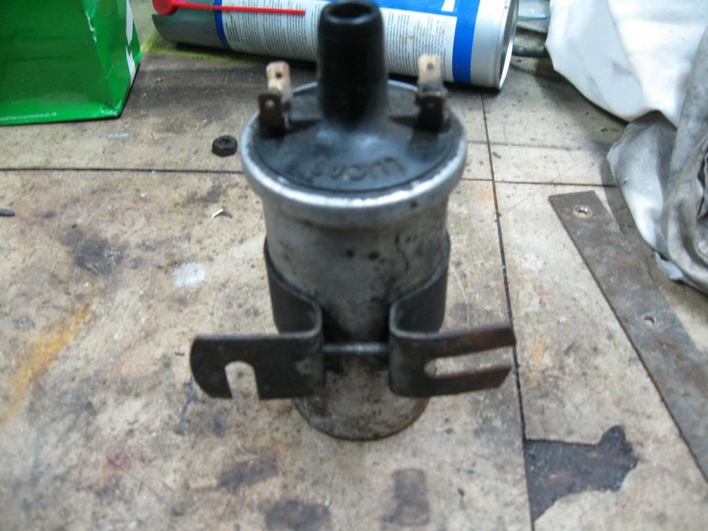

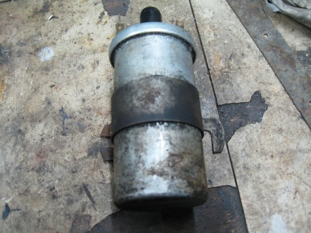

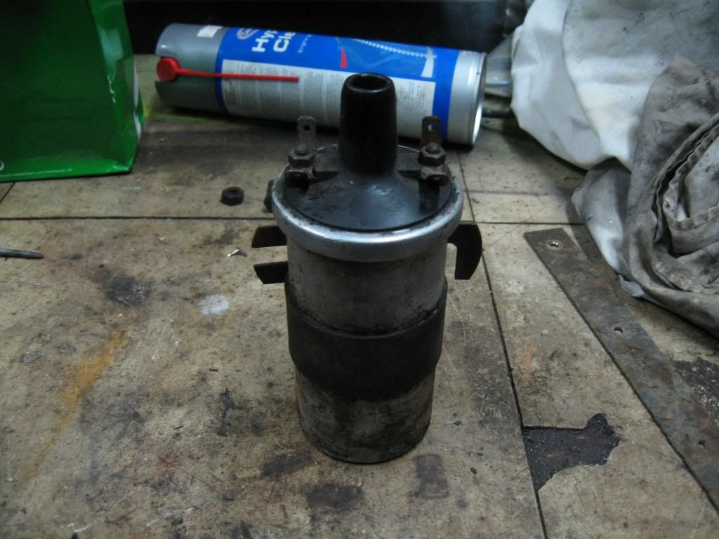

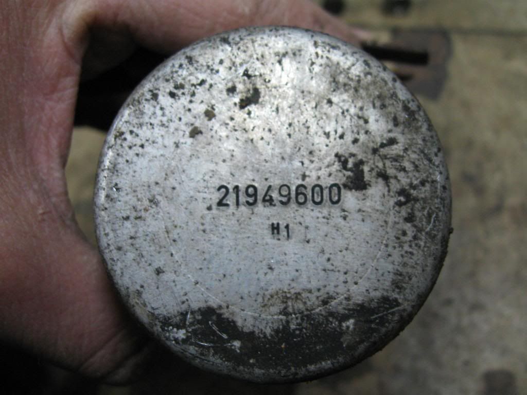

Old ignition coil (that was covered in oil, especially on it's base) that was well past it:-

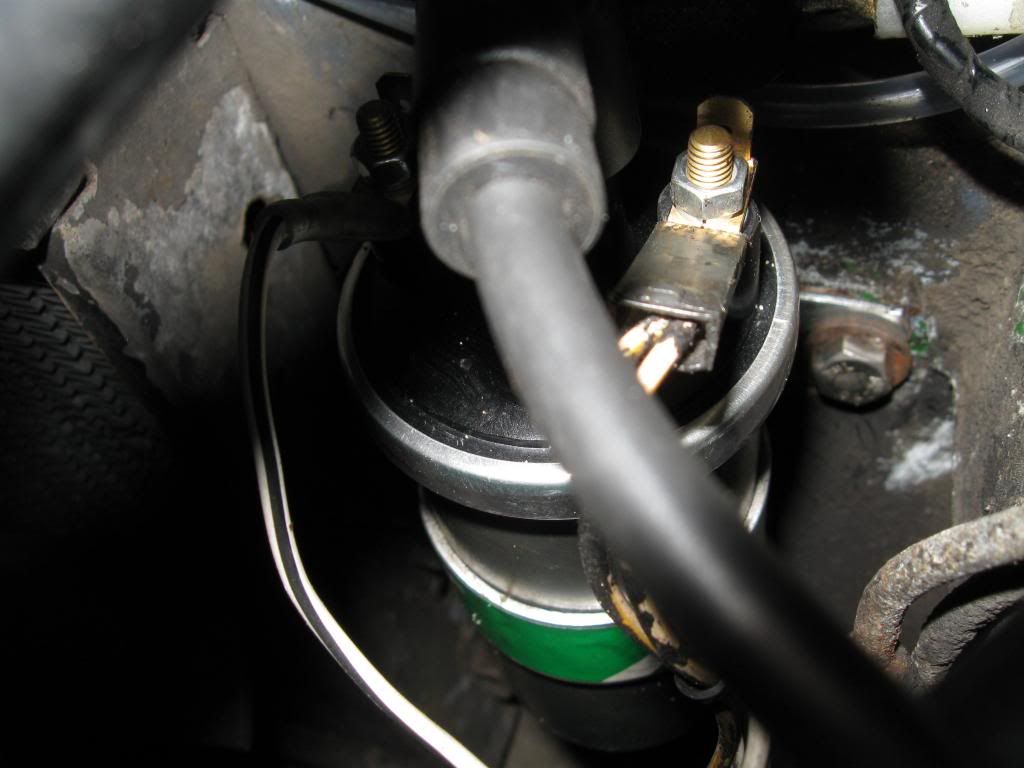

New Lucas DLB110 ballast sports ignition coil fitted:-
The difference between the two igniti0n coils was immediately obvious. The car started up straight away unlike it's old ignition coil.

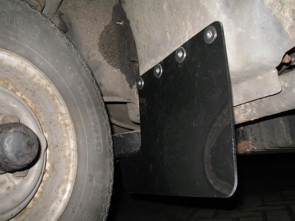

I also fitted a front mud flap to my Rialto SE as it didn't have one since I've owned it.
The remains of the front mud flap's mounting plate (there were no remains of the old mud flap):-
New mud flap (from AzzY) fitted:-
