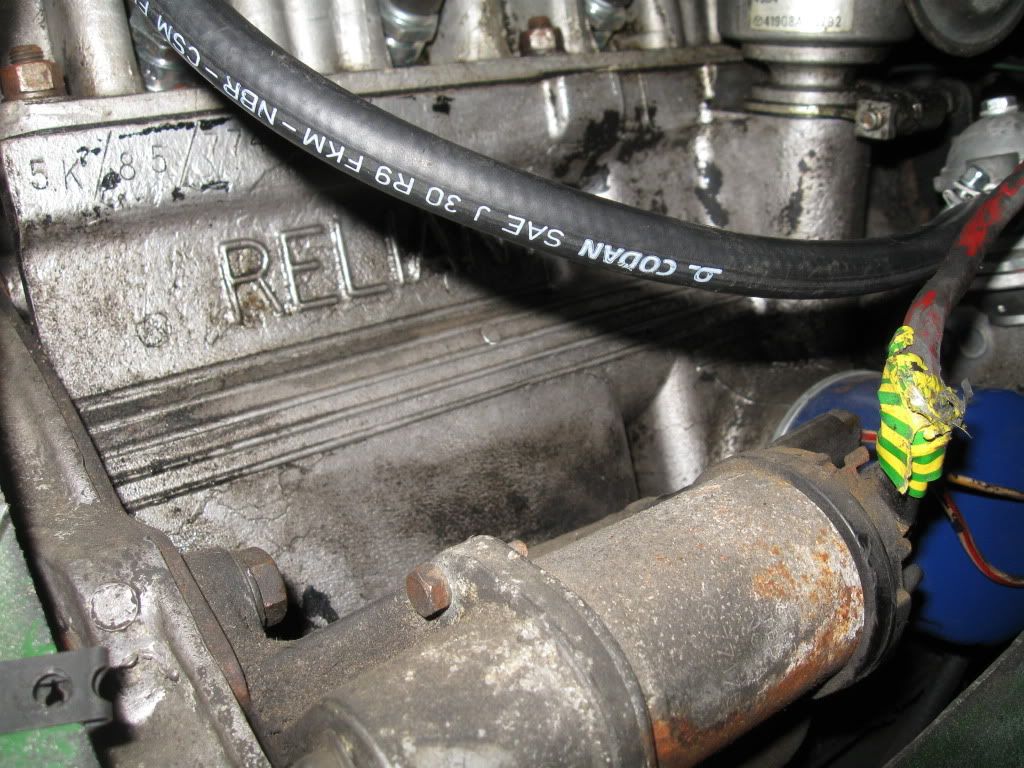

- Replaced fuel hoses (I could only get 1/4" SAE J30 R6 at the time) as the other ones had perished and were leaking

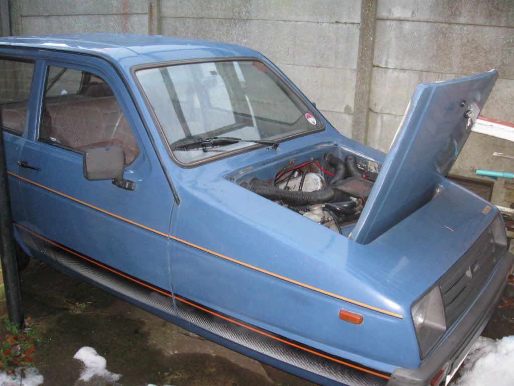

So I decided to get the car into the garage and started to work on it. Engine bay how it was before I started to work on it:-
More details are on this thread http://www.reliantworld.co.uk/forum/showthread.php?25117-My-Rialto-Mini-Engine-Rebuild-(hope-it-s-just-valves)-Starts&highlight=
That was a start of a learning process for me, not helped by the very cold weather at the time. I got it up and running again (I think) January/February 2011.

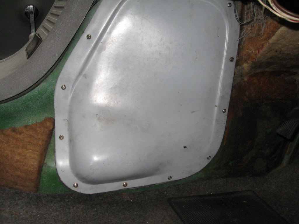

The interior afterwards. I had bought some carpet roll and trimmed the passenger's side foot well and rear foot well carpets (not shown in the pics) and removed the nasty looking stains from the rear bench seat and boot carpet (not shown in the pics):-

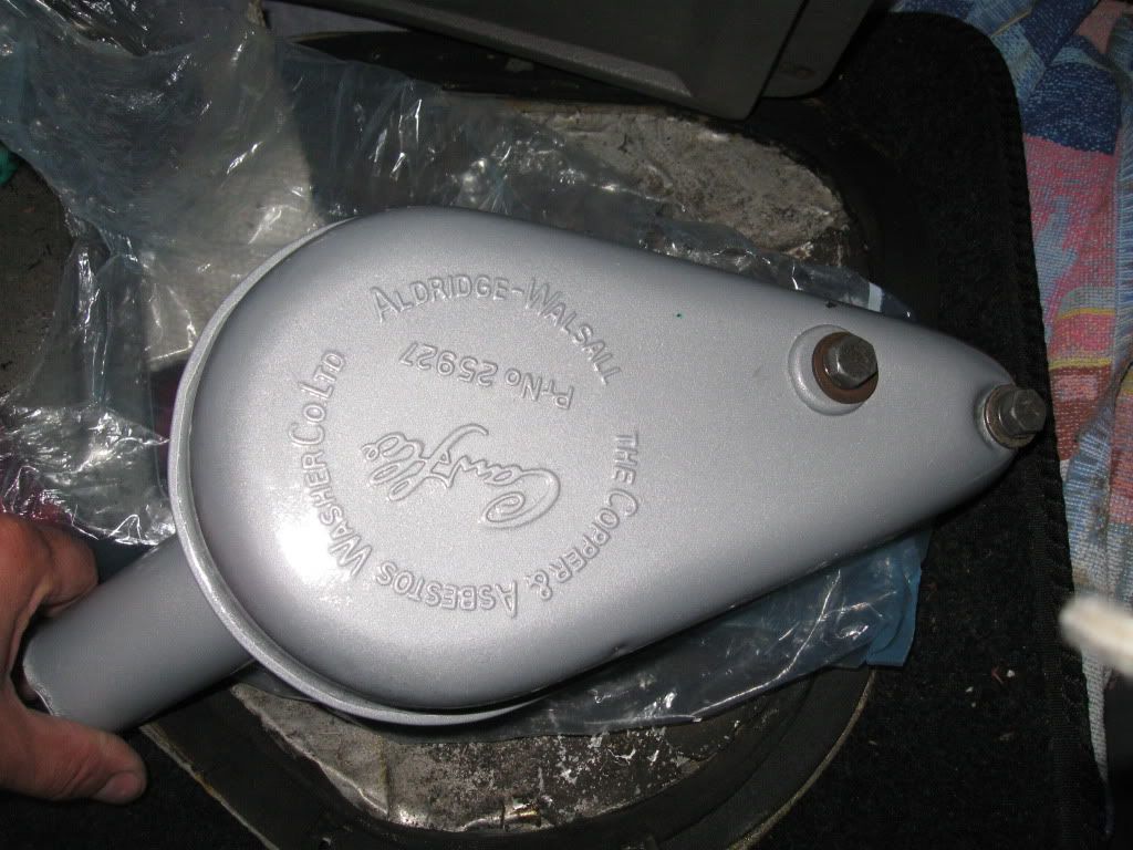

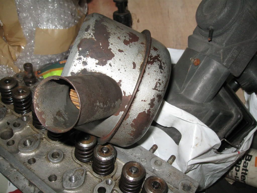

Tatty air filter that was fitted to the car:-
....replaced with this one:-

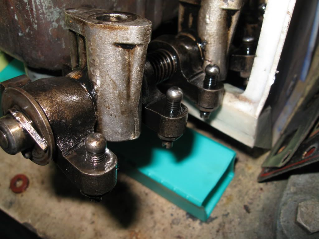

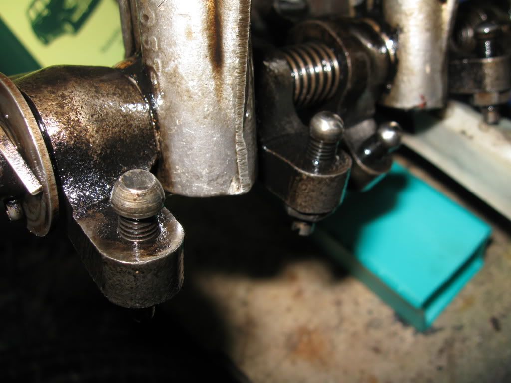

750 tappet adjusted fitted to the rocker shaft (the original 850 broke and I could only get a 750 one at the time):-
....replaced with the correct 850 tappet adjuster:-

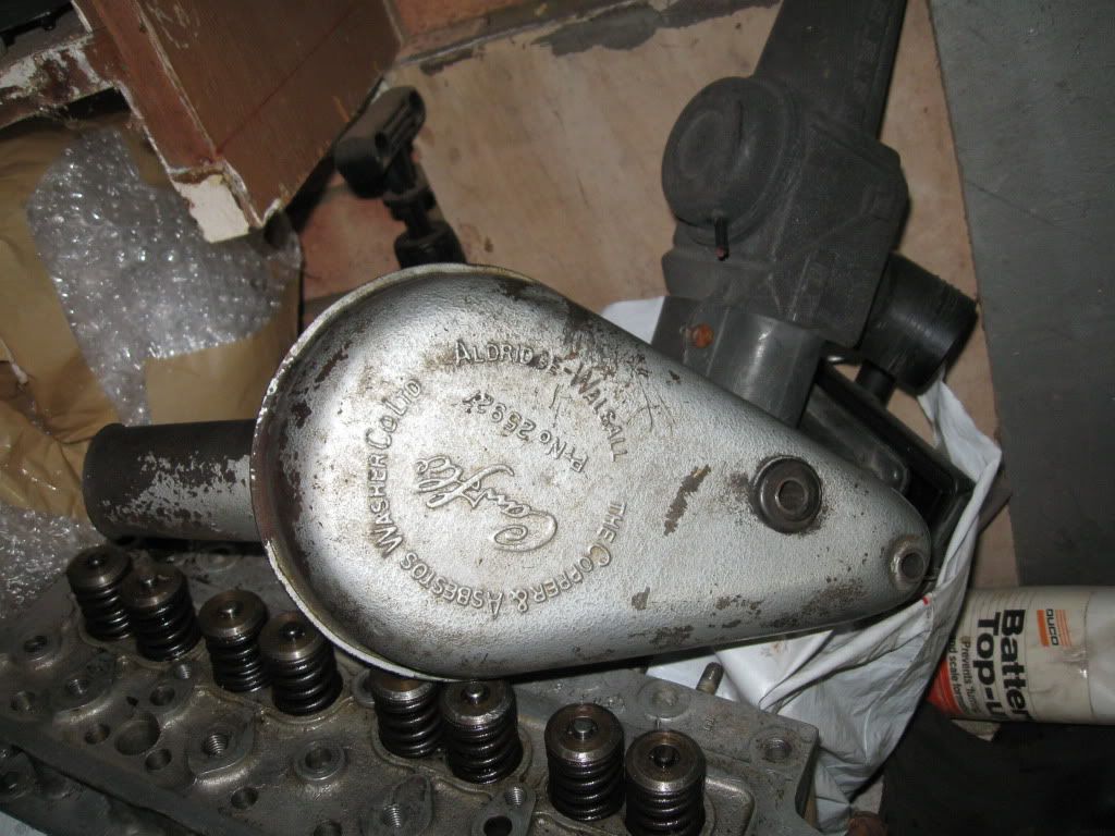

Rocker cover as it was (no nasty sludge in here Smile ):-
PostSubject: Re: 1989 Rialto SE Hatch - my very first Reliant (and I've still got it)   Mon Nov 05, 2012 8:06 am

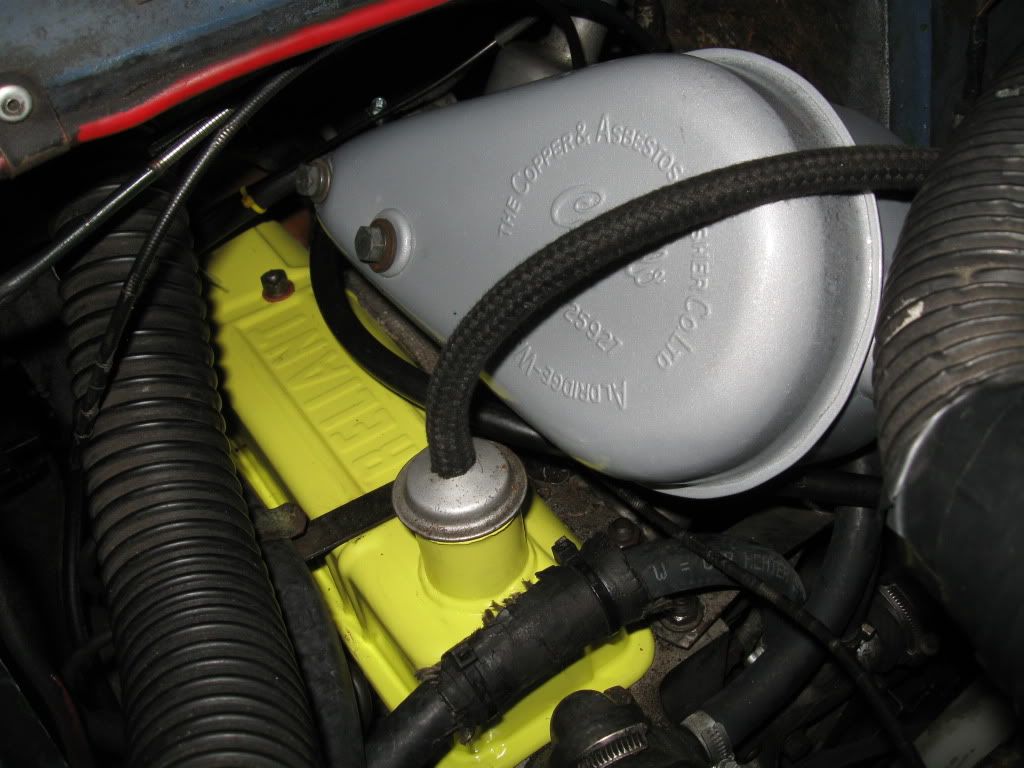

Rocker cover being painted yellow as my Rialto SE has got a yellow top engine (it took me a few days to get it right):-
PostSubject: Re: 1989 Rialto SE Hatch - my very first Reliant (and I've still got it)   Mon Nov 05, 2012 8:09 am
Rocker cover refitted...

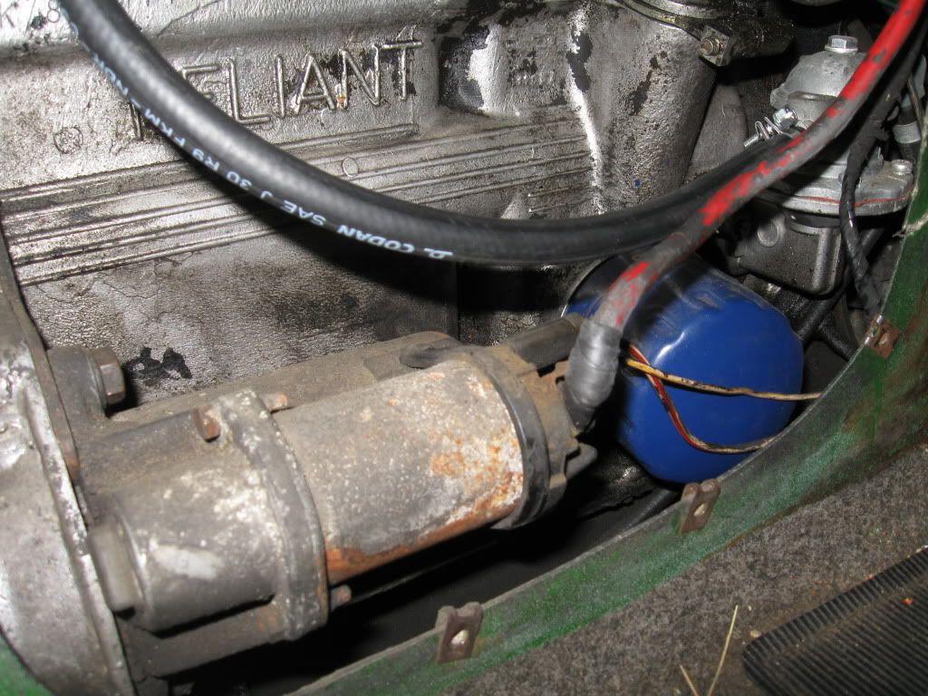

Starter motor's battery live terminal as it was:-
....and insulated with self-amalgamating tape:-

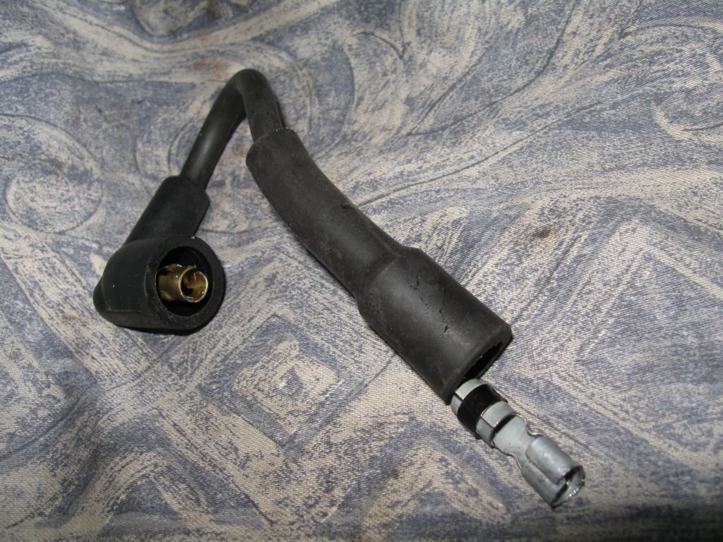

PostSubject: New (home made) HT leads that I decided to fit to my Rialto SE today...   Sun Jan 27, 2013 6:05 am

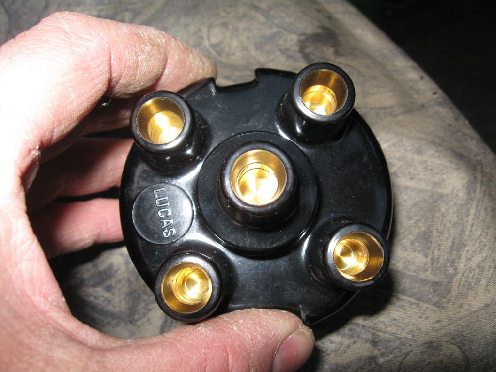

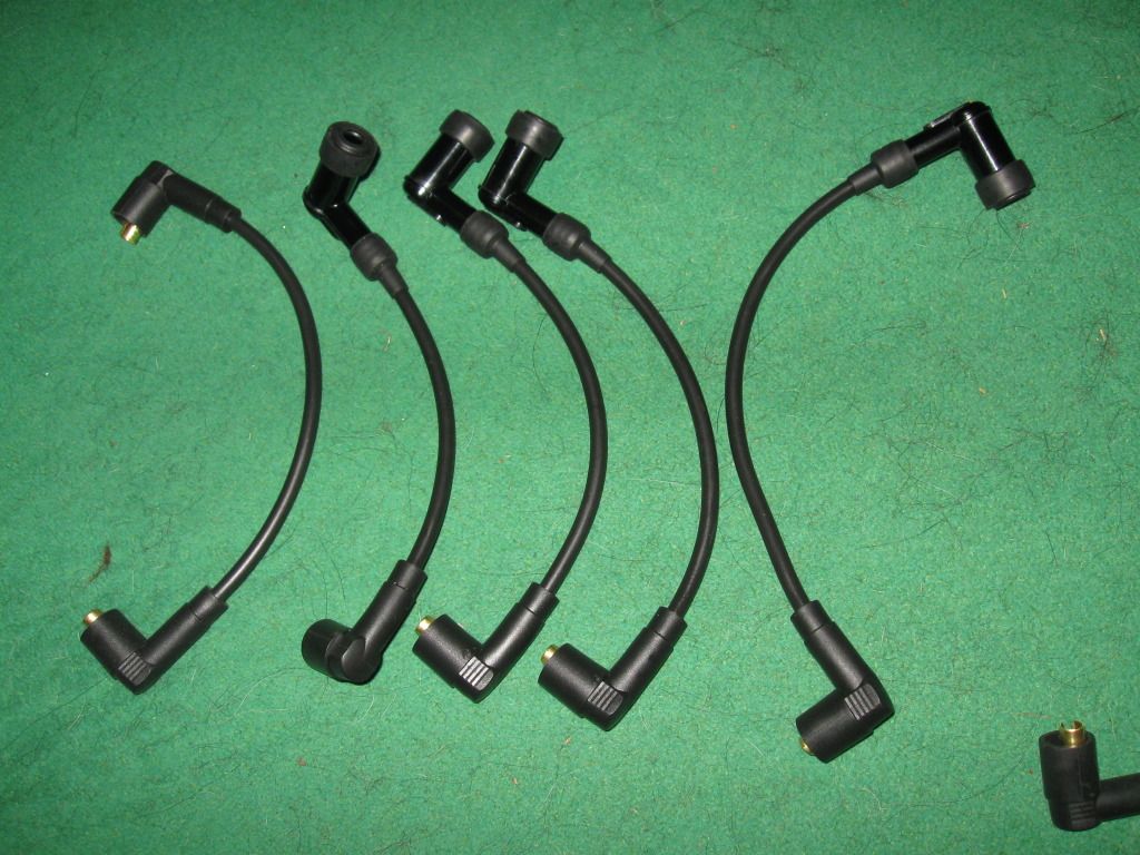

I thought I would update my Rialto SE thread and have decided to make up my own HT leads today. I'll let the pics do the talking...

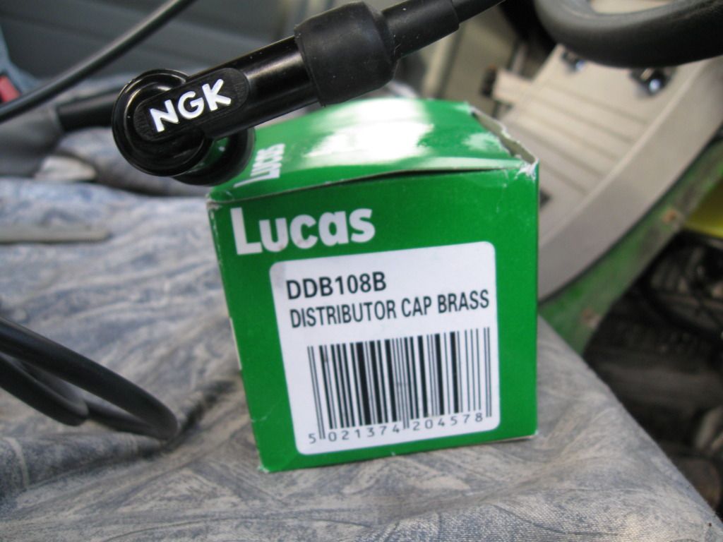

New Lucas DDB108B distributor cap (with brass contacts) from AES:-
Old Intermotor aluminium distributor cap that was fitted to my Rialto SE:-

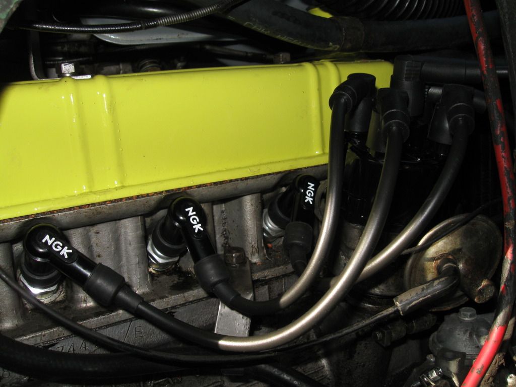

This is the main reason why I wanted to make up my own HT leads. The number 1 spark plug end always falls off when removing the HT lead from the spark plug (despite recrimping it):-

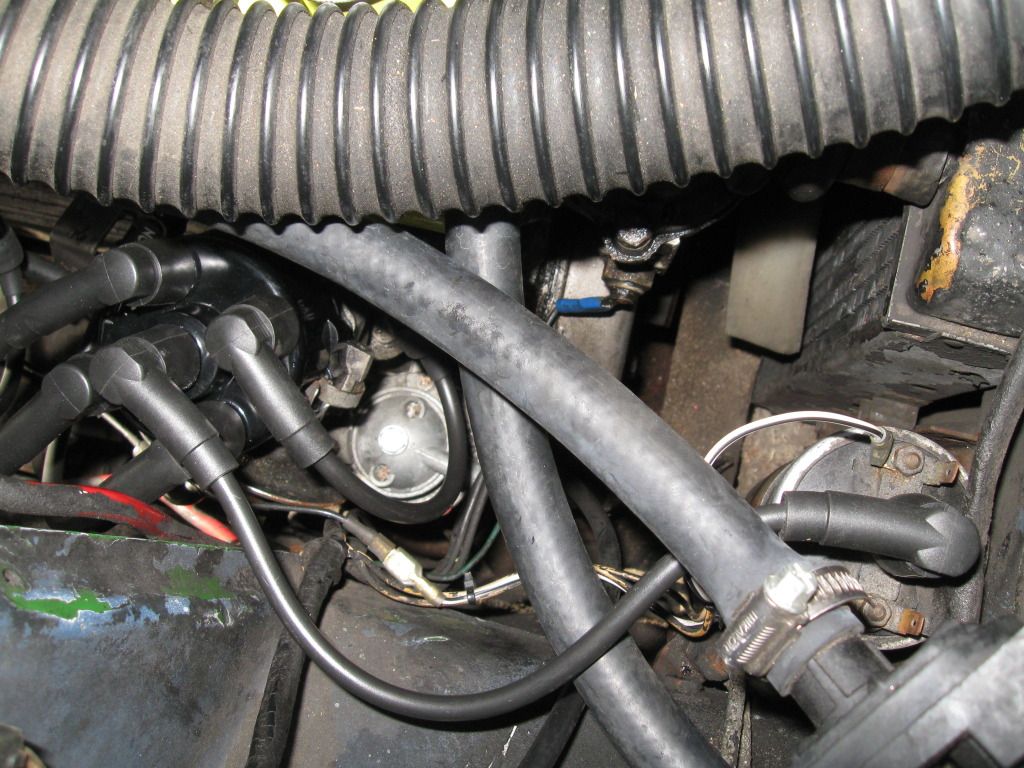

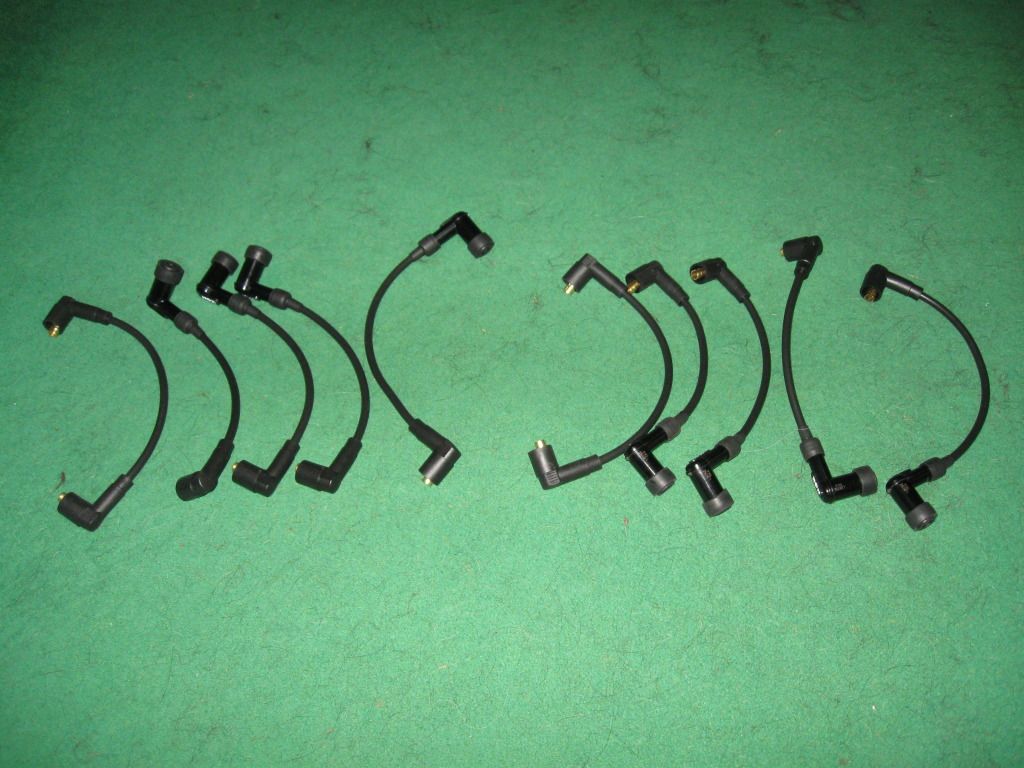

Both sets of HT leads made up for both of my Rialtos:-
Both sets closer up:-
New HT leads fitted to my Rialto SE:-

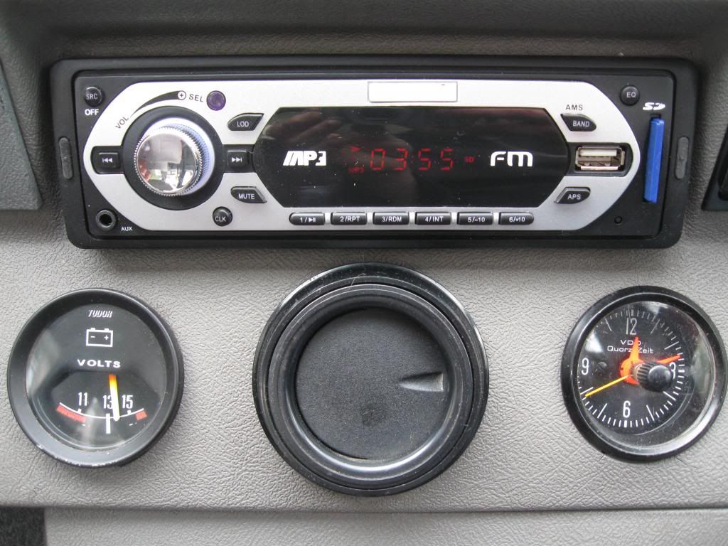

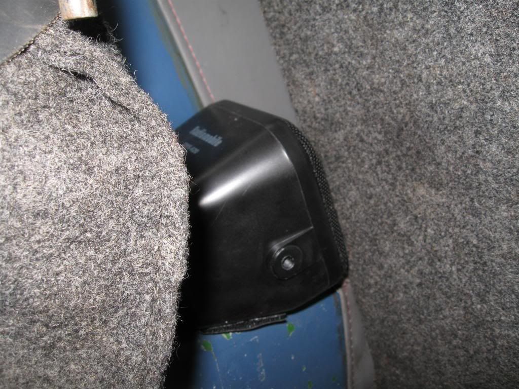

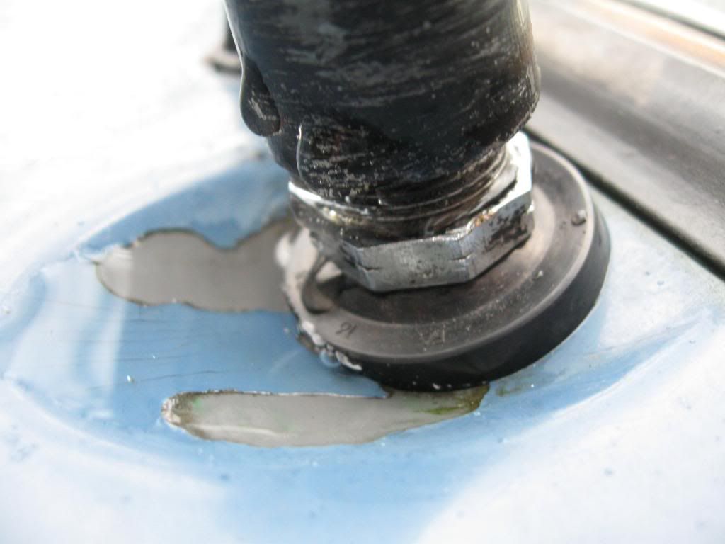

PostSubject: Replaced washer jet, fitted new radio and speakers   Sun Apr 28, 2013 12:27 am
A quick minor update. I have replaced the washer jet after I broke the old one after I unblocked it with compressed air and refitted my Rialto's new radio. I also used RTV silicone sealer to stop the windscreen wiper's wheel box and washer jet from leaking water into the car. Anyway, I'll let the pics do the talking.
New twin washer jet from Car Builder Solutions:-
New (£25 unbranded) radio from Amazon:-

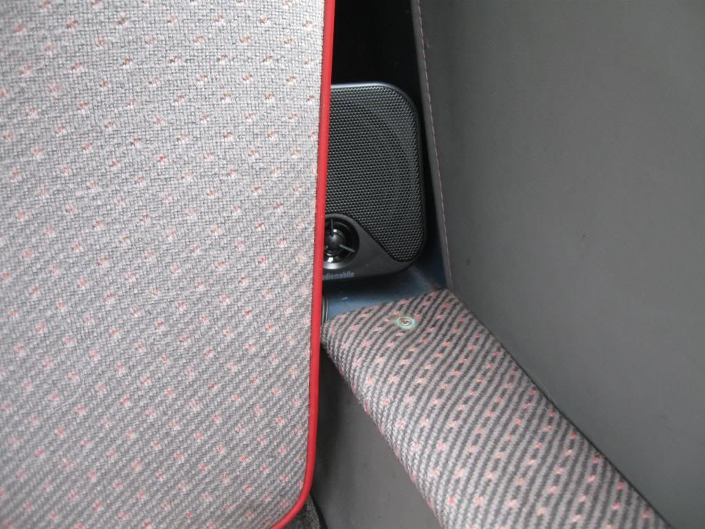

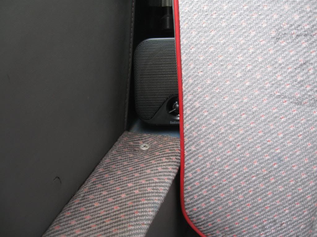

New Roadmobile RMS620 speakers (that replaced the Roadmobile RMS630 ones as they took up too much boot space):-

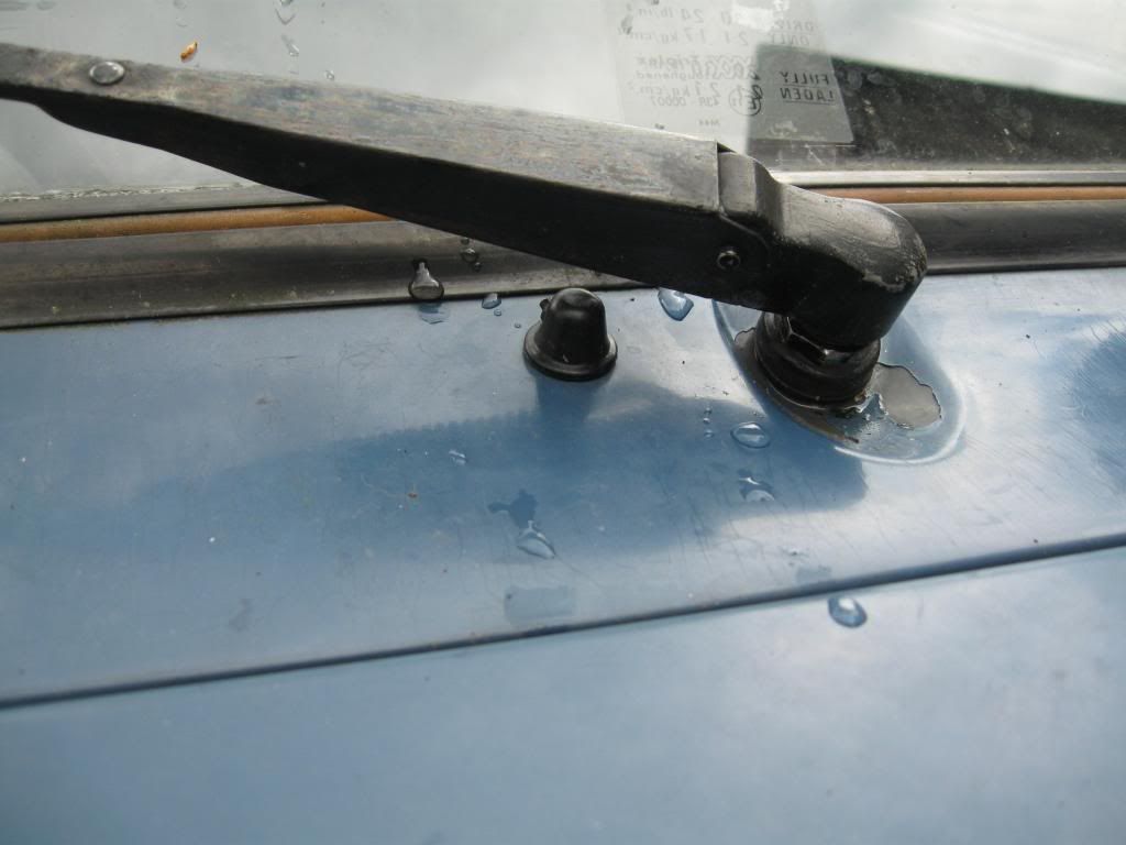

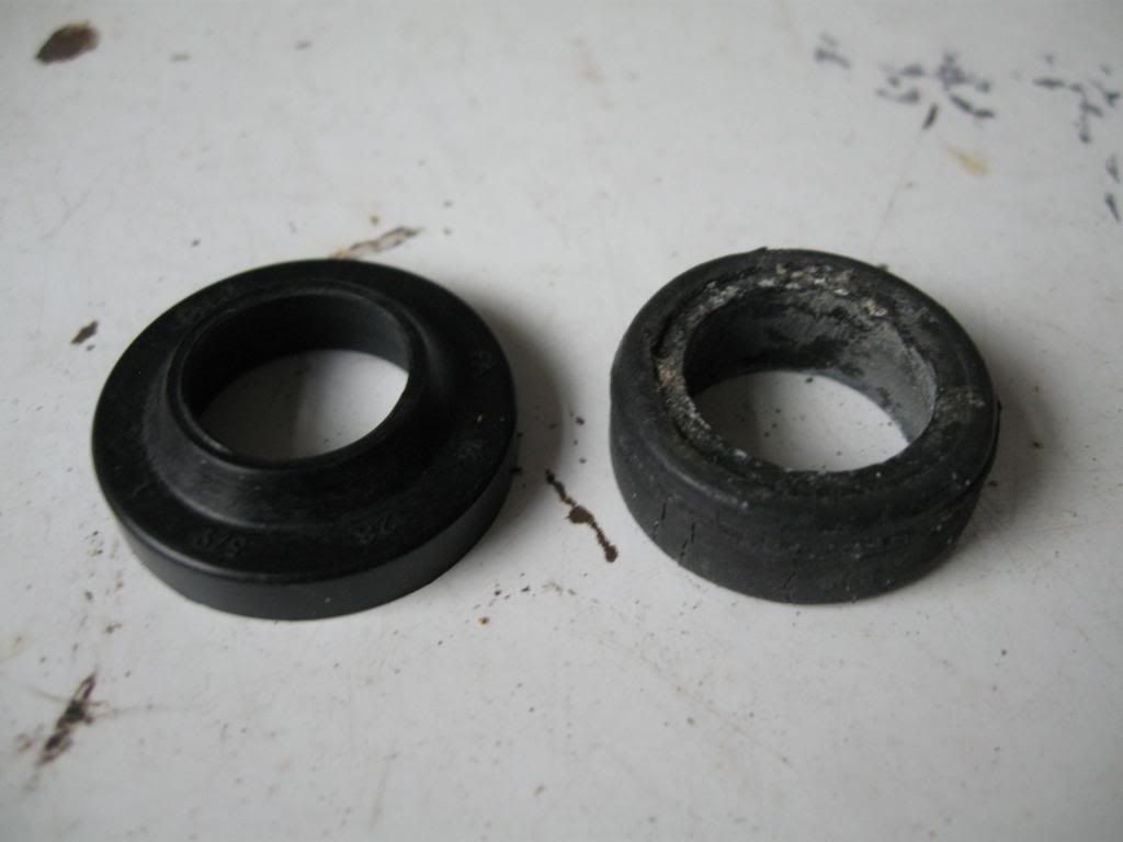

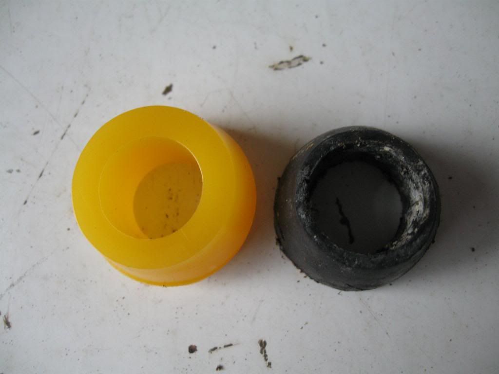

Fitted new wiper spindle bushes (yesterday)

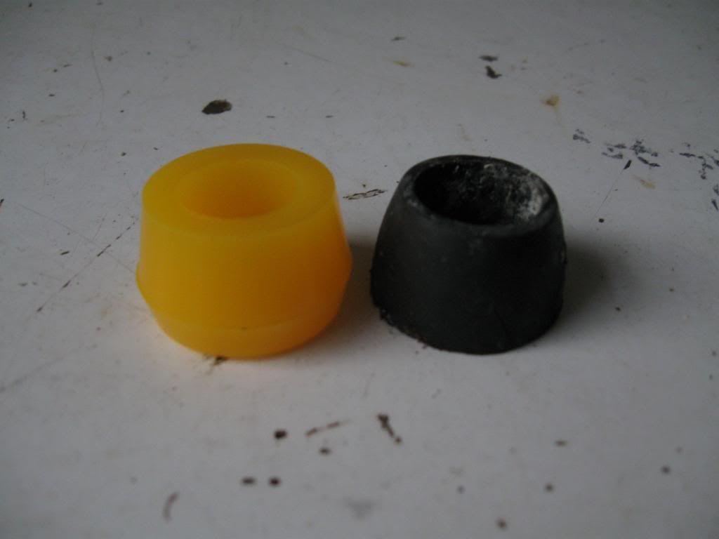

Old outer wiper spindle bush and new PU seal to replace it (left hand side of photo):-
Old inner wiper spindle bush and new hard rubber suspension bush (yellow) to replace it:-

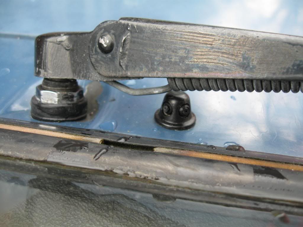

Outer wiper spindle bush fitted to the car (I've also fitted the inner one, but that's hidden from view):-
I also freed up it's wiper wheel box with DP60 (penetrating lubricant) and spray grease as it was full of muck.
PostSubject: Re: 1989 Rialto SE Hatch - my very first Reliant (and I've still got it)   Sat Jan 11, 2014 5:41 am
Update:
It appears that there is still a minor leak on the wiper spindle. Sad I guess the next thing to try is a 16mm O ring between the two wiper spindle bushes to see if that leak will stop.
