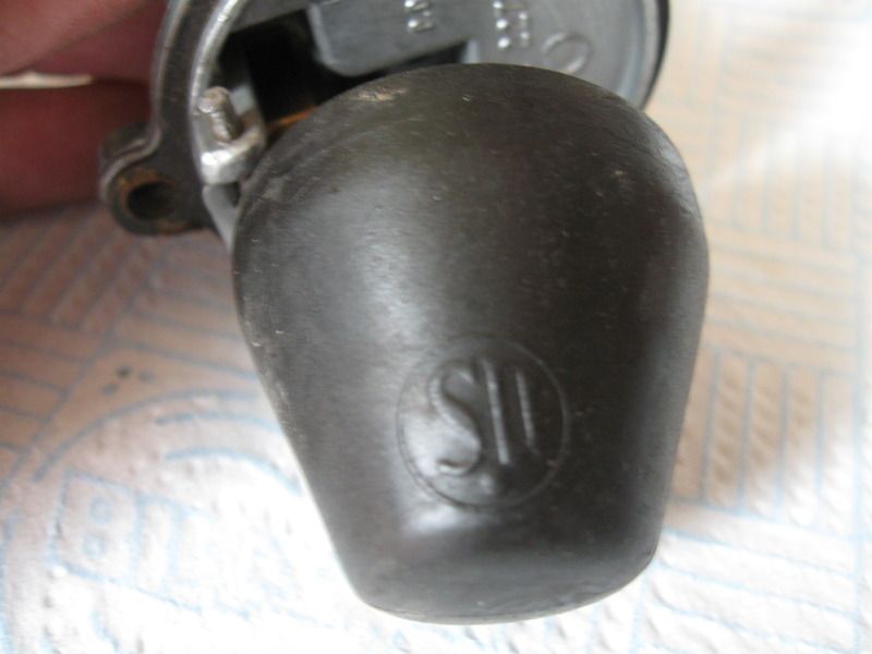

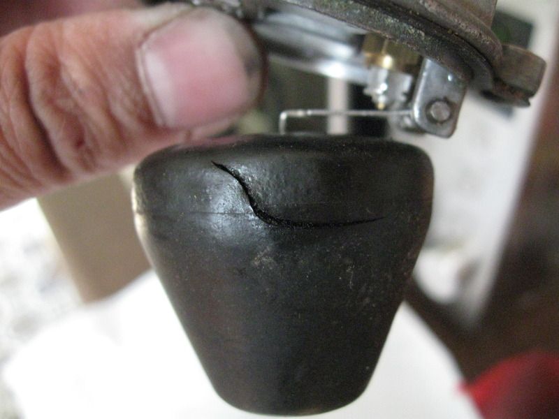

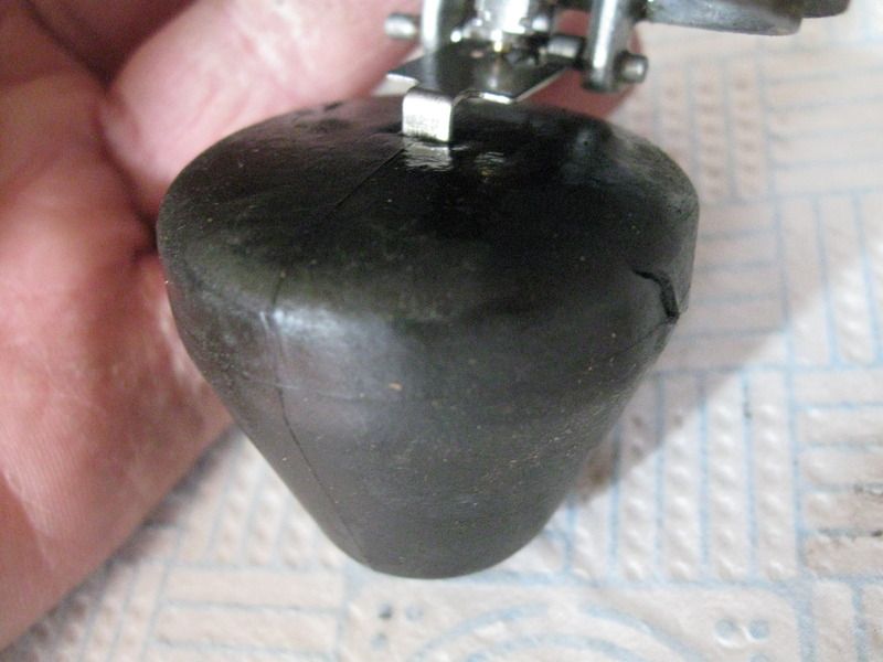

I thought I would post what I found on my 1989 blue Reliant Rialto SE today's HS StayUp Float. The float itself is barely 5 years old and it has failed completely, causing the entire overflow system to be full of fuel.
If you have fitted an SU HS StayUp float and you haven't used your Reliant very often then please check the condition of it !!! Failing to do so could cause a vehicle fire !

I wonder if it is the dreaded ethanol in the fuel which has caused the damage ?
